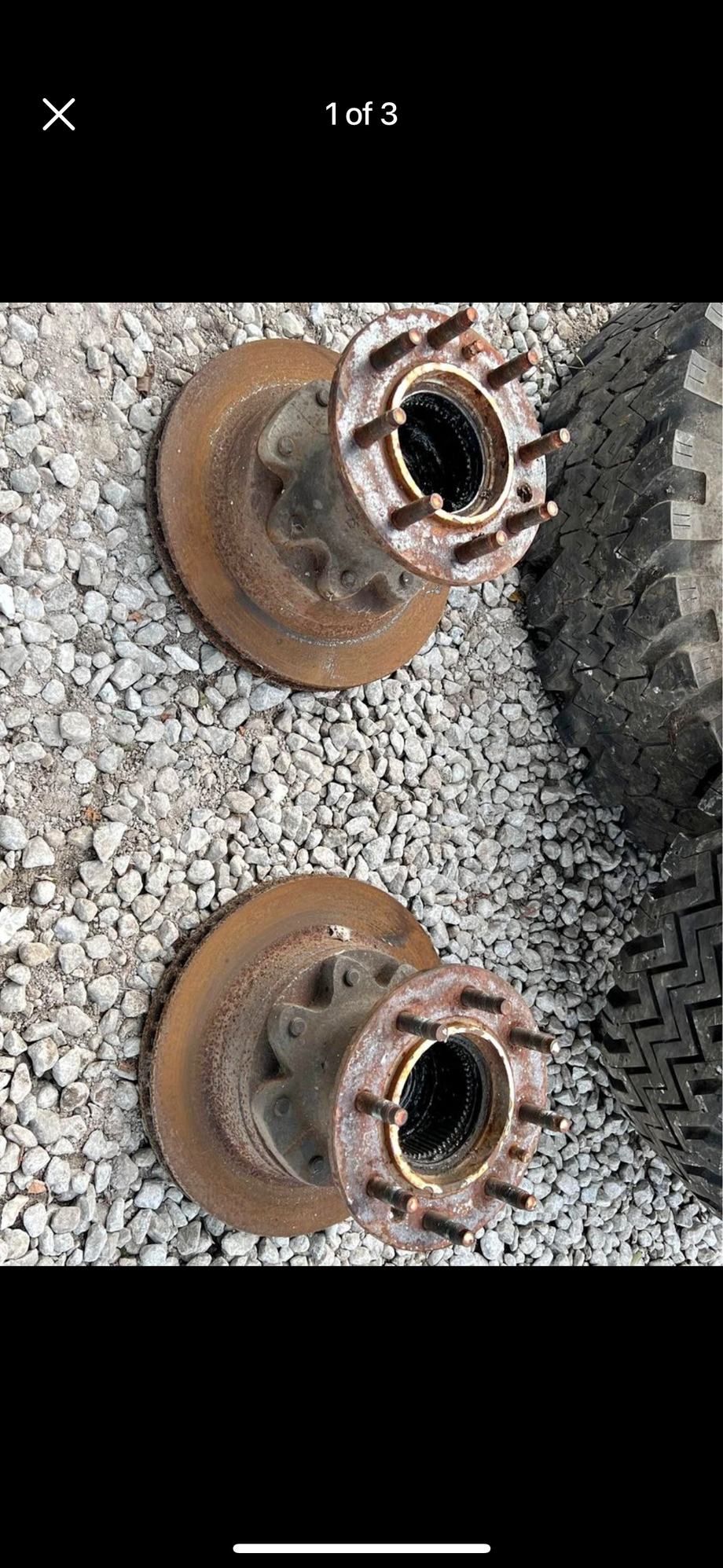

Front Dually adapters will these work?
Guy says they’re off a 1992 F350 will they work on my 1997? I think most I’ve seen bolt onto the existing Dana 60 hub, these look like they replace the hub?

will need to swap to 97 rotors but yes the hubs are correct
you think these must have come off a super duty that was factory 4x4 and drw at some point? I haven’t seen this type before but I need a set lol

they are the factory hub used on all cab and chassis 4x4 f350 97 and older i have the same set in my shop only reason i said to swap rotors is because the rotor got .5" bigger in 95

if they were F-SuperDuty they would be 10 lug.
good call, forgot about that part
