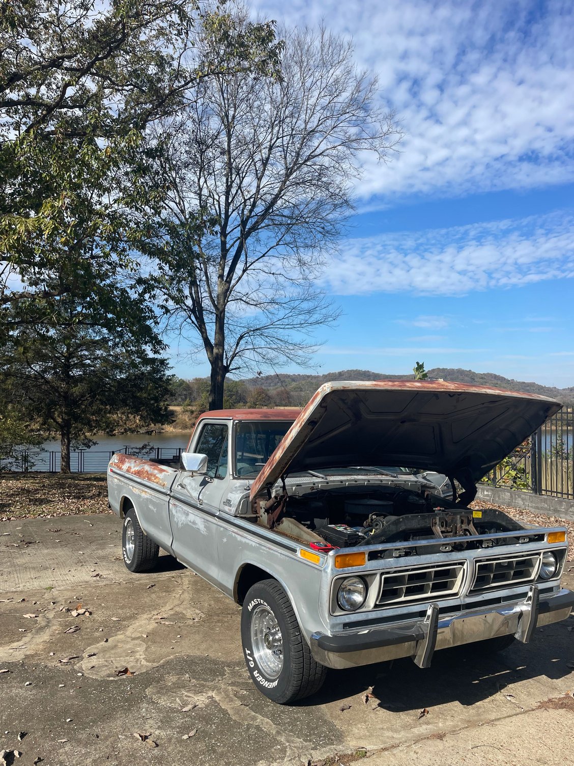

I purchased my 77 F100 Custom Explorer a few weeks ago. All stock, 400/C6. The guy I bought it from had replaced much of the steering and suspension, wheel bearings etc. While at highway speeds today it suddenly veered hard to the right. Followed by that was a some vibration and noise. It became sluggish to accelerate and acted like it wanted to die. Was able to get it home and immediately began to drip right at what I’d imagine is the front seal. It has stopped. Don’t have a trans cooler; will need to get that taken care of. It also doesn’t have a fan shroud and was very close to overheating. I’m very new to this, I know very little. Any help would be greatly appreciated. Will have to inspect more tomorrow in the daylight but everything else looks intact underneath.
