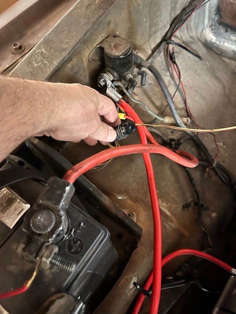

With the help of a friend, we figured out that it was an ignition issue. Some part of the old wire harness played a role in the coil pushing spark to start the engine. My friend recommended I find a source that has power when the key in on and run it the positive of the ignition coil. The photos show the work. Another friend of mine also mentioned that I need to be careful how I run the power wire to the coil on a point system. He said it has full power in start position mode, and it goes to a ballast in run mode, so I don't burn up my points. Can anyone tell me from the pics if I run the risk with this setup? Once I did this the truck fired right up. The new alt is pushing 14.ish volts while running, so I'm all set there... I just need to know if this wire setup will work, or do I risk burning up my points? Thank for the advice everyone! I appreciate it!

Without a ballast resistor of some sort in the hot lead to the coil in "run" mode, you do stand the risk of burning up the points. Fords use resistor wire from the ignition switch to the coil, which is temporarily bypassed when they switch is in "start" mode. GM and Mopar use physical ballast resistors in the line.

Your friend is mistaken. The condenser is there to maintain the average voltage level which changes due to the opening and closing of the points. You must have some kind of ballast resistance in the circuit. In our trucks, Ford used resistance wire from the ignition switch to the coil.
Instead of applying a haywired Band-Aid to the problem, I highly recommend that you troubleshoot and correct the problem. Do you have the electrical diagrams for your truck? You will need them to troubleshoot. I have them but in electronic form. I may be able to snag screen captures and send them to you. If you're not capable of diagnosing electrical problems (and don't be ashamed because there's nothing wrong with that!) then you probably need to find a competent mechanic to do it. But first, let's see what the FTE Brain Trust can do to help. It would be helpful to know exactly what the symptoms are, what measurements you took, what connections you checked, and so on. We should be able to help narrow down the problem, which will make it easier to correct.
Have you considered replacing the points and condenser with a Pertronix Ignitor? I have them in my '73 F100 (360-2V) and my '72 Mustang. Some minor additional wiring and parts will be required, but we can help with that.

I went back and did some research in my maintenance manual. I found the wire that contained the resistor wire... the big pink wire. That's the one I connected to. I volt tested at the positive terminal on the coil with key on... it read 6.3V. I then had a friend fire up the motor. The volts jumped to 11ish and then came right back down to around 6. From what I read this is how things are meant to operate, so I think I may have just gotten lucky with the wire I chose to connect to?
