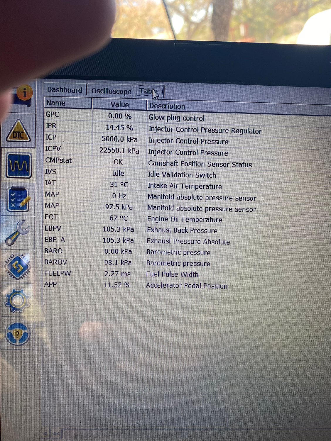

This is after I got it to idle good I just realized that you probably needed it while it was in the problem sorry

Actually the best method is to save the file. Then you can load it here and we can go over it line by line, or when you get really fancy there is a charting tool up in the stickies section that is free to download. You can load the file in the program and it converts the spreadsheet data in to a linear graph that is pretty snazzy. This is fine for now though. I'm guessing you have a problem with the ICP sensor or it's wiring. Those numbers it's reporting in your pic. They are the default pressures the PCM uses when it's not getting anything from the sensor or it decides the sensor is wrong and disregards it. You can try unhooking the sensor and try starting it. That will take it out of the equation and the PCM won't be struggling through bad data.
I second this.
My first thought was a bad IPR but after seeing your screenshot it seems the ICP may be bad. It needs addressed first and may correct the issue.
