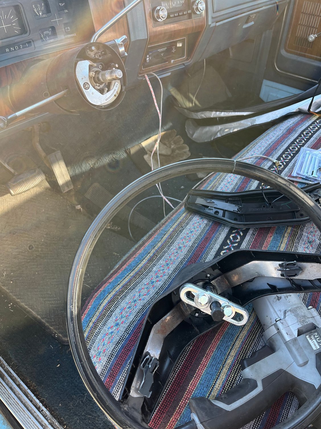

So to keep my word, here is the teardown and install pictures. Biggest hassle was the instructions for the horn were basically useless but once I figured it out it works fine. The copper plate tab for the horn broke off immediately but was pretty easy to solder back on.
Only real downside I've ran into so far is that now the wheel is in my line of sight for the speedometer. Otherwise it's working really well.
OG wheel
Removal with $20 wheel puller
Base install complete, put grease on the adapter plate copper parts.
The horn plates look like they can go on after the shoulder bolts, they can't.
Final install, everything is solid and works.
The size difference between the wheels.
