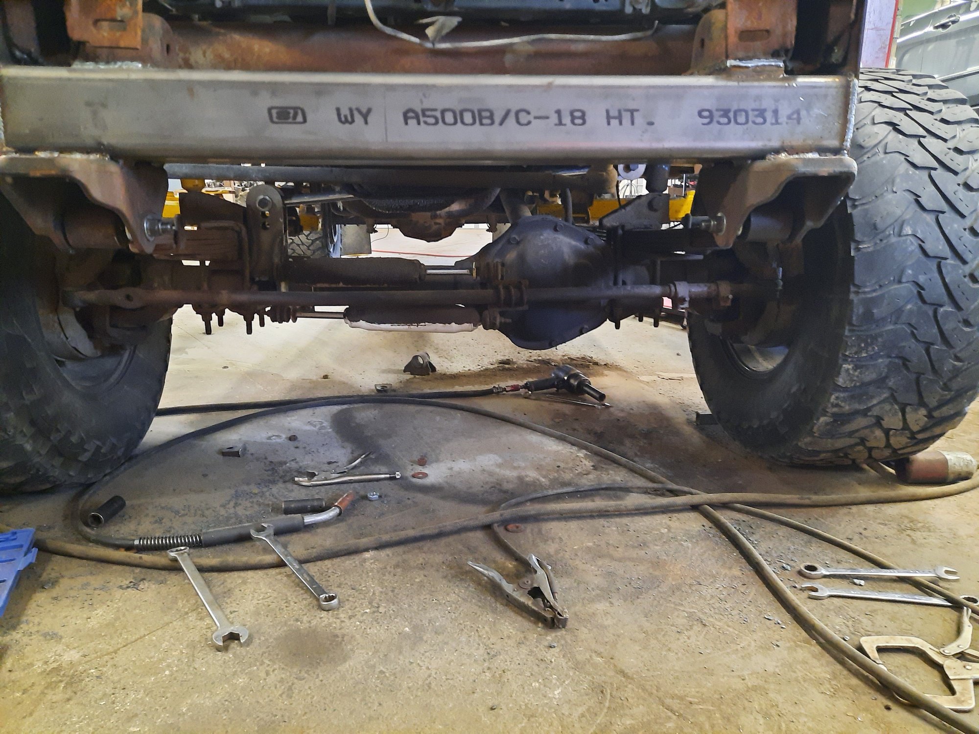

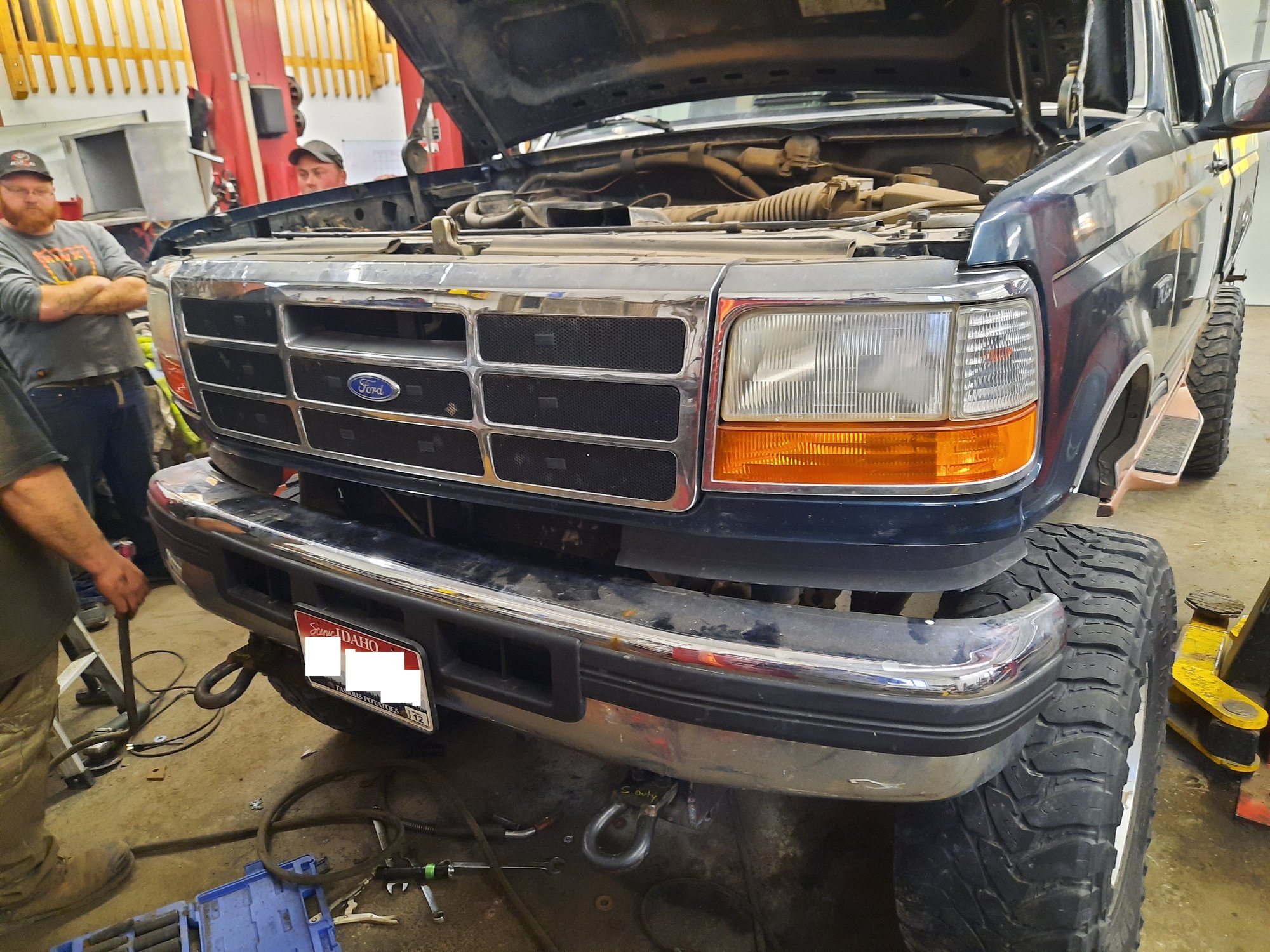

Hi looking to soild axel swap my truck(1992 f150 ttb) away from the ttb axel. Local junk yard has a truck with one in it. Can anyone help me know what all I need to grab out of it to make the swap work. any help is much appreciated.

axle, driveshaft, all steering linkage, possible the pitman arm.

also the older straight axle radius arm brackets. The ttb brackets locate the axle too far forward.
Having done this myself multiple times, what makes you want to do this swap?
edit: and at least a 4 inch lift kit or you have to trim/hack a good amount of engine crossmember to clear the diff. And no long tubes for the newer frame, you habe to use shorties or manifolds.

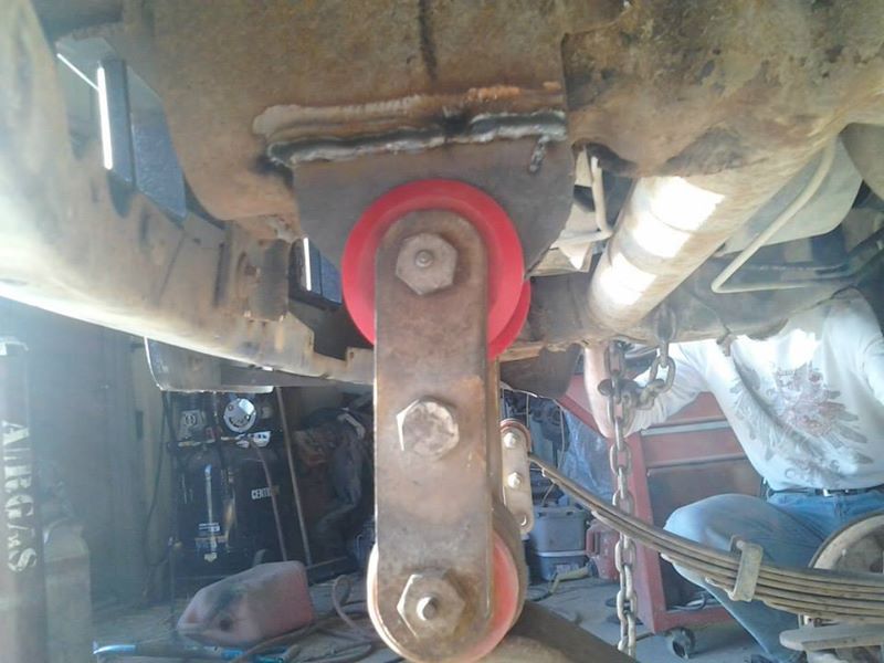

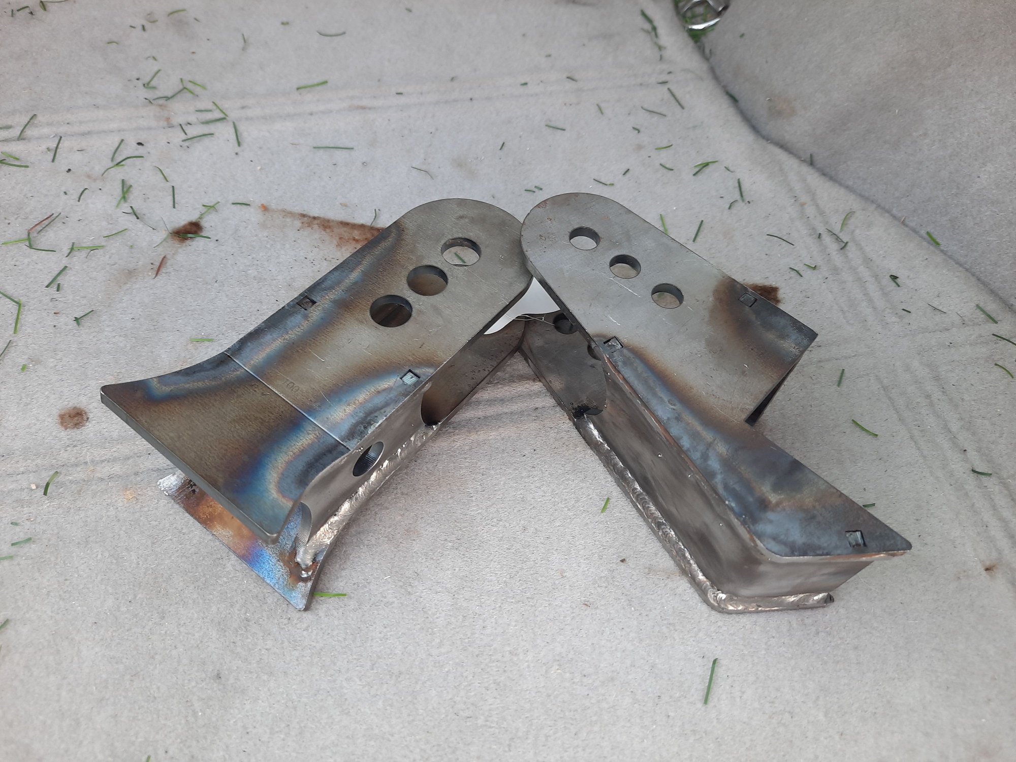

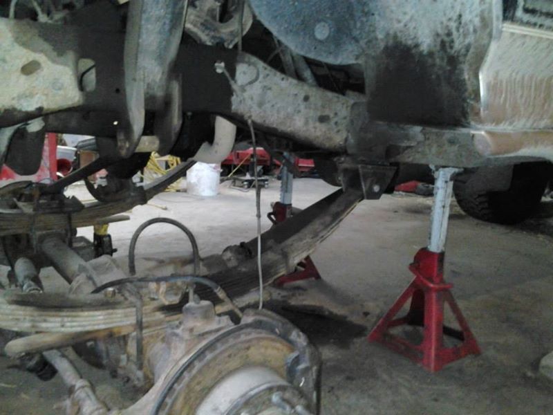

A few years ago, some friends and I did a Dana 60 swap on my '95 F-150.
Later, another friend suggested redesigning the front suspension because the front leaf springs were bottoming out.

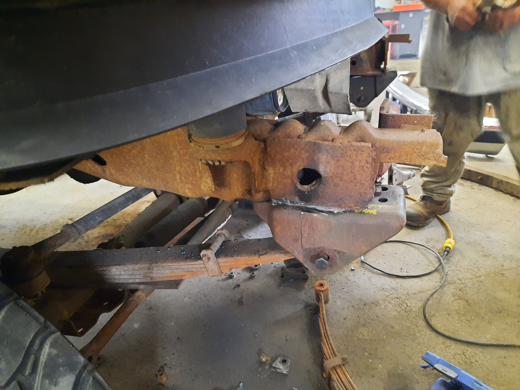

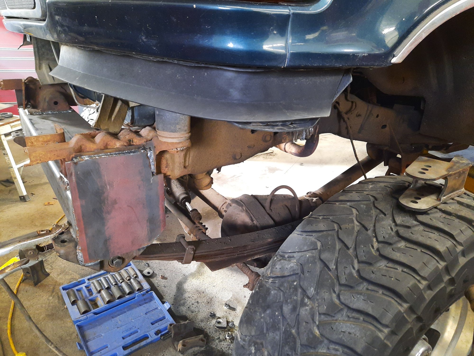

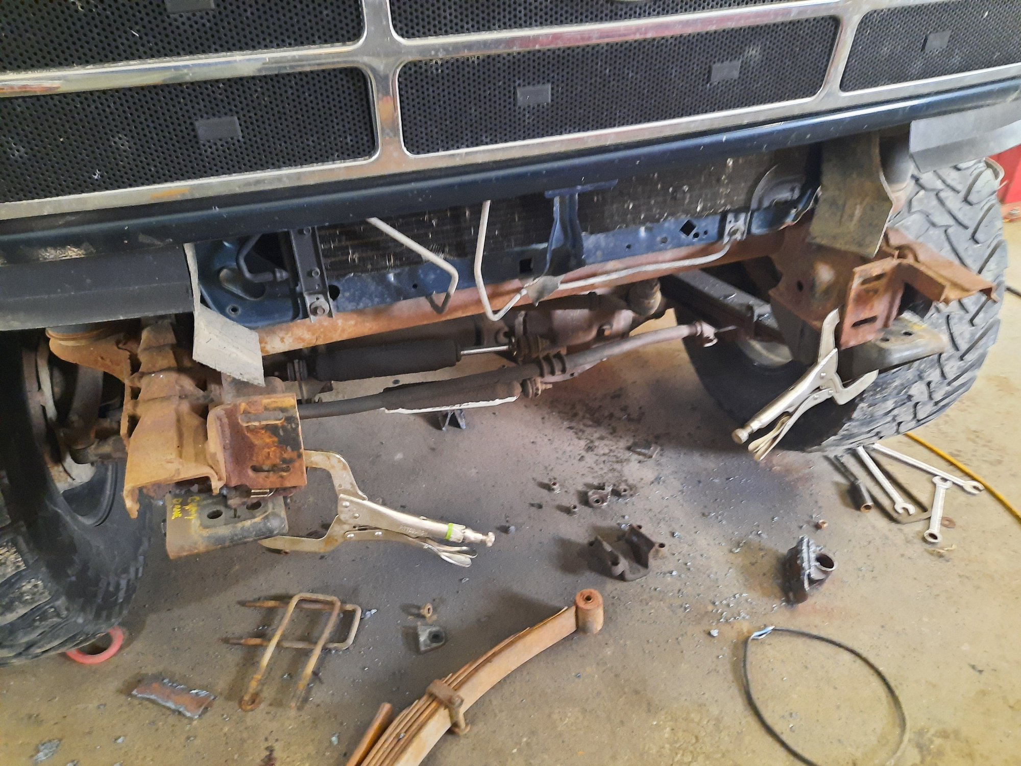

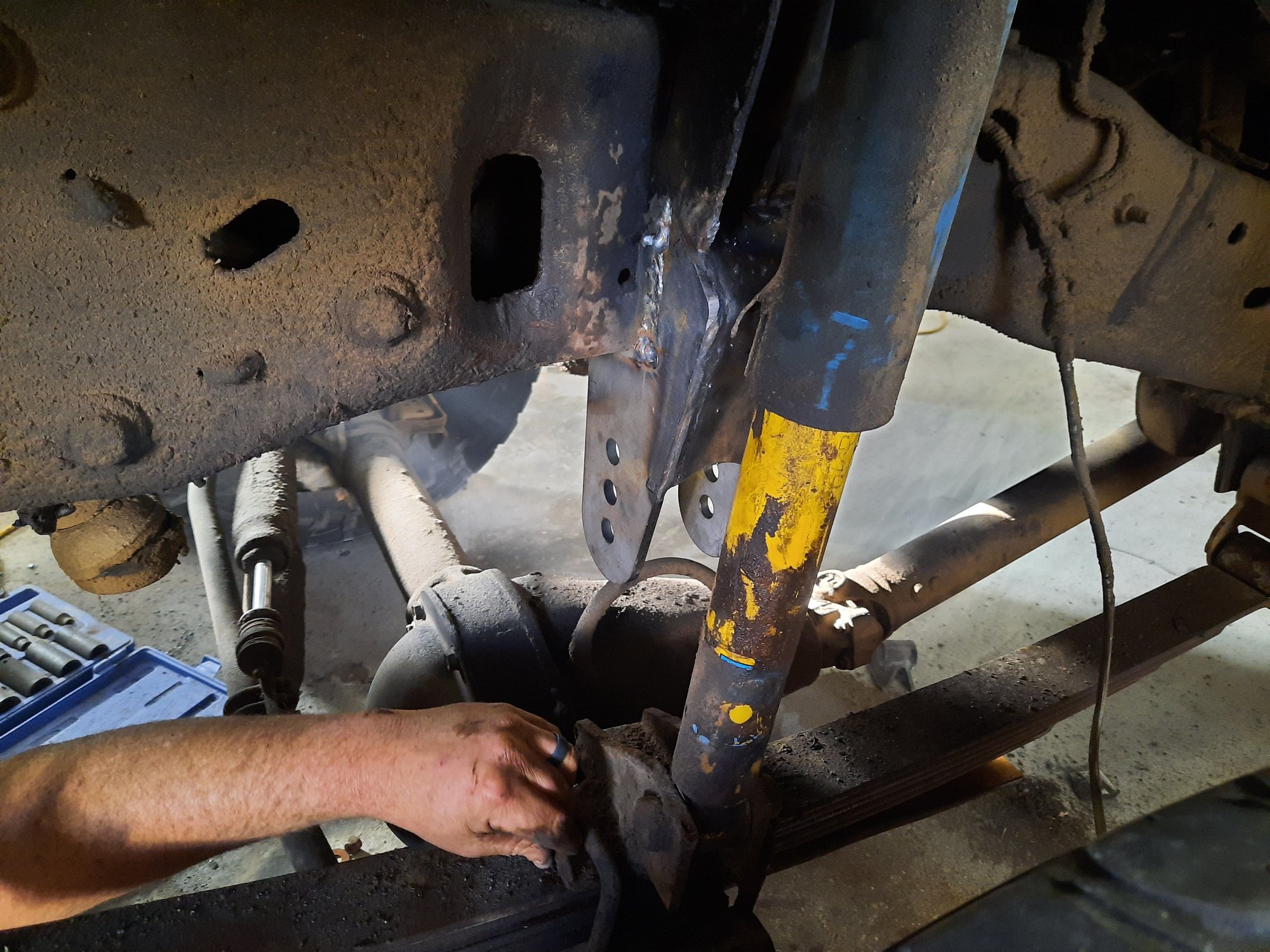

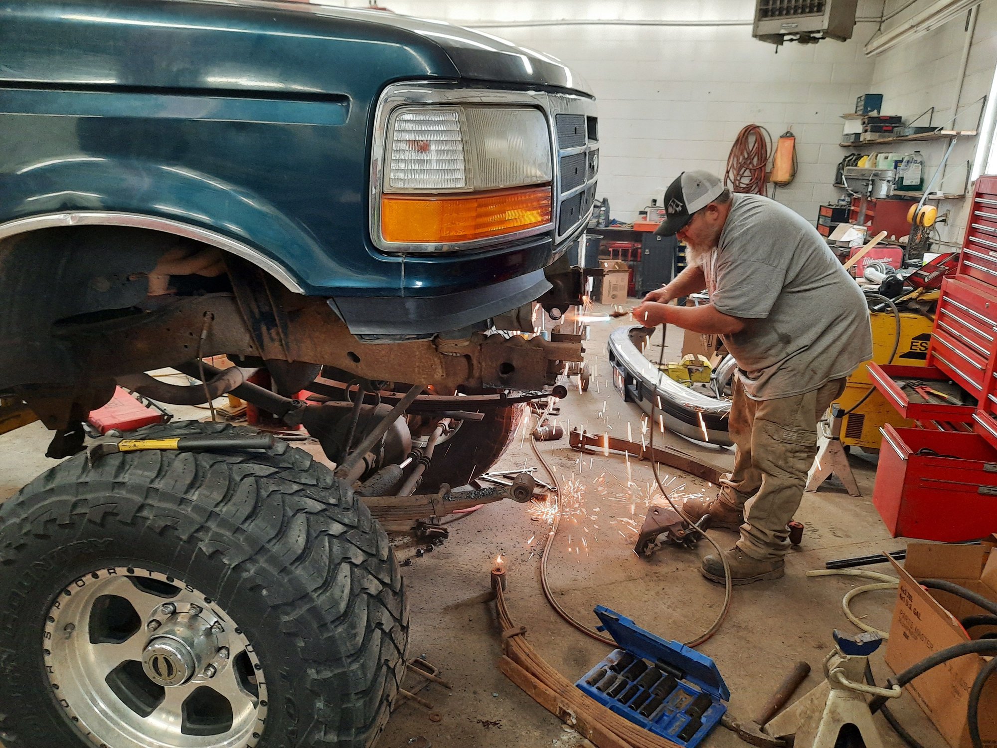

A bit after we started. Credit to my buddy Jack who had the experience and designed and built the spring mounts. Also to my friend Tom who assisted us and his dad Jerry who loaned us his shop for a while.
The previous owner had done a solid axle swap so it wasn't too tough to reuse the springs.
One of the newly fabricated front shock mounts.

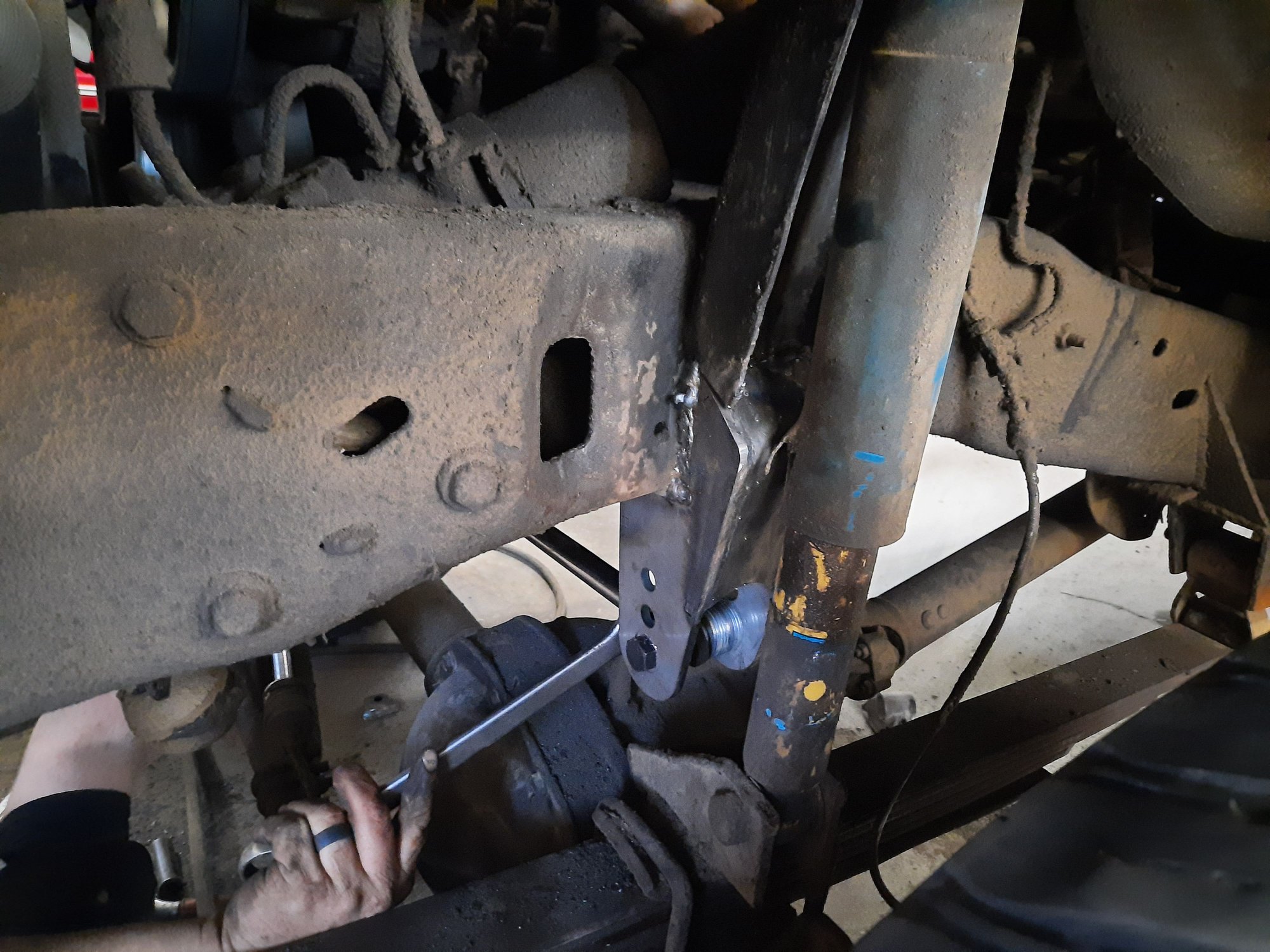

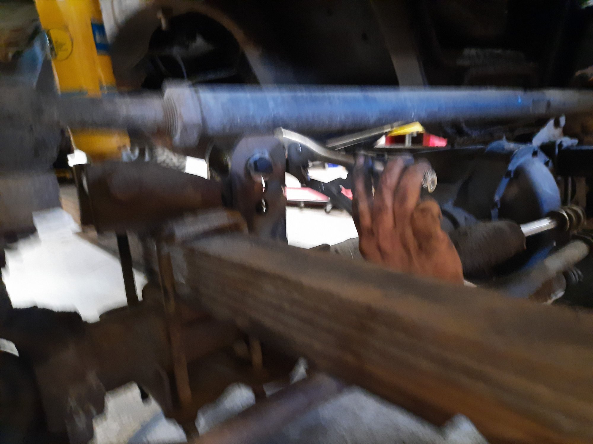

Kingpin Hi-Steer kit to reduce jump steer.
Dana 60 swap all done with new rims and tires.
Added Pro-Comp stabilizer shocks to reduce jump steer even more.

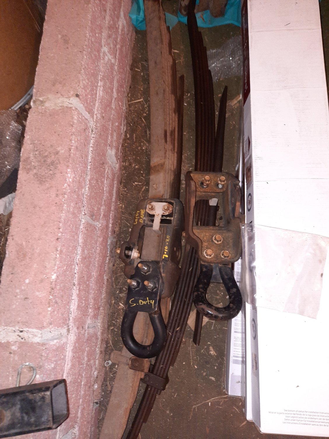

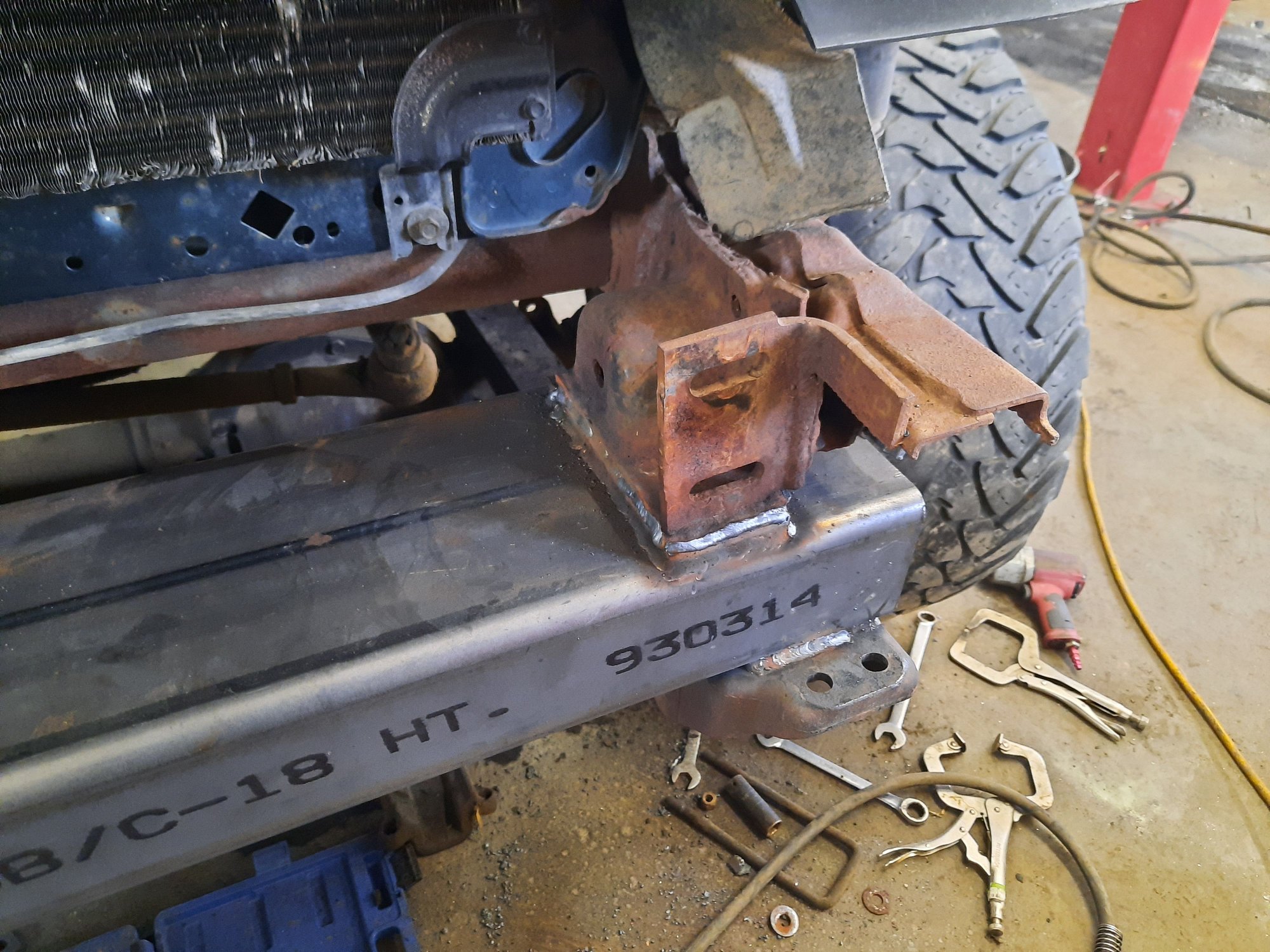

A few years after the D60 swap we redid the front suspension as it was bottoming out. 2004(?) Super Duty mounts for the front and 52" leaf springs from a '74 Chevy truck with a couple of leaves added to each.
Track bar drop mount ordered from Ballistic Fabrication. Got it cheaper than I could have made it myself.
Crumple zones welded to strengthen them. And we moved the sway shackles from the front near the bumper to the rear of the leaves.
All done! Note the Super Duty pull eyes sticking out from beneath the bumper.

Cool you are mostly set then if it is a coil spring dana 44. You will need the solid axle raduis arms and mounts.
I recommend some stock size tires to have it on during the swap, makes things easier.
I have always measured center of front hub to center of rear axle with stock suspension. Then after cutting all the ttb stuff out, roll the solid axle under the truck and bolt it to the springs. Then use a jack under the radius arms to get them against the frame. Next I measured the axle to hub centers again to see where they are. I use ratchet straps to pull the front axle backwards if needed. Once close I then measure criss-cross LF shock mount to RR shock mount and vice-versa to see if they are the same or close. Then drill and bolt the arm mounts in place.
Oh yeah forgot in earlier posts. You will need the panhard/link bar for locating the front axle side to side. So yeah that is important too. I can't remember if you will need to do anything with with brake lines to run the old style calipers or if the line threads are the same. Also, the 92 calipers won't work on the solid axle. So add brakes to the list.

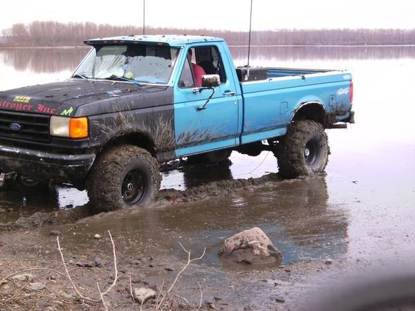

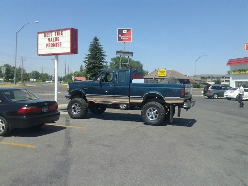

94 150 5.0 4r70w and 3.55s
Same truck after a nose swap ( small front end collision), and solid axle swap
Original f250 light duty. 2wd conversion to 4wd coil sprung 44 and 8.8 out of the blue truck after a fuel leak burned the blue truck down
D44 swap flex... basically no suspension flex with 4 inch springs for a 79 f150
Same red 250 converted to 1 ton running gear and coil sprung D60 conversion.
6 inches of lift on 1 tonsand 37x12.50R16.5 Hummer surplus tires
