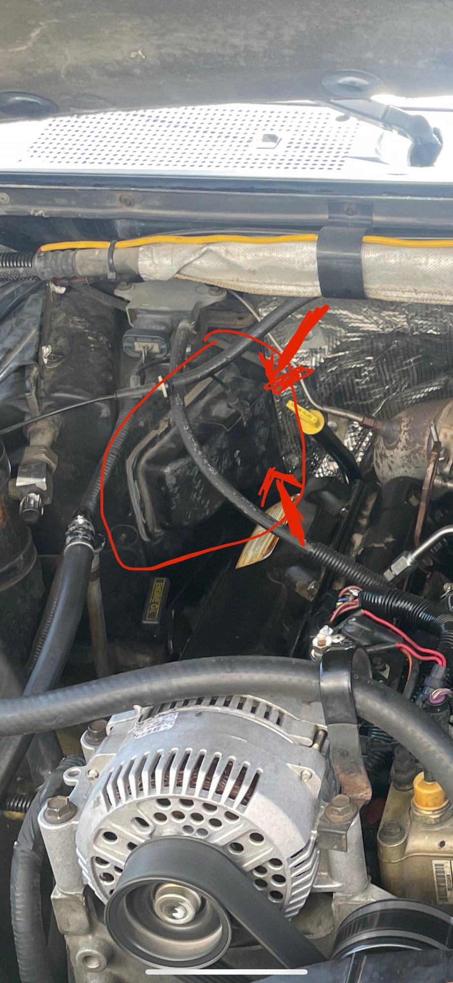

I had to remove this off of my HVAC box When I did my injectors, I tried to re-seal it with RTV because it cracked and a couple different spots when I was working on it and the gasket disintegrated. I had two vacuum leaks in these areas where the arrows are.
I’m pretty sure I fixed my issue. I had one small anyone really big vacuum leak around this accumulator or whatever you call it. I probably did not need to install the new vacuum pump but now I have one, the old vacuum pump on the truck was purging air though whatever the engine was running, you could hear it spitting so the new one does not do that.
I believe the issue was resolved, but I will keep you guys updated. If it’s not thank you for all your help. I’m also probably going to re-bleed my brakes system as y’all suggested at some point.

that outlined box is your AC evaporator cover

Vacuum tank is there too
