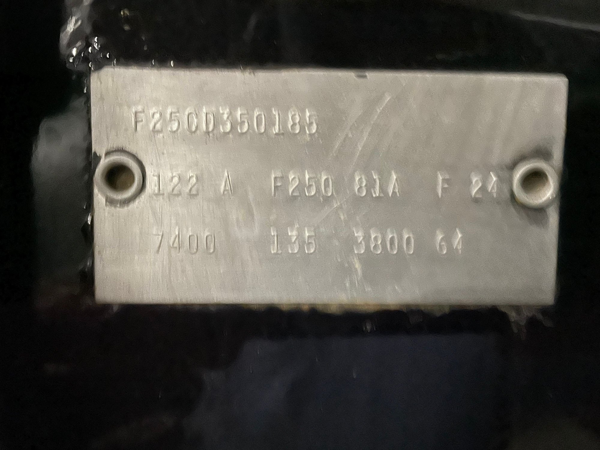

I am not sure what rear gears but they are higher than 4:50 and granny 4 speed , 40-50 mph is about it rpm’s are high at 50
I was hoping some body could look at bun plate and tell me what it means

For rear gear ratio, you can check for a metal tag on your differential housing cover though choosing a gear oil based on gear ratio is probably the finer points of lubricant choice and not tremendously important.
You likely have the T98 tranny and if so, "T98" is cast on the tranny case. If not, a website like "Novak Adaptors" gives info on identifying 4 speed manual trannies.

According to the warranty plate pictured - truck is a late 1962 build for the 1963 model year. Rear end is a 4.56:1 ratio so you could gear it for higher speed with a rear end swap/gear/carrier change. No front differential on a 2WD truck so no fluids to change there. A few grease zerks and that's good to go.
F25 = F250-4 x 2
C = 292 2V
D = Dallas, TX assembly plant
350185 = November 1962 assembly month - 1963 model year
122 = wheelbase in inches
A = Raven Black
F250 = F250-4 x 2 - 7,500 lbs gross vehicle weight rating
81A = Standard Cab
F = T98A 4-speed transmission
24 = Dana 60 4.56:1 ratio non-limited slip
7400 = GVWR
135 = Horsepower @
3800 = RPM
64 = New Orleans, LA district sales office - not a special order truck
