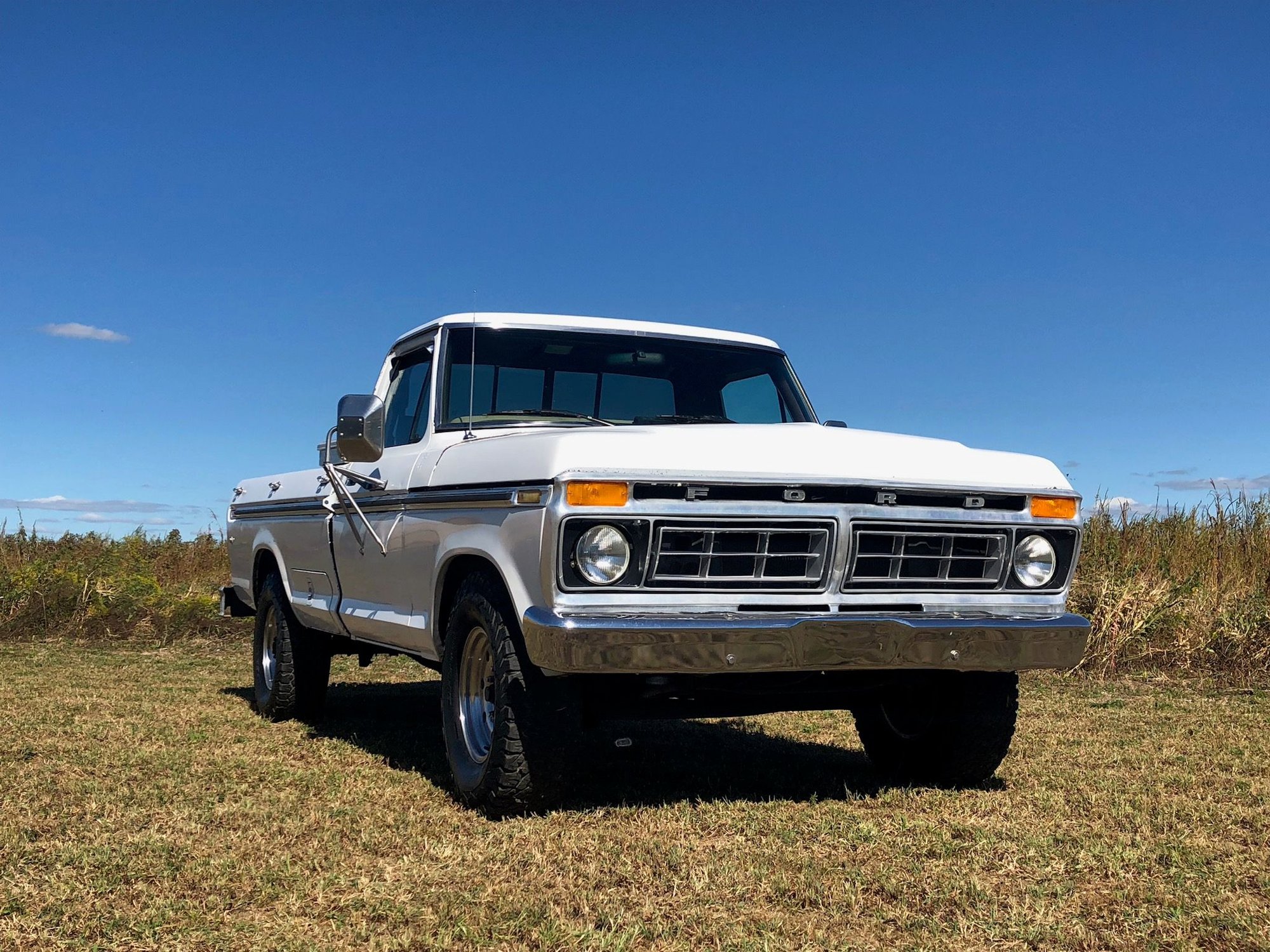

Here is what I used and I could not be more pleased with the outcome. It was simple to install, puts out plenty of light, looks stock, and didn't cost a fortune.
LMC Relay Kit
https://www.lmctruck.com/1973-79-for...dlight-harness
CJ Pony Parts H4 Headlights
https://www.cjponyparts.com/headligh...SABEgKkVPD_BwE
