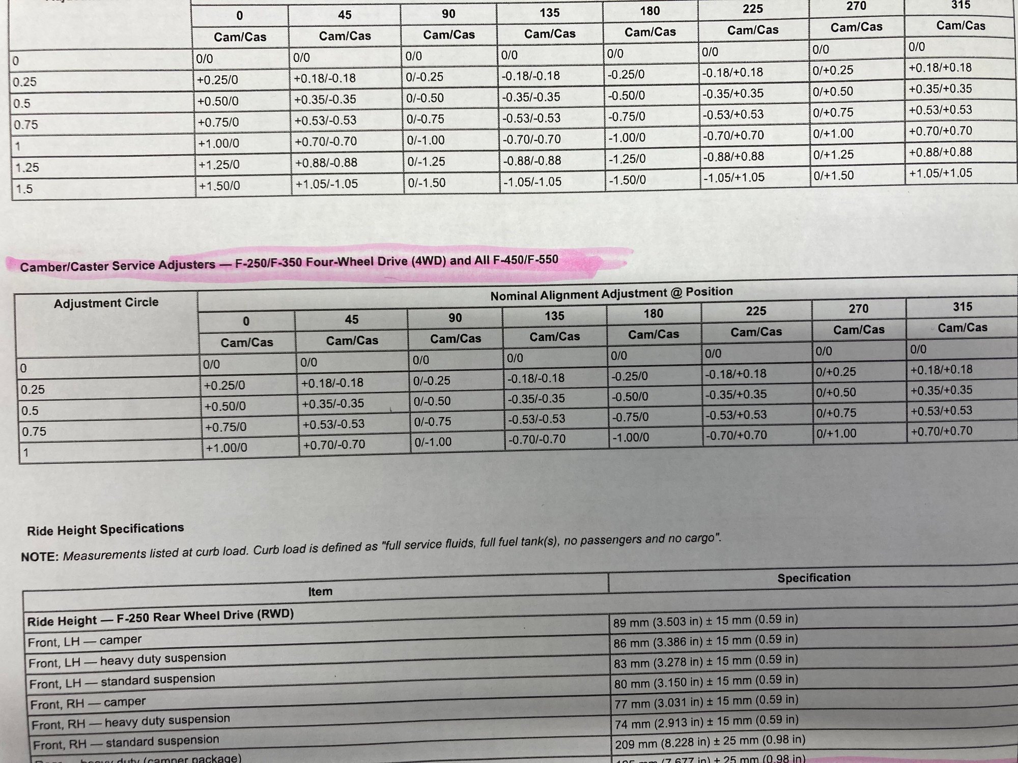

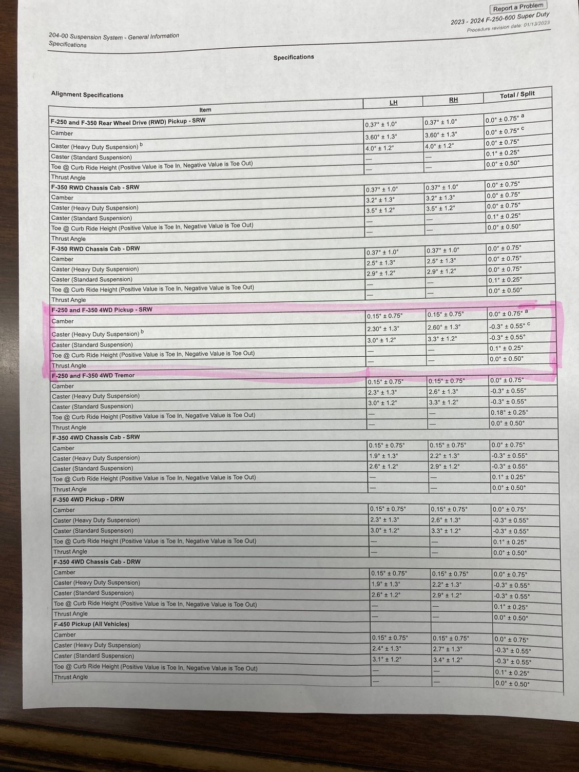

Here you go fellars,
Alignment specs directly out of the Ford Service Manual for a 2023 / 24 (see upper right corner on first pic) - previous mentions were correct; and what I had heard was not correct (that 23 specs were different than a 20 model). Unquestionable now (on my end at least 😎, and for future dudes looking this up) - I know it was never a question in some you men’s minds — please see below
Wondering, as with 1.8 degrees being minimum, and I’m sitting at 2.25 — being .45 degrees from minimum — will this have any affect on steering while towing a load? I do not think it would, if any?
I haven’t a clue if these new trucks slightly raise the front end when towing, this is my first new F250 — reason I query — when I used to hook up a trailer to one of my old trucks, the front end ‘looked like’ it raised a bit — definitely know the steering got lighter/ had to be careful driving, especially if the trailer started swaying a bit (make your butthole wanna grow teeth and bite down on the seat frame at times) — don’t know anything about these new trucks, if they raise a hair in the front, or not.

Yes these trucks do. My 6.7 CCLB squats rear/raises in the front slightly when I hooked up to a 10k trailer. With your Carli rear leaf springs, unless you added air bags you will squat significantly as your hitch weight approaches 1k pounds. Here is an article from carli- written by Dan who you have been in communication with about how the carli level springs handle weight. https://www.carlisuspension.com/ford...ing-load-test/

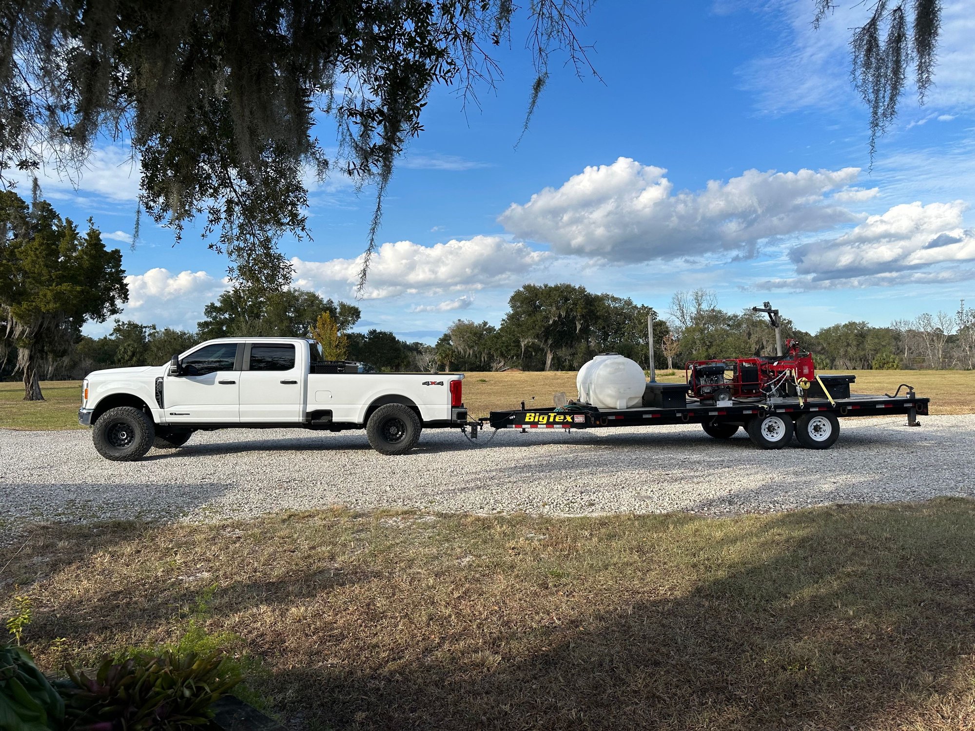

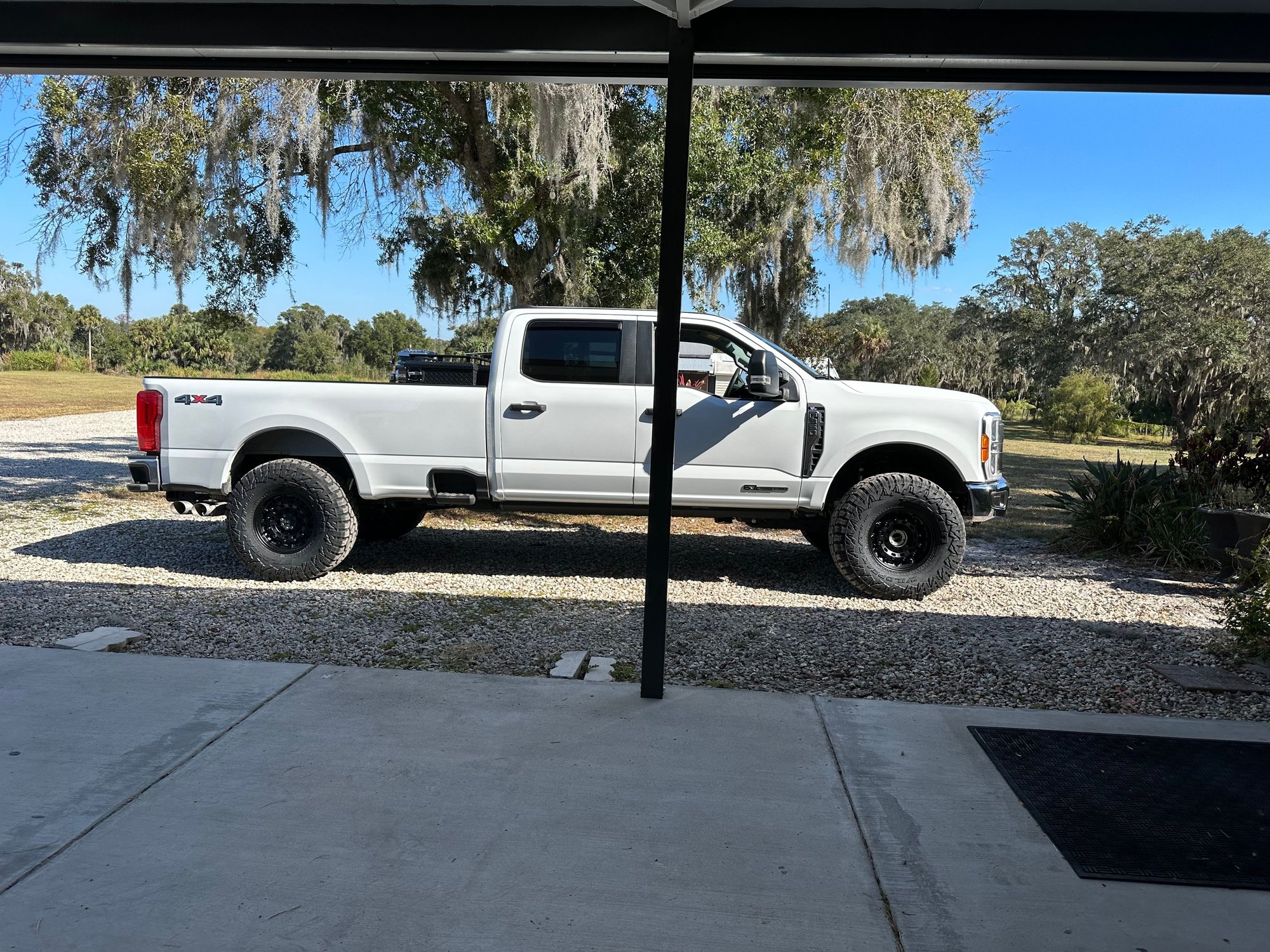

Also since you had asked about squat with a trailer here’s a pic I grabbed today with my work trailer hooked up. I think the weight is about 8k and I had about 500 pounds in the bed as well
I’m on stock f350 rear leaf springs, stock shackles and Carli commuter rear shocks
second pic is unloaded except for my ~150 pounds in the tool box

Firstly,….man, your property looks like where I grew up in Plant City,…… even has the same limestone drive (looks like limestone in the pic). Back then, all we had was a 20” push mower,…took a minute to cut the yard every week 😁
Impressive that you could knock 3oz off, and not have vibrations. That matches what an OTR trucker buddy of mine said, ‘you could sling a weight, and not even realize it.’ These may help some dudes wrestling a pesky vibration out there. Plus, my buddy said, OTR semi’s mainly use them to increase tire use longevity,…don’t know if this would apply to our style tires.
Nice trailer and rig, and my boat/ trailer weighs roughly the same 8500lbs,….. Due to my regular cab’s lighter weight, the full progressive rear springs have the truck sitting 2-1/4” higher than the max 1” height increase Carli advertises - we’ll see if this translates to keeping me a hair higher off the bump stops when I hook up. May prove to be a blessing in disguise,….we’ll see - still gonna sag a lot. I’ll make do till I can get some bags installed.
