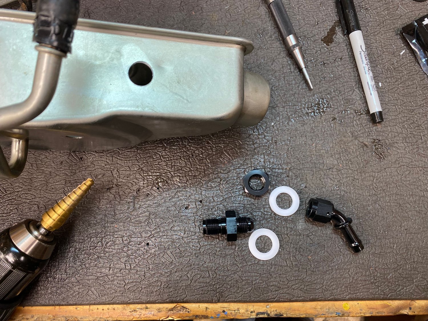

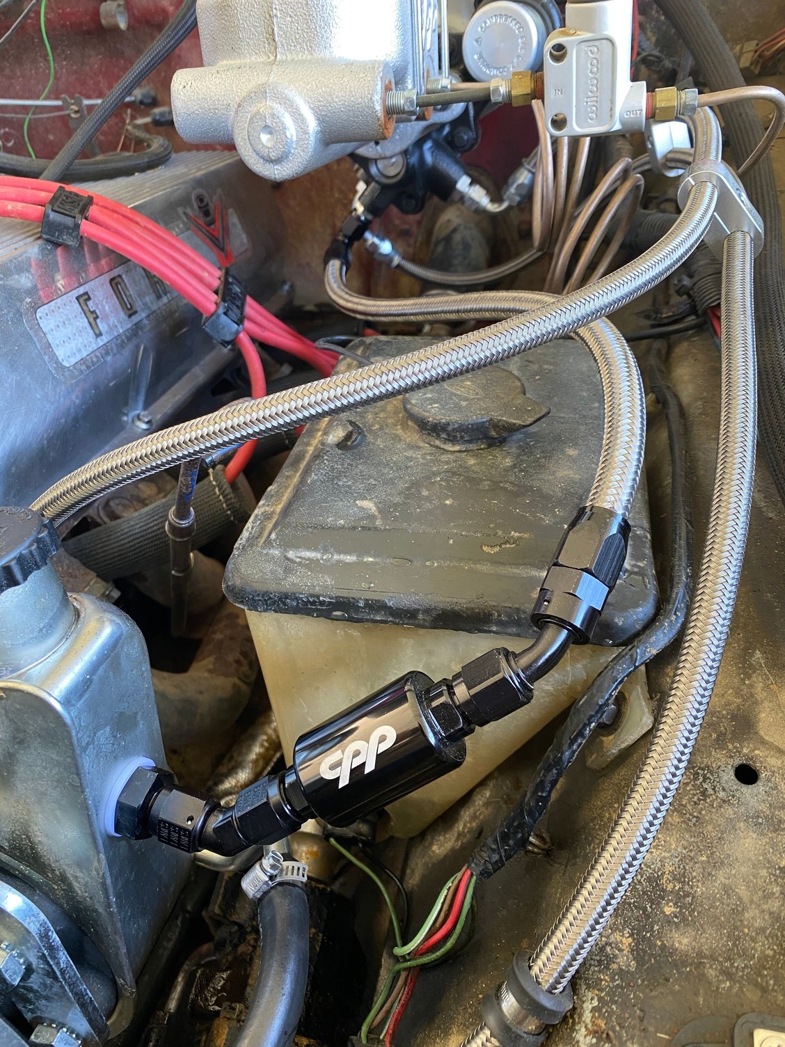

You asked about an extra port on the Saginaw PS pump. If someone offers a pump reservoir with a second port for low pressure return, that would be nice. I found out that T'ing into the existing return line isn't a good idea. I got a lot of back pressure. So I added a bulkhead -6AN fitting to the pump reservoir, and ran the hydroboost return to it, instead of T'ing it into the gearbox return line. That cured the back pressure problem. I posted a thread on this.
This photo shows the hole I put in the reservoir. And the -6AN bulkhead fitting laying next to it. I ended up not using that 3/8" nipple fitting.
This one shows everything after final installation. I made up a braided stainless return line, and added an inline filter. It would have been easier to just use that 3/8" fitting and a rubber hose.

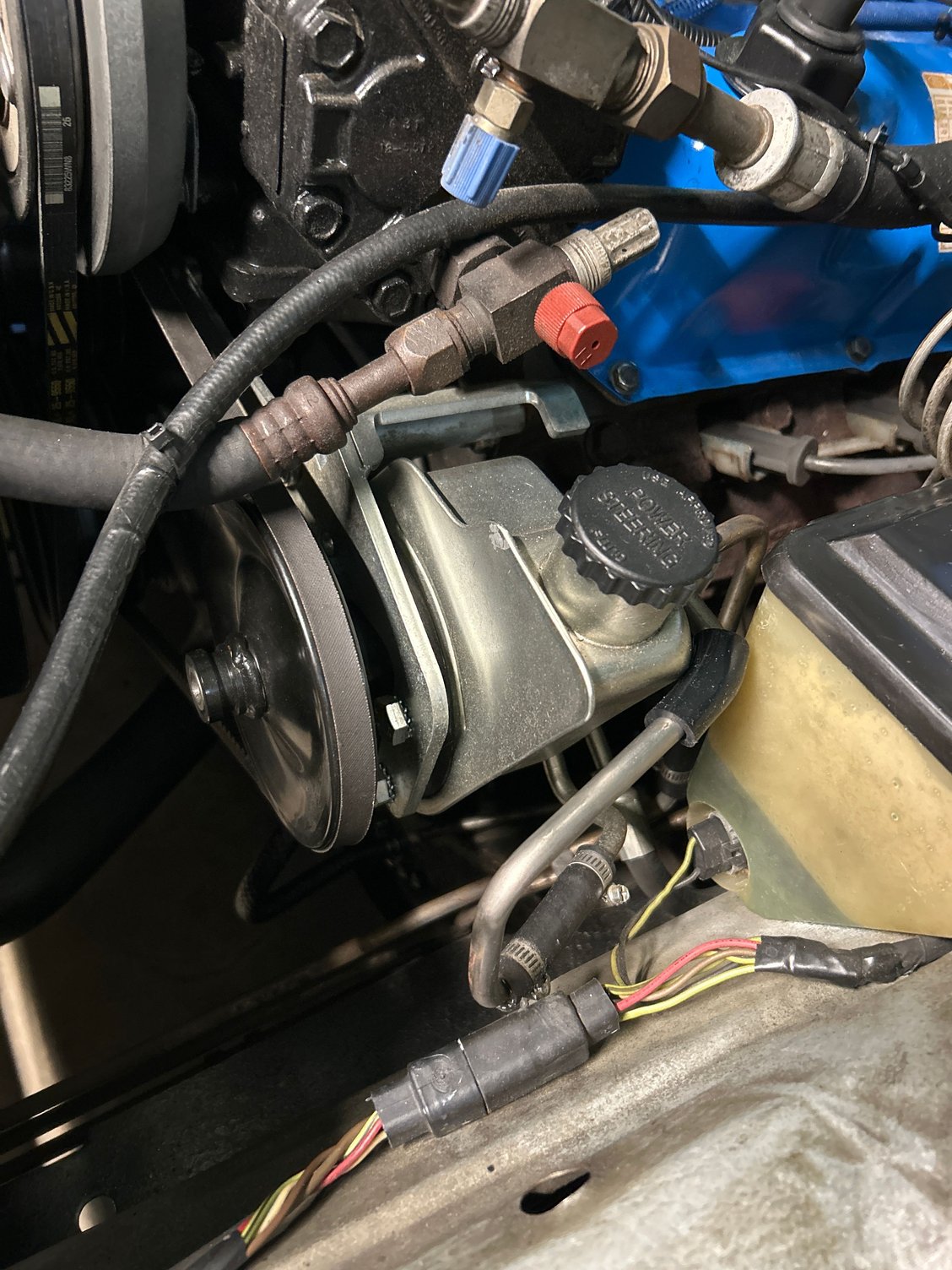

All you 4WD yuckety-yucks giving us 2WDs a hard time. Sheesh. 😂. My saginaw pump set up is shown below.
A few years ago, I finally admitted to myself that it's a weakness. I fear being in a 2wd vehicle, and getting into a situation that requires 4wd to get out of. Which is pretty common where I live.
Your bracket and pump look exactly like mine. Wild Horses?
