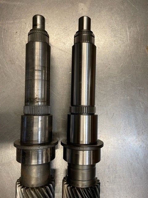

This is the photo he sent me showing the differences. You can see that the second set of splines from the top are different lengths. The one on the left is the high torque.
There is a good chance that I will probably be ordering one of each as my identification tag is unreadable.
