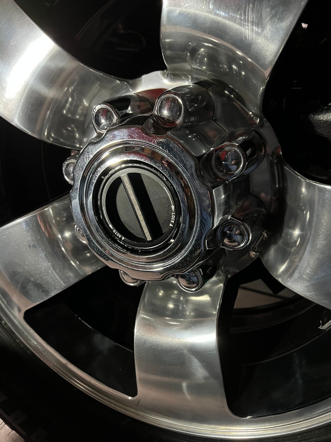

Just FYI: if your front locking hubs look like (pictured below), they will be OE from Ford, and allow you to "manually" lock in the hubs should the ESOF fail.
On mine, both with non fluent hubs, ad new ones, I have found the hub teeth didn't always release/disengage following the me turning the actuator back to "Auto" without rotating the wheel backwards a few degrees, of which you can sometimes hear the hubs disengage (soft pop). If your hubs are as pictured, then see if you can understand if they disengage when manually turned to Auto, then follow the steps in the above post.
