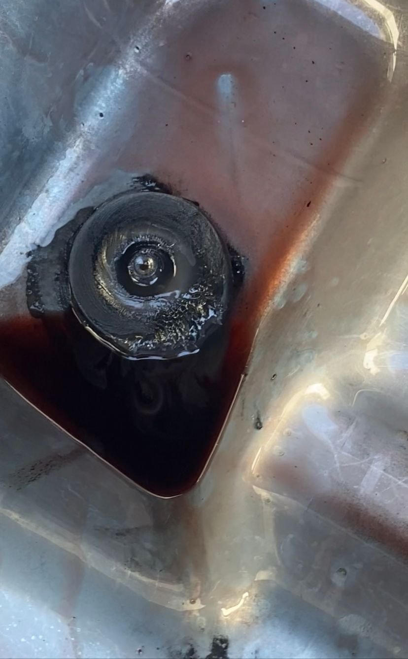

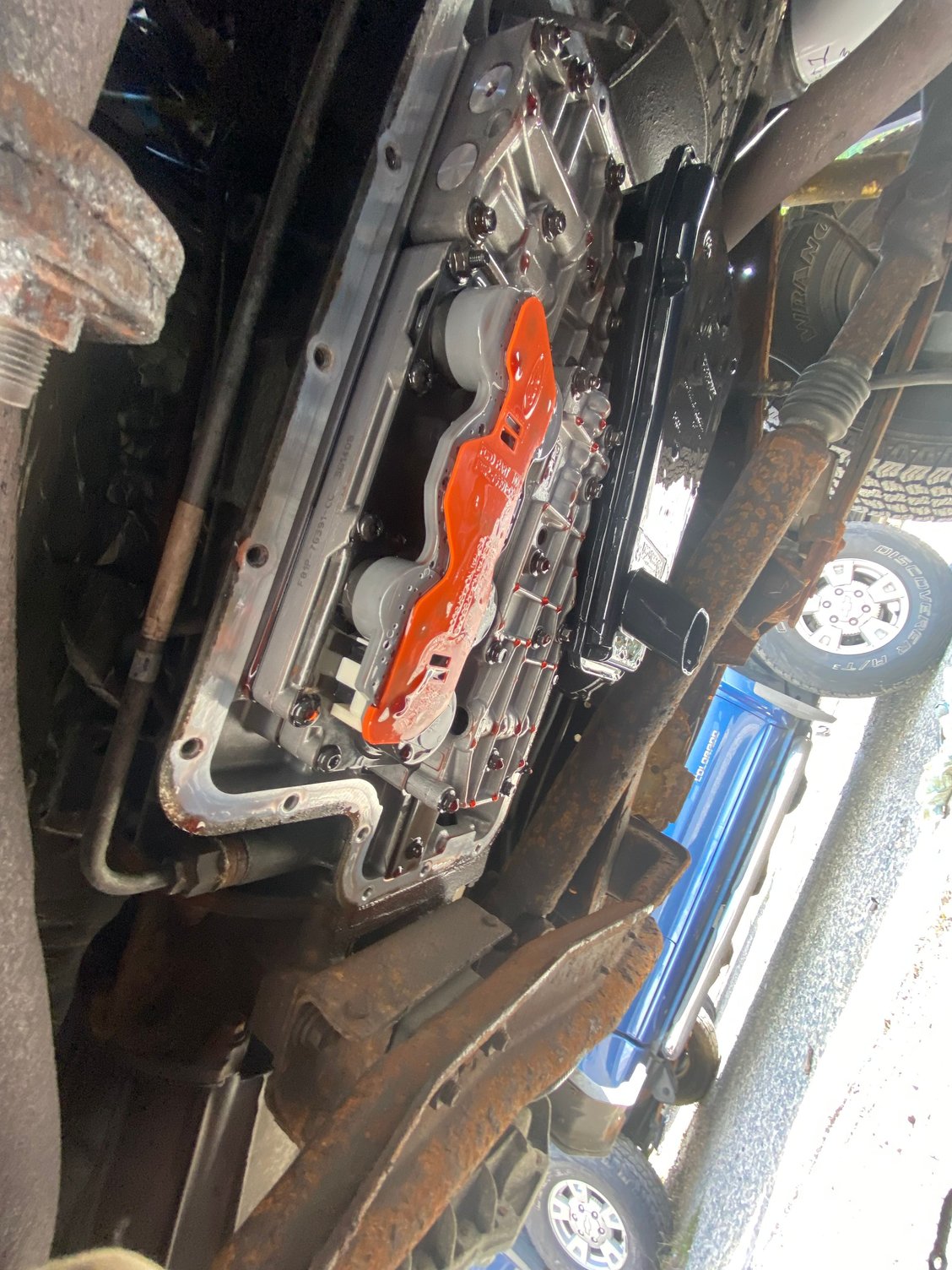

•CHANGE PROCESS
•drain fluid in pan, (through plug)
•drop pan,
•remove old filter and o ring,
•clean out pan,
•use hand pump to remove fluid from upper cooler line (I believe the return line).
•reinstall upper flare nut.
•install new oem filter,
•install new gasket (I know they’re reusable but mine was compromised)
•reinstall pan (with proper torque spec and sequence)
•install new oem Mercon V fluid,

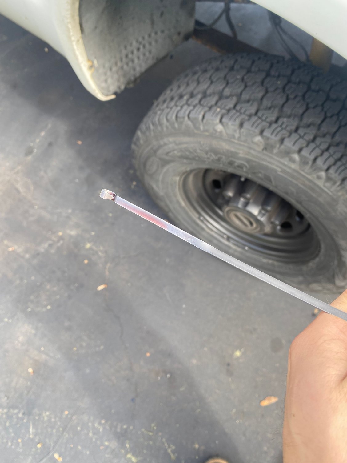

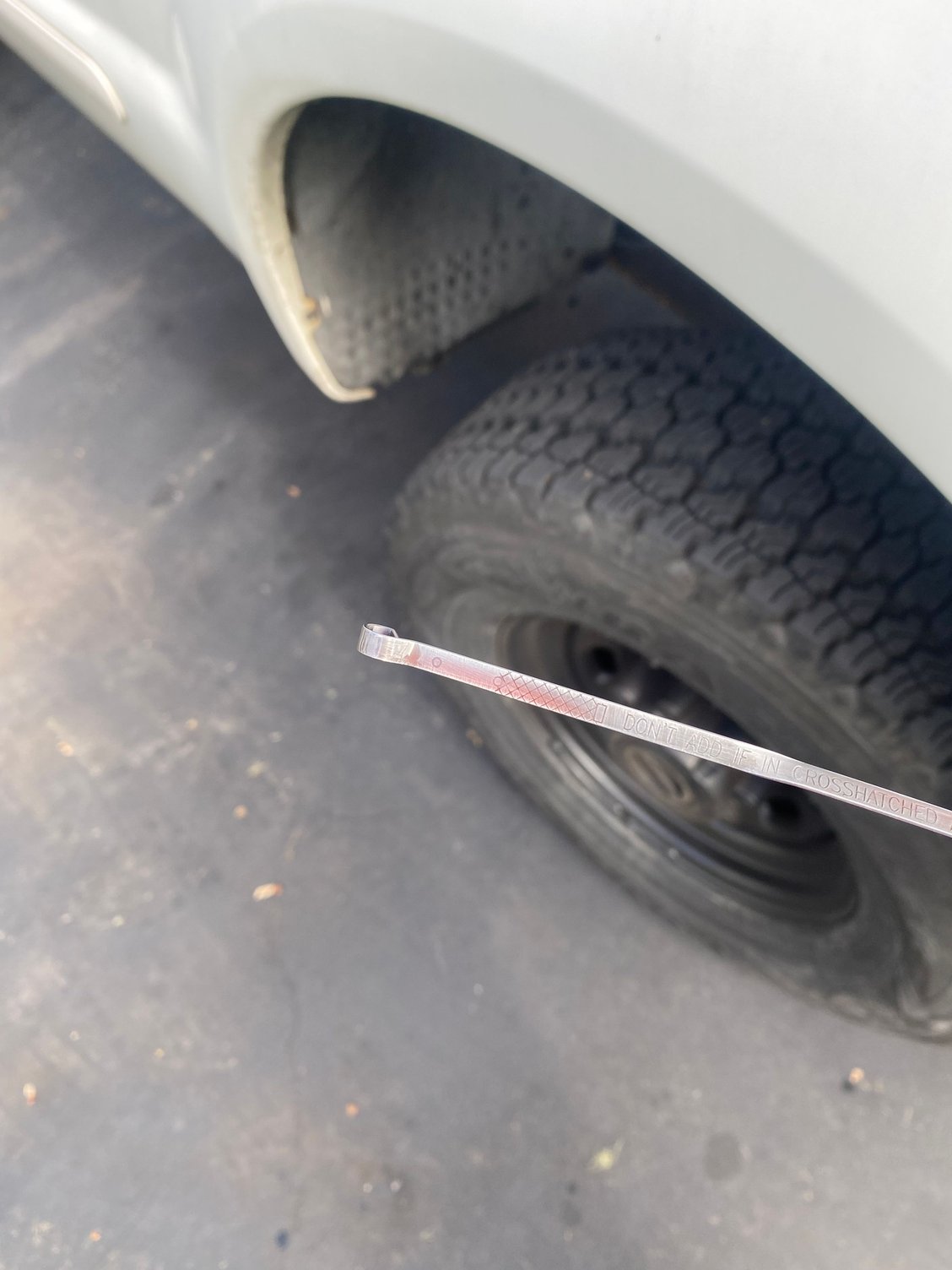

Now since driving it for a week, (and obsessively checking fluid levels as I am not entirely sure I am perfect with quantity)…
I was finding it difficult to get a good reading but have since scuffed up the dipstick and it reads to me and others to be dead nuts on with quantity…
I would say that the quality of the shift and overall engagement of the transmission is declining… and as of today seeming to slip slightly…

How much fluid have you added?
Is it a 4x4 or a 4x2?
Did you use a 4x4 or a 4x2 filter?
Does the OD OFF light flash?
Are there codes stored in the computer, even if the light didn't flash?

The E4OD and 4R100 used the same filter. The E4OD use a short filter in the 4x2 and a longer filter in the 4x4. The 4R100 (except the Lightning) used the 4x4 filter in all models. Many parts stores get it wrong and sell a 4x2 filter for a 4x2 4R100. This can cause problems like this.
Since yours is a 4x4 you probably have the right filter.
