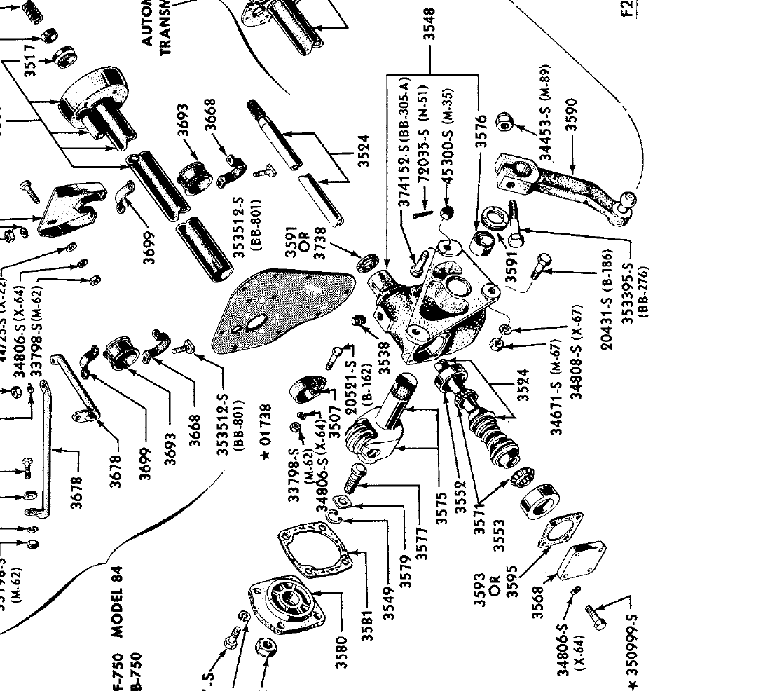

Originally Posted by resonateur
3. It certainly is possible to shorten your steering column. Research it here or ask questions if you're not familiar with how to do so. You've got to shorten the column tube, the shift tube and the steering shaft...all equal amounts so it can be tricky. I don't believe that its safe to cut and weld a steering shaft so I cut mine off at the end and had it re-machined to a "double-D" profile and used a matching U-joint and eliminated the rag joint. I swapped my column for a '78 tilt column and was able to eliminate 4 inches, moving the steering wheel much closer to the dash. Consider a dished steering wheel to move the hub further away from your internal organs, however, you will loose some of the space you gained if you go with a deep dish wheel.
You can sure shorten a 1965-66 2WD steering shaft that way. Any 4WD though - other than 1966 F100 4WD - is quite a bit different from the 2WD trucks. Gemmer the Impaler is designed so that everything from the threads that hold the steering wheel on to the worm inside of the steering gear is all one piece. Not sure if it would like to be pushed a few inches closer to the dash, either, without altering the mount location of the gear at least slightly. It seems by just moving the column upward it would put the steering shaft in a potential bind and the bearings would probably not be lovin' it. Look at 3524 both before and after the box itself. It's all one piece.

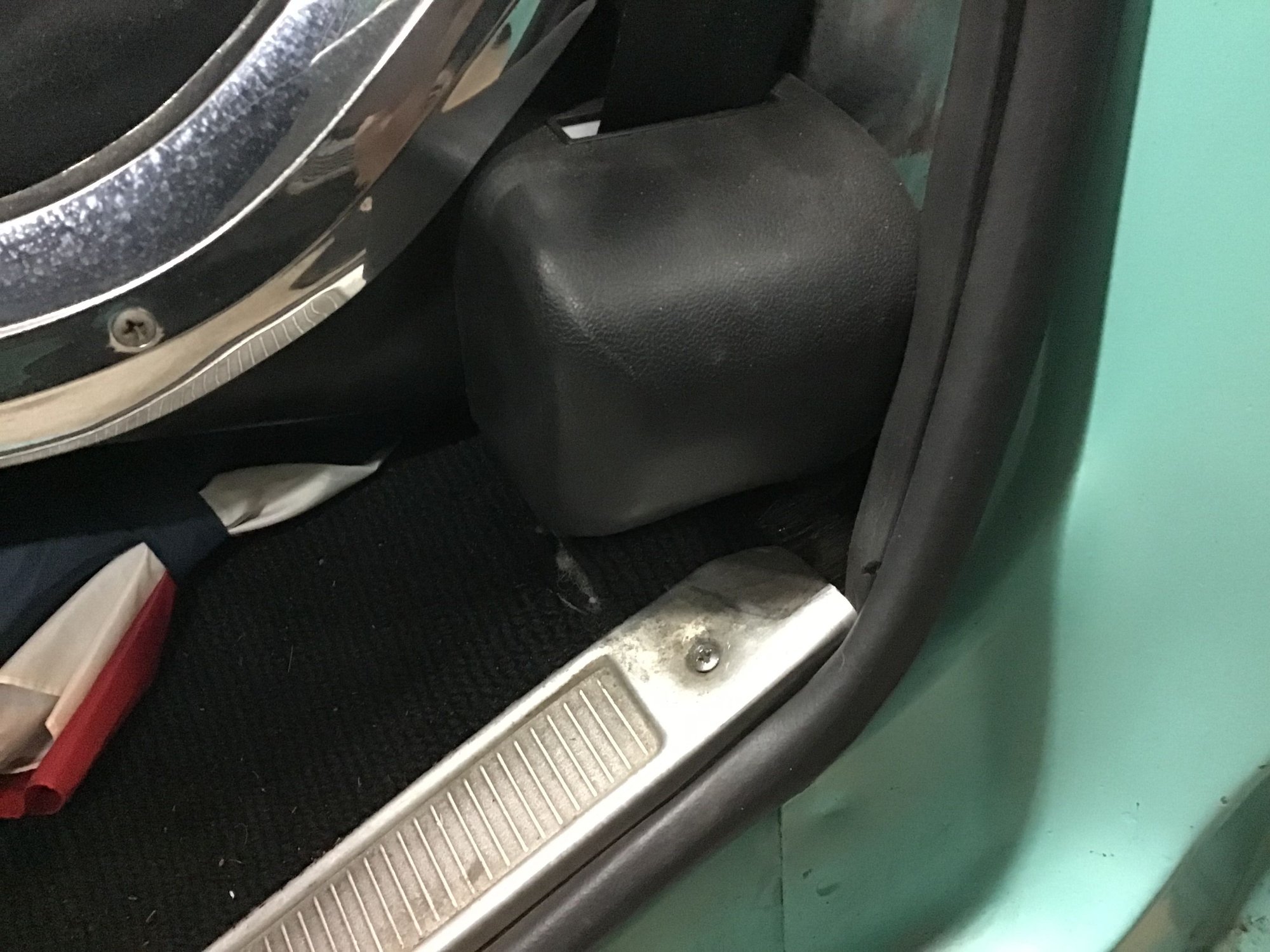

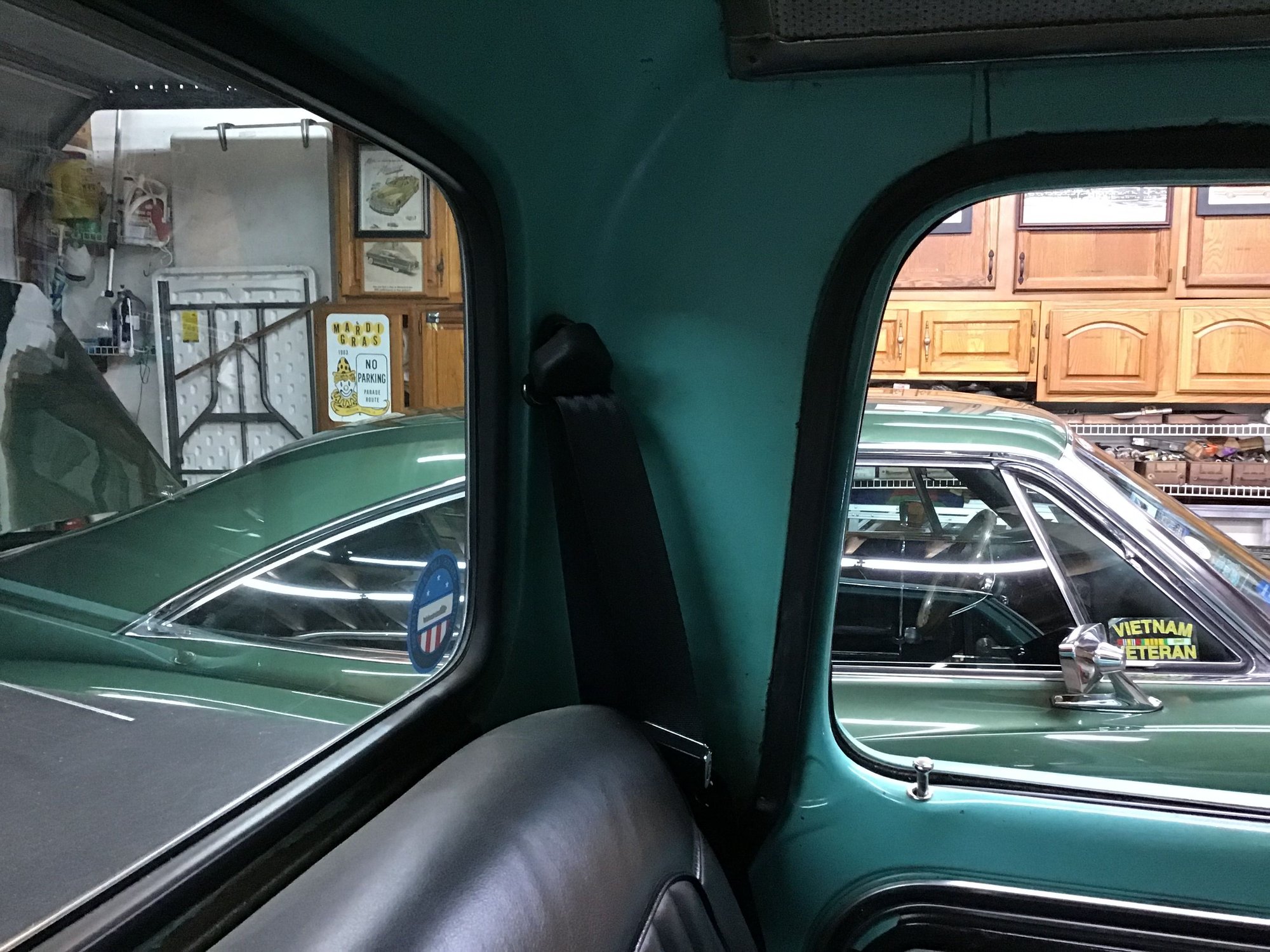

is should give an approximate location
With the seat all the way back the retractor is a close fit.
