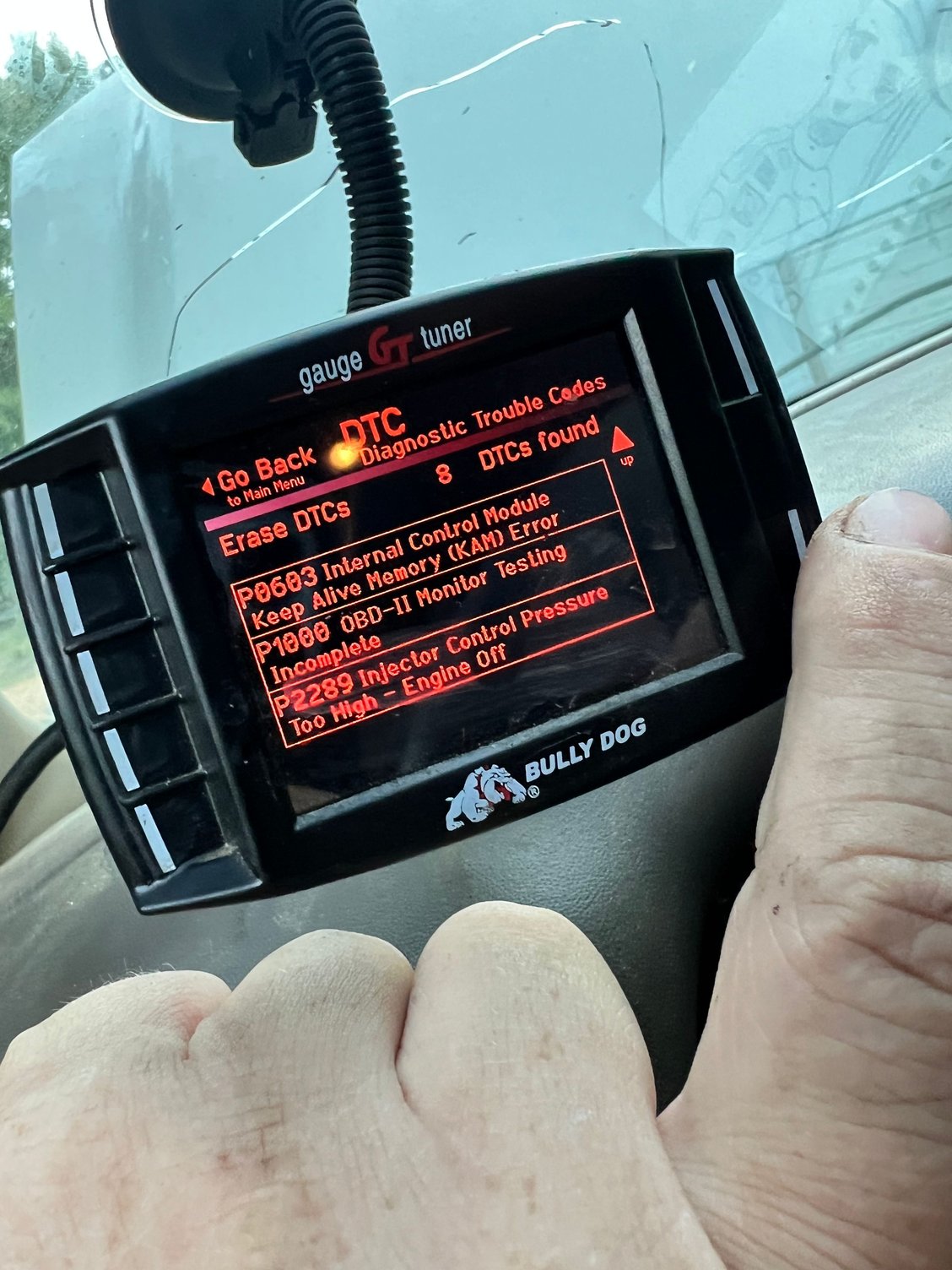

I have a 04 6.0 powerstroke diesel when I was driving home from work one night it just shut off completely. Before that it was acting like it was hesitating to get up and go. I put a new fuel pump on there. The Ficm is reading 48 volts. Brand new icp and irp valve. Any advice would be greatly appreciated

But I notice several of those are fuel-related, did you replace your ICP, IPR, and any other sensors with genuine Motorcraft parts? For whatever reason, the aftermarket ones don't read/react well enough for these trucks.
I see a LOT of 'xxx too high' which is a problem, kind of leads me to believe you've got a short or something in the system. Are your wiring harnesses in good shape?
EGR codes are possibly a stuck EGR valve unless you've got it deleted, then it just wasn't deleted properly.
The 'Keep Alive Memory' one can be ignored, from what I understand the only way to fix it is either to crack open your PCM and replace the internal battery, OR replace the PCM.

I did swap the icp sensor it’s not motorcraft. It starts and then when it warms up a little it’ll die

Yeah these motors really only like Motorcraft electrical components like sensors. For whatever reason they are hit or miss with the aftermarket parts. I had an ICP put in one of my trucks that wasn't Motorcraft, it would function okay on a stock tune but if I tried to put any tune in it at all I'd get a CEL. Swapped for a Motorcraft and the issue went away.
Not saying it is 100% your problem, since it looks like you've got a LOT of issues going on, but it likely isn't helping you.
