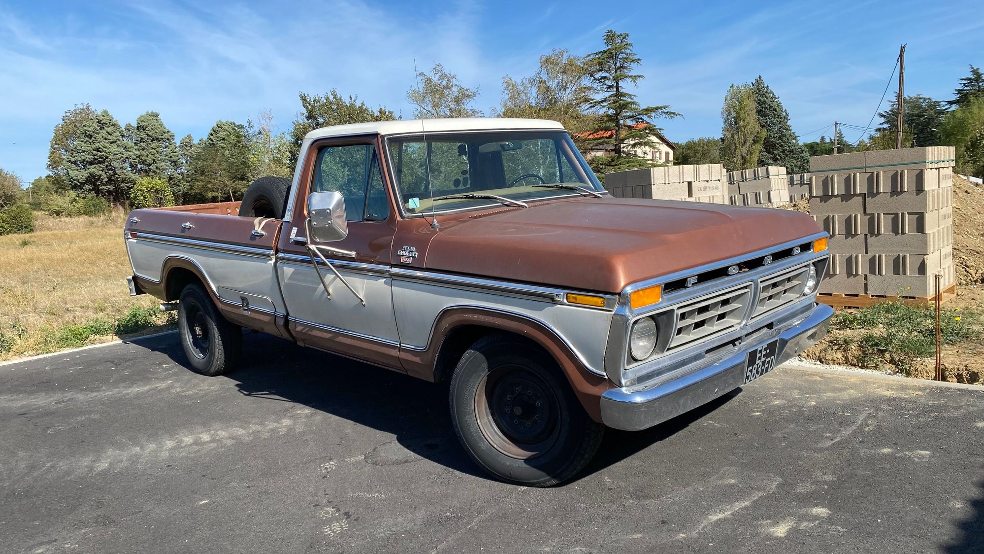

My old f250 1977 need new tires. Mine are 9,50x16,5. What do you think i should do ? The same size or other ??

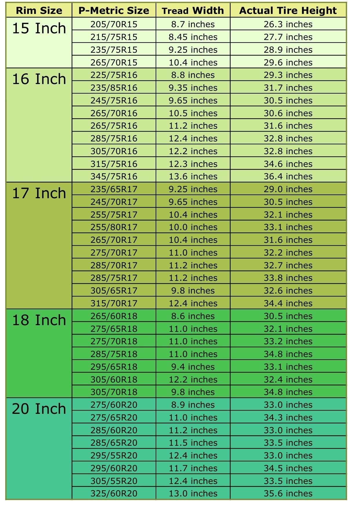

To have a WAY better choice of tires, YES upgrade to 16's or even 17's (with the correct off set/backspace to clear everything).

i will probably go with brand new 16 " wheels, and maybe 235/85 R16

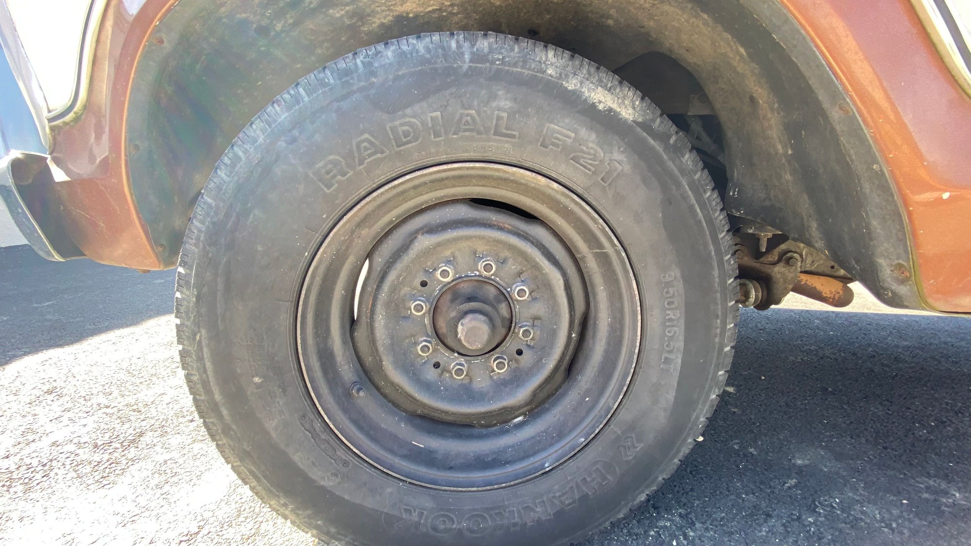

My local deeler only offer me 15´´ wheel.
i ´m not happy with that.
Old Oct 4, 2023 | 10:39 AM
77&79F250's Avatar
77&79F250
Moderator & parts slinger
Posts: 50,267
Likes: 5,822
15" wheel in a 5 or 8 lug? You know you need a 8 lug, 8 on 6.5 lug bolt pattern.
