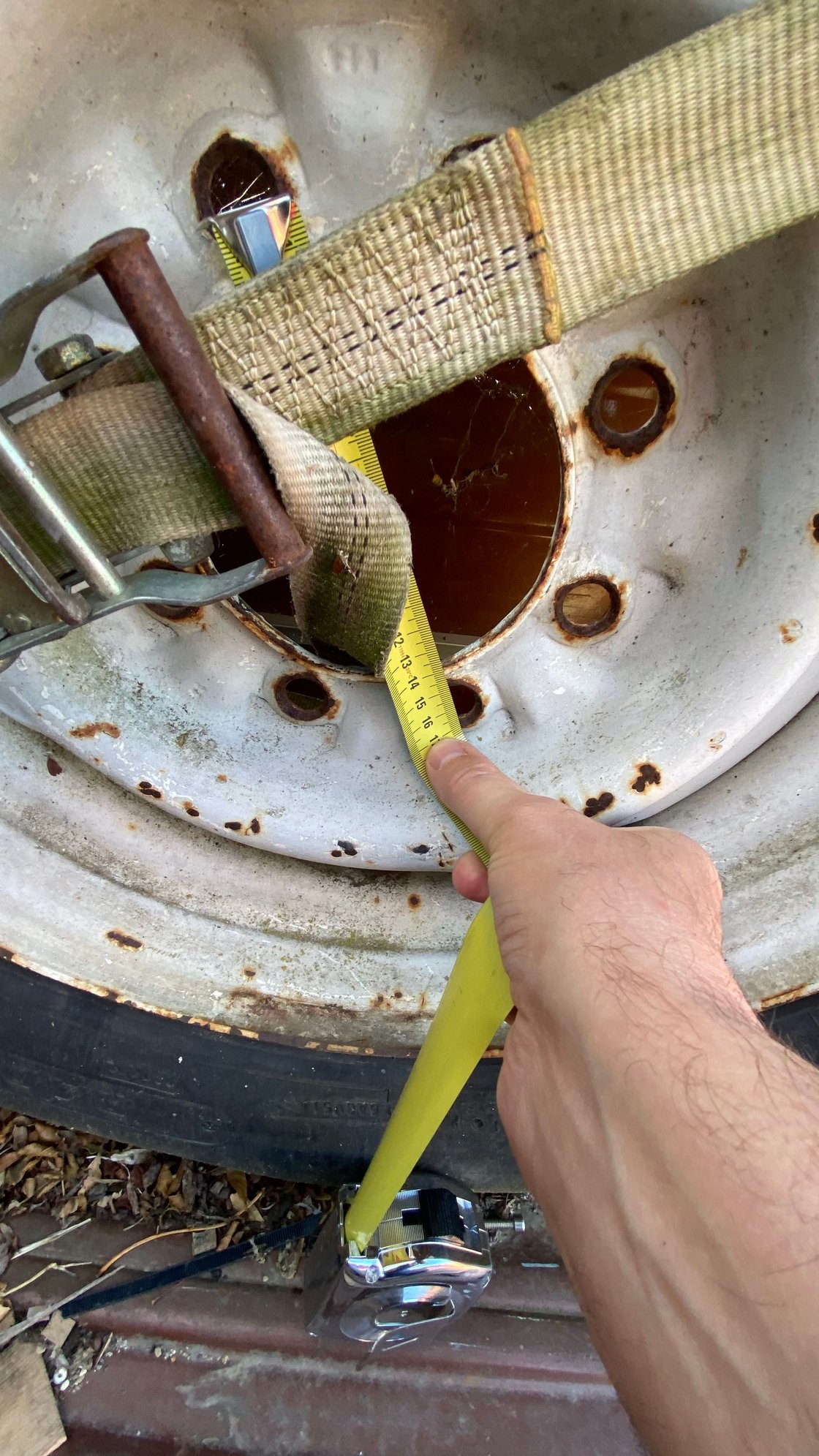

8 lug. but i would like 16 " instead of 15 " beside i don't like the chrome like.

A F250 rim is measured or called 8 on 6 1/2". So 8 lug bolt (holes), measured at 6 1/2 " (inches). middle of the hole and then across to the opposite one. Just like you are doing. So 8 on 6 1/2" ='s165.1 MM or 6 1/2" is 16.51 Centimeters.
And yes you need to get 16's or 17's (rims) to have WAY better choices on tires. And yes NO 15's, I bet a 15" rim might not even fit. Depending on your backspacing/offset.
