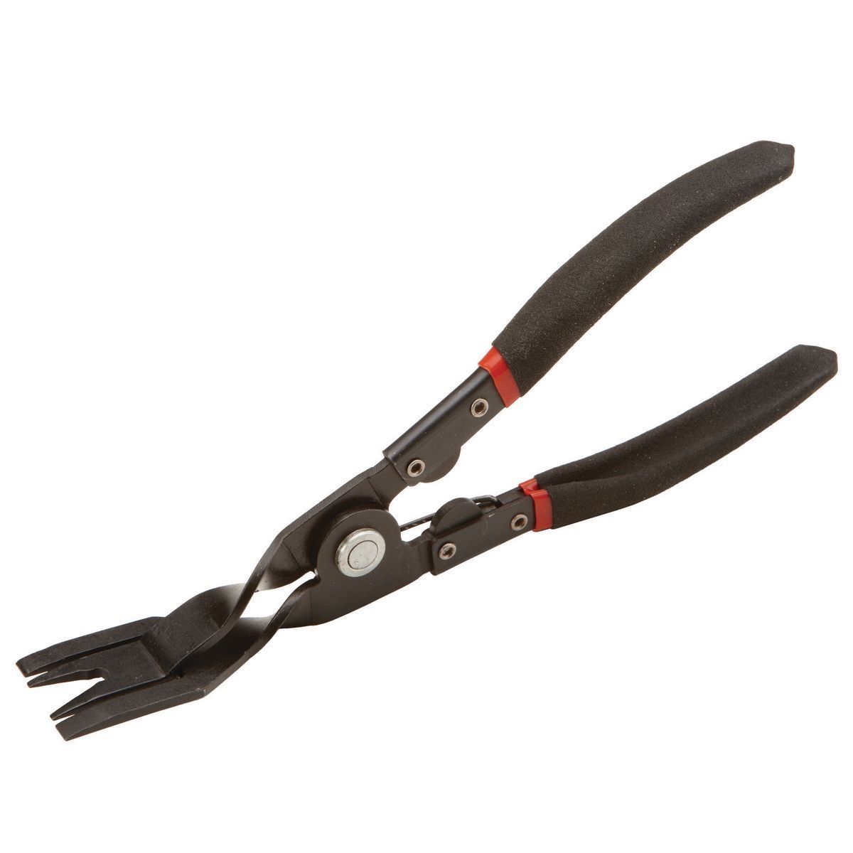

X2 I bet it is a regulator problem, but it could be caused by a seal. But to me that only makes sense if the issue was in both directions. So yes 1st to take the inside door panel off VERY carefully. This is a great time to break your door panel mount tabs. So get some of these Harbor Freight door panel pliers to help prevent that possibility. https://www.harborfreight.com/panel-...q=panel+pliers

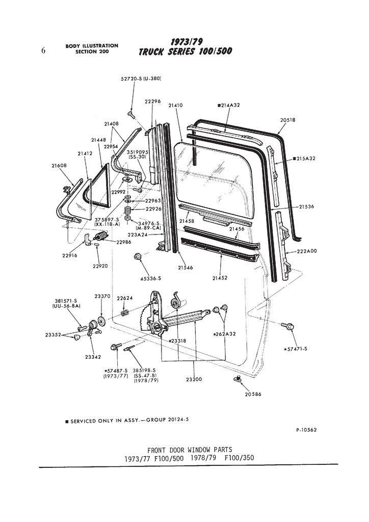

So with door panel off, look inside at the division bar seal #21546 and the seal #21536 at the back of the door. Are those seal tight in the track? Next roll window up and down and see if you can spot a binding point. Does the window twist or rock crooked in the tracks and bind up? Is so, I bet seals are toast.

Now before I would lube the regulator, I would clean it with some spray brake cleaner and see if it is gummed up. Then spray it with some white lithium grease. Then lube the metal trac at the bottom where the roller moves. Also check the roller #262A32, also check it for flat spots. Now if you do need to replace the regulator and it is riveted in, no worries drill them out, get the new regulator and bolt/nut it back in.
In case you really have to tear into stuff, here is the rest of the door parts.
