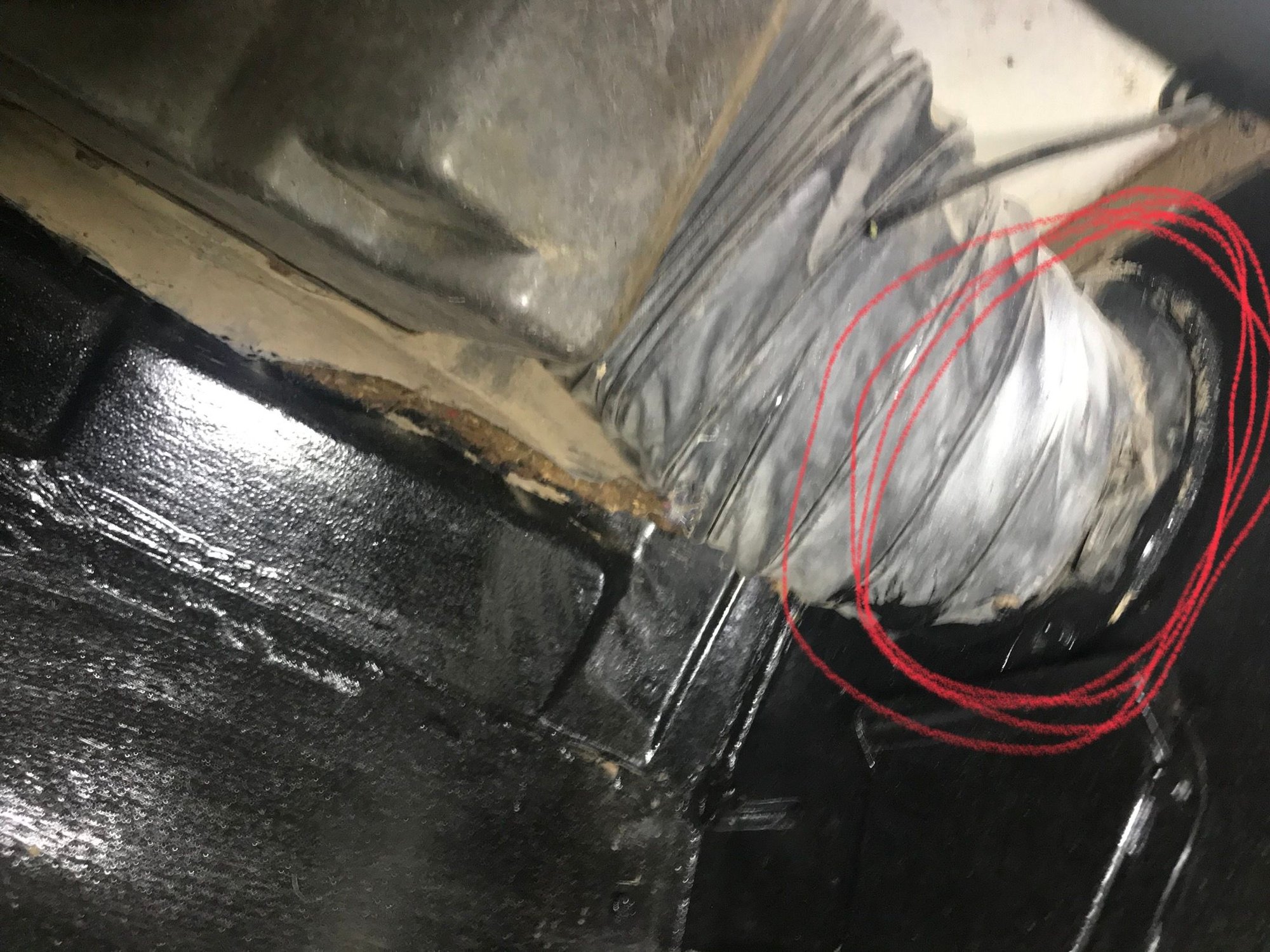

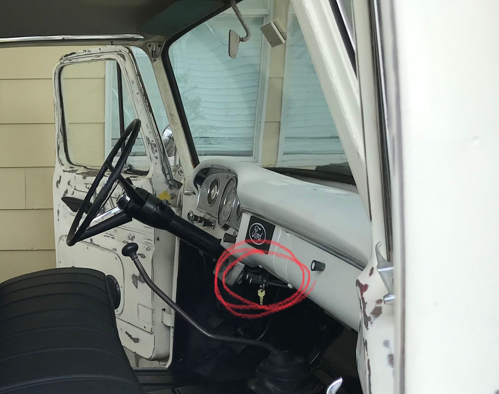

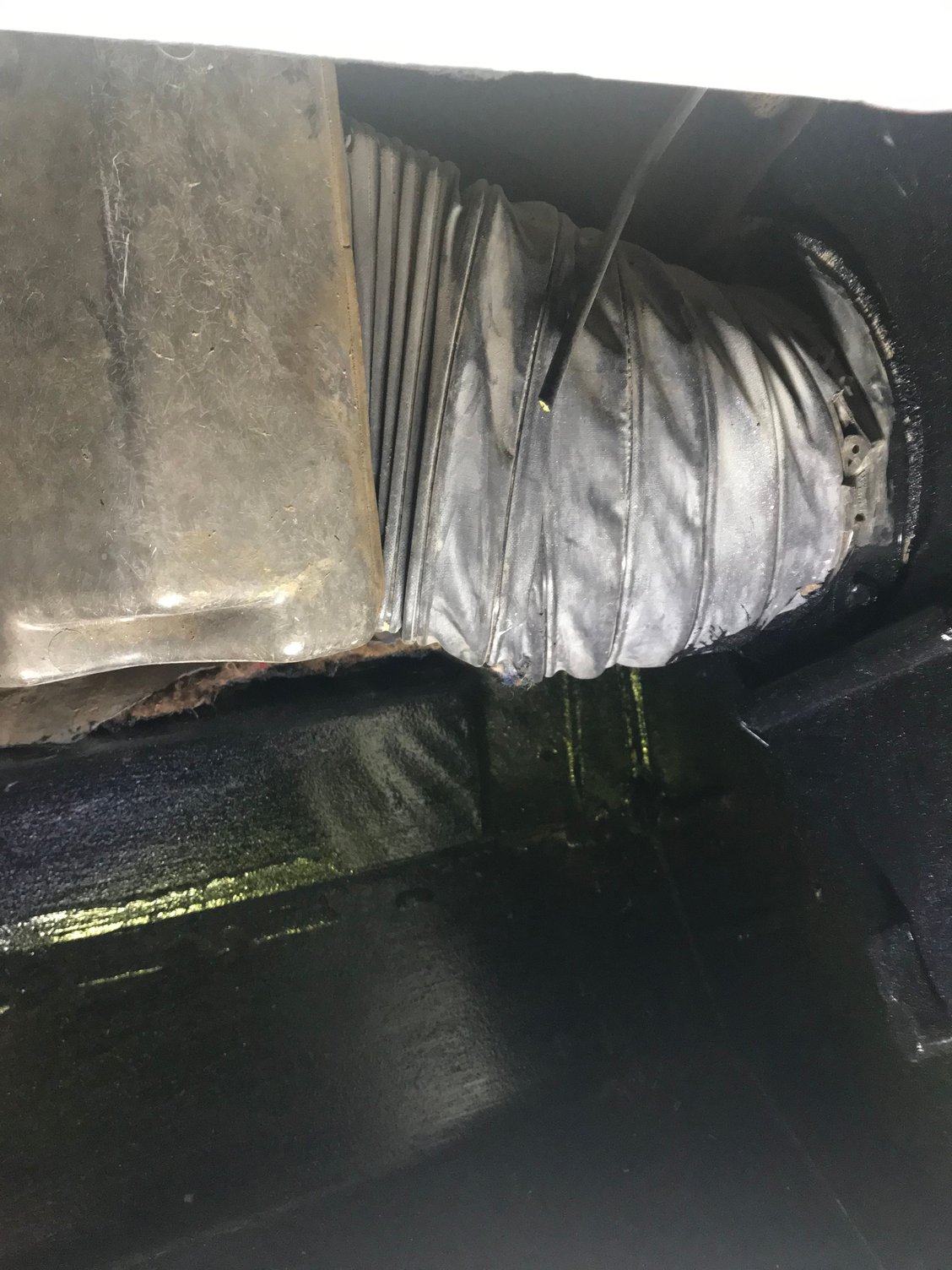

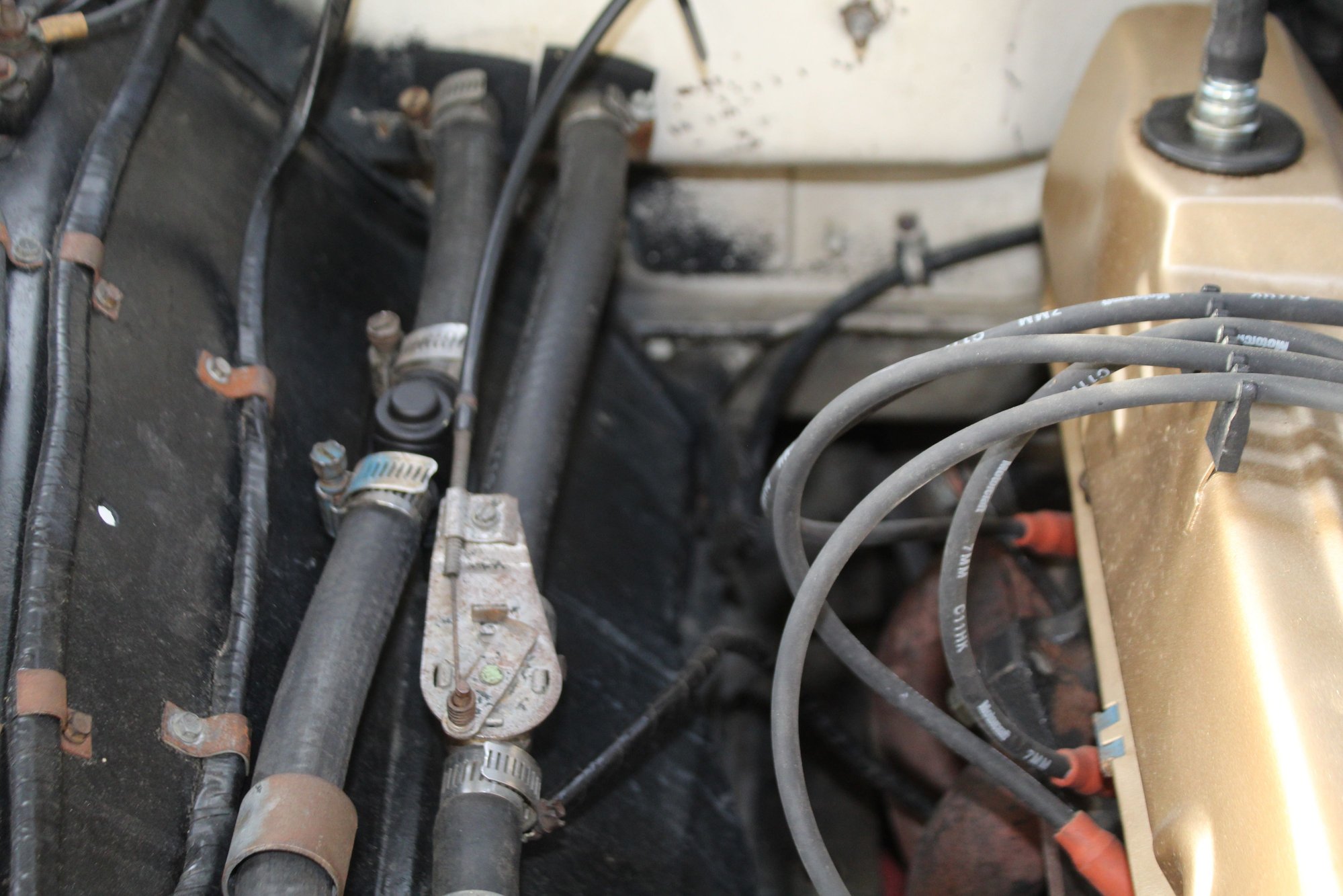

Ok…. I took some pictures to help on this.
this picture, it’s connected to the heater box and then to the kick panel part of the truck. What is it and what does it do? Is it letting hot outside/engine compartment air into the cab?
Old Sep 21, 2023 | 08:39 PM
Tom H So. Ca.'s Avatar
Tom H So. Ca.
Joined: Aug 2021
Posts: 274
Likes: 63
An expert on this system needs to answer this. But....
It should be allowing only fresh air into the heater box, not from under the engine hood. There may be a shutter/door to close it off. On my '62 the heater box is open to the cab. I have a vent door were your accordion hose connects to let fresh air in to the cab at your feet.
Might look at a parts list and see if that can be closed off with a control ****.
Tom

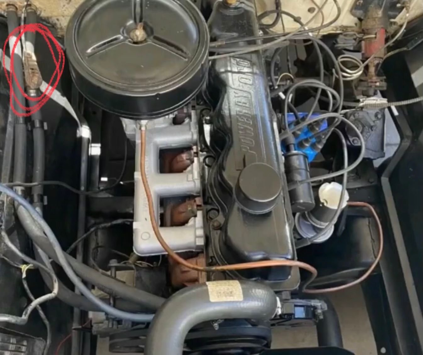

Snap, then post, some photos of the two heater hoses, where they come into the engine compartment from the heater core, please. And perhaps one or two of your heaters controls, as well.
Trucks that had the more ‘deluxe’ heater had a cable actuated valve in one of the heater hoses that could be operated via a cable from inside the cab. The budget one has to be turned either on or off , seasonally, by hand, from under the hood.
I seem to recall a member’s newly purchased truck, in which the previous owners solution to a bad heater control valve was to simply eliminate it. There was no way to turn off heated engine coolant from routing into the interior.
The control valve is frozen, I’m not sure if on or off. I’m going to remove the heater hoses and plug it off at the water pump.

66F250_4x4's Avatar
66F250_4x4
Joined: Dec 2019
Posts: 737
Likes: 159
From: Orange County
The two control rods in the cab should be: pushed in = off. Yours look like they are in the off position.
When the "temp" rod is pushed in, this closes the water valve. You should be able to determine if you're stuck open or closed by looking at the rod and cable position at the valve
When the "heat" rod is pushed in, it closes a big flapper in the heater box near the tranny hump. your flapper and control cable may be out of adjustment, or the foam gasketing around the flapper may be toast, allowing air to flow through the system.
I would sooner simply replace the water valve with a new one, than monkey with the hoses - I think that's easier and will keep that engine compartment looking sharp and correct.
You can get a rebuild kit for the gaskets in the heater box, if they are toast. The heater box comes out pretty easily. Take car of the square-to-round bellows on the air input to the box. That original style is
unobtanium

Be aware too that those valves can look like they are closed but after enough years the little flapper valve inside of them can completely rust away so even if it still acts like it is opening and closing it may never close because there is nothing left internally to close. I've taken off two of them that were not frozen open or closed but had no valve left at all. No way to turn off the heat once that happens until you replace the entire unit.

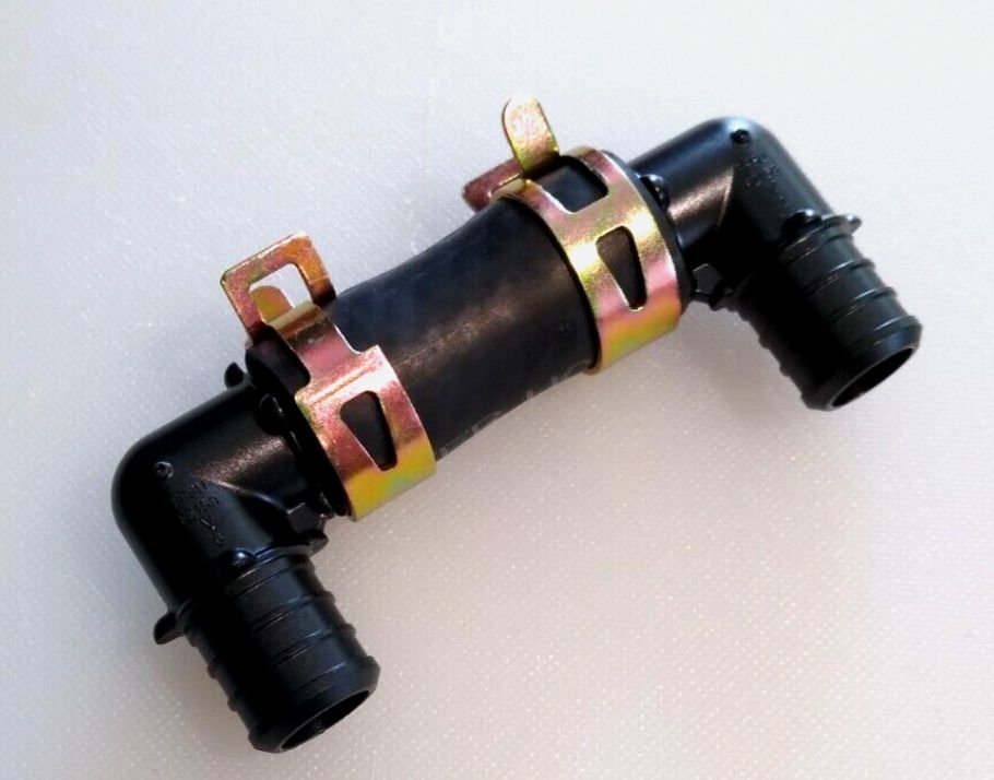

I ordered this. It’s made by Gates. I will pull the hoses off the heater core and stop the hot water from entering the cab.
I can then remove the heater box and make the necessary repairs to the entire system.

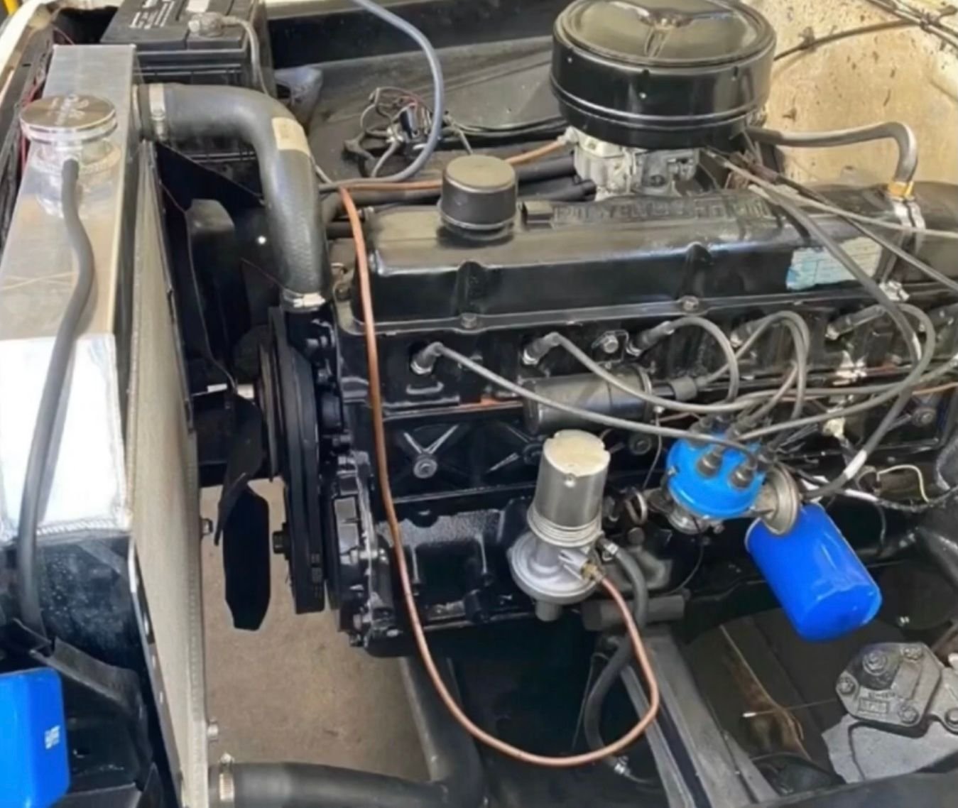

By the way, great clean looking truck under the hood!
