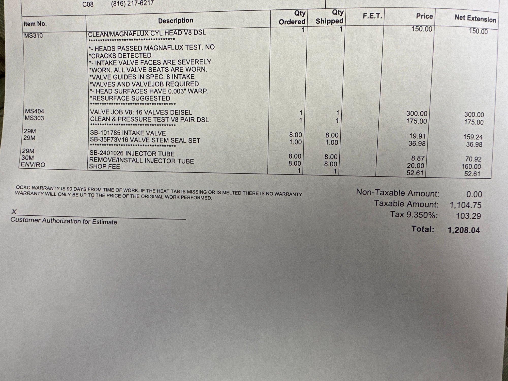

Thoughts?

Price seems reasonable. PSD heads take a beating too.
