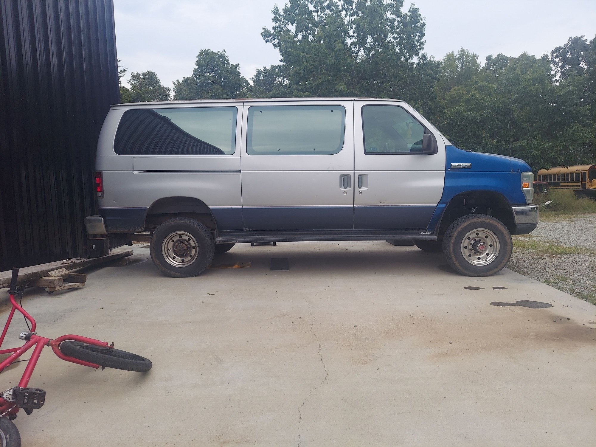

97 e350 4x4 conversion
I had some time to play so it threw an axle under my old van

I used a dana 60 from a 94 f350 dually i had laying around. For springs i used 92 f250 ttb springs. Everyone said that it would ride stiff but it seems run.

I used 4 inch blocks for the rear.

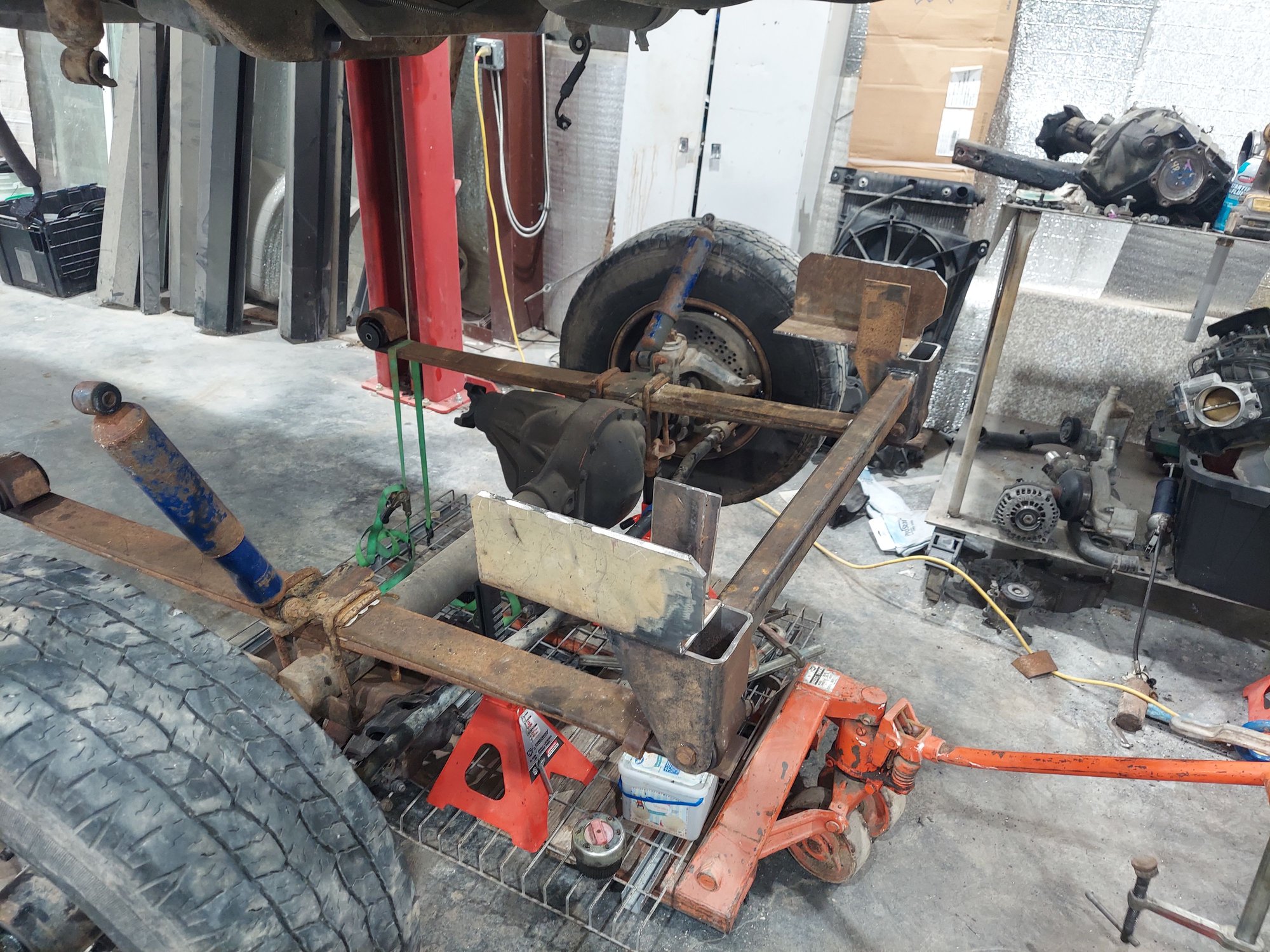

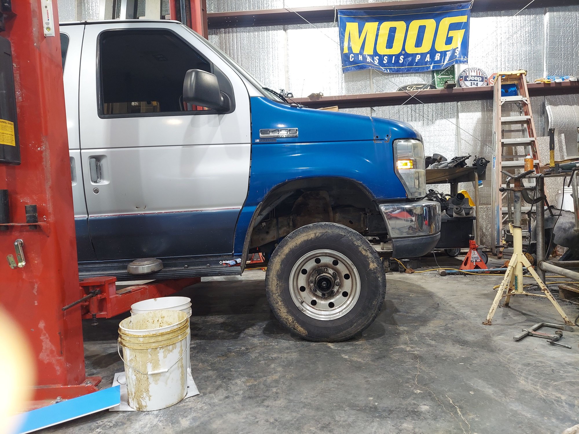

Heres a couple more pictures. Im still working on the shock mounts.

Towers cut off and frame cleaned up

Shock mounts are figured out.

Test fitting.
Welded up and some paint.

Suspension is done. It needs a track bar. Hopefully tomorrow I get on built and installed. Then later on I'll get the transmission and transfer case in it.

Heres one picture of the front hanger. I saved the measurements incase anyone needs them.
