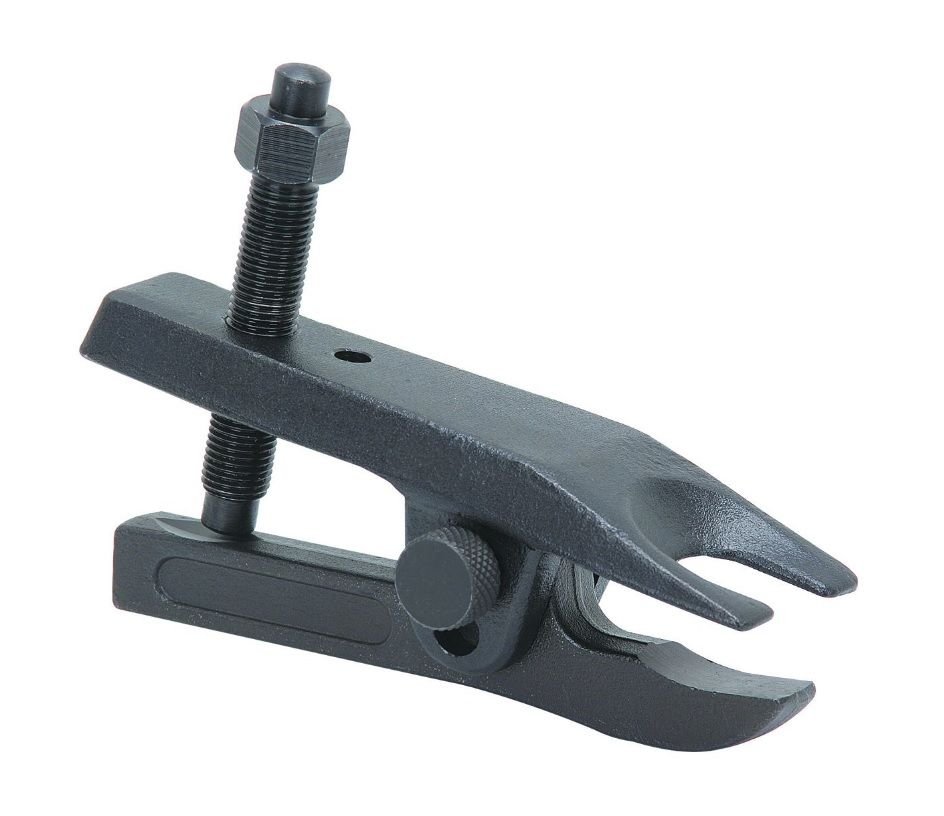

Doesn't look like there's much lip to grab surrounding the rusty nut, grinding may have to be employed, but if you get a tie rod puller in there somehow, you could put some serious pressure on the broken bolt that is stuck in the hole. Something similar to this is what I have in mind.
Image pulled from this on Harbor Freight.
https://www.harborfreight.com/3-4-qu...tor-99849.html
