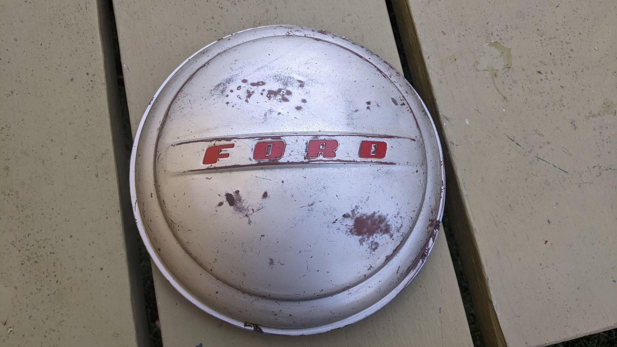

I am sprucing up my 54 for my upcoming Vintage Truck photoshoot. I've been cleaning and touching things up. Two days ago I decided to repaint my hubcaps.
When I fixed up and painted my truck in 1999, not knowing any better I bought a set of repopped stainless steel hubcaps. After more research about what was original I started buying good used steel hubcaps. Around 2004 when I had four good ones (kinda good ones) I had my body man knock out the dents and paint them. Then I had someone with a steadier hand then me paint the FORD letters red. They looked good but not perfect. Then after the fact I bought a set of red vinyl FORD letters. And those letters were in my basement workshop all these years.
So yesterday I bought a can of Duplicolor silver spray paint. On the way home I stopped at my friend's body shop to ask advice on what grit sandpaper to use. He told me of a guy in the next town over that runs a powder coat business. I called him, told him my situation. I said it's a long shot but can I have them coated by Sunday. He said he can do it. I drove right over there. Fortunately I gave him my number. This morning he called and said he started to blast one and underneath he found Bondo. Under the Bondo was dents and pits. Powder coating would not cover that up.
So I went and picked them up. Fortunately I had an extra hubcap. I sanded them with 500 grit and painted them today. Tomorrow I or my wife will put the letters on and then spray clear on them.
Cap with hand painted letters. Two of my caps had dings or scuff marks.
Half blasted cap with Bondo
My spare hubcap. It's solid with very little rust but has some dings.
It's a little better after some ball peen work.
I should have known my 4 hubcaps had Bondo by looking at the underside.
