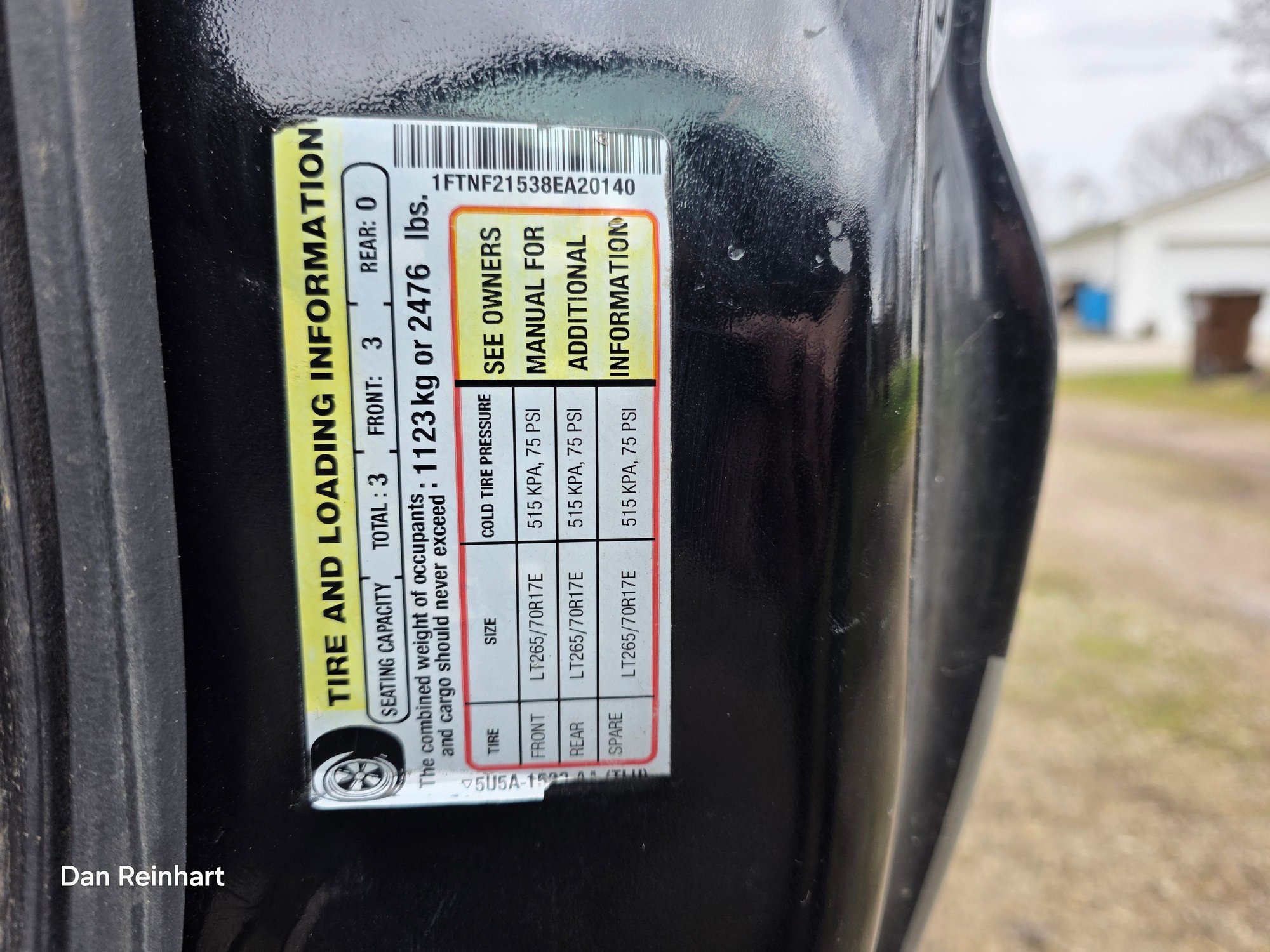

My truck came with LT265/70R17E that is also what my panel sticker says to use. and When you look up tires it only shows that size
My door sticker
I only changed it because the rims on the truck are so rusted and shot. I just couldn't find any rims to fit it till I went to Milliorn and found these.
Also I have never used a tool to program a truck LOL
The truck I got the rims off of is a 2008 250 SD but it came with the 20". Here is the door sticker.
