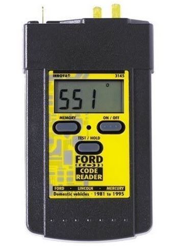

Break down & get one of these, either at one of the chains or online & save the frustration, $25-$35 bucks.
Good luck

Ford OBD I code reader on order.

Got the code reader like Scndsin's. Codes are; 56, 32, 67, 82, 91, 92, 94, 93, and 99. When it started repeating codes it got to the third one, 67 and stopped - just displayed 67 for several minutes. Repeated the test again and got exactly the same results-that made me feel that at least the test was legit. Can the reader only handle 12 codes at once?
Now I'm really confused. I've got a Chilton's, the Innova manual, and an online code list Ford OBD1 Codes List (Free Download PDF) - OBDCODEX. Of course they don't agree most of the time. The online seems more accurate. For example, Chilton's says codes 91,92,93,94 and 99 all have to do with E40D transmission - I have the C6, so I'm gonna ignore those for now, the trans seems to be working fine.
Code 32 - "EGR not responding properly - EVP" Also mentions EVP, EVR, and PFE I have the EGR blocked off, with the wires still connected, so assume this code is from that. No idea what EVP, EVR and PFE are.
Code 56 -"Vane Air Flow (VAF) on Mass Air Flow (MAF) sensor high" I'm gonna attack this first.
Code 91 - "System running lean-Fuel Control"
Code 91 - Transmission solenoid problem"
Code 92- "System running rich-Fuel Control"
Code 92 - "Transmission solenoid problem"
The trans is working fine, any idea why I get running lean and running rich at the same time?
Any better place to get code interpretation?
Thanks, Bob

A 94 F250-5.8 really, REALLY ought to spit out 3 digit codes.
Do you know anything about the computer? Ever seen the label on the connector?
Does the calibration code on the door frame still exist?

That exact Innova scanner can and will spit two AND three digit codes. It's just the way the scanner is set up. An example is an 11 code which means the system passed. As for the transmission part of things check your sticker in the door. It should give codes. An example is a truck with an E4OD factory will have an E under transmission.
