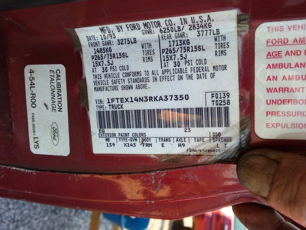

Scindsin - I got the exact reader from Innova that you suggested, and it spit out the codes I listed above.
What does "calabration code" look like. The tire info etc. sticker is still there. I don't see anything about a calibration code. Trans code G.
OB - Trans Code G -3 speed auto without overdrive - so C6.
The codes seem oddball to me - 91=lean; 92=rich; referencing the wrong transmission, stopping before completing the second round. I changed out the MAP, no change. It died on me and before I shut off the key I heard the fuel pump running constantly, which I read is a symptom of failing ECU. Any definitive symptoms of a bad ECU?

Should be on driver's door frame, far left here:

Mine does not have that sticker - it does have a shiny spot where a sticker was. I'll pull the ECU this AM.

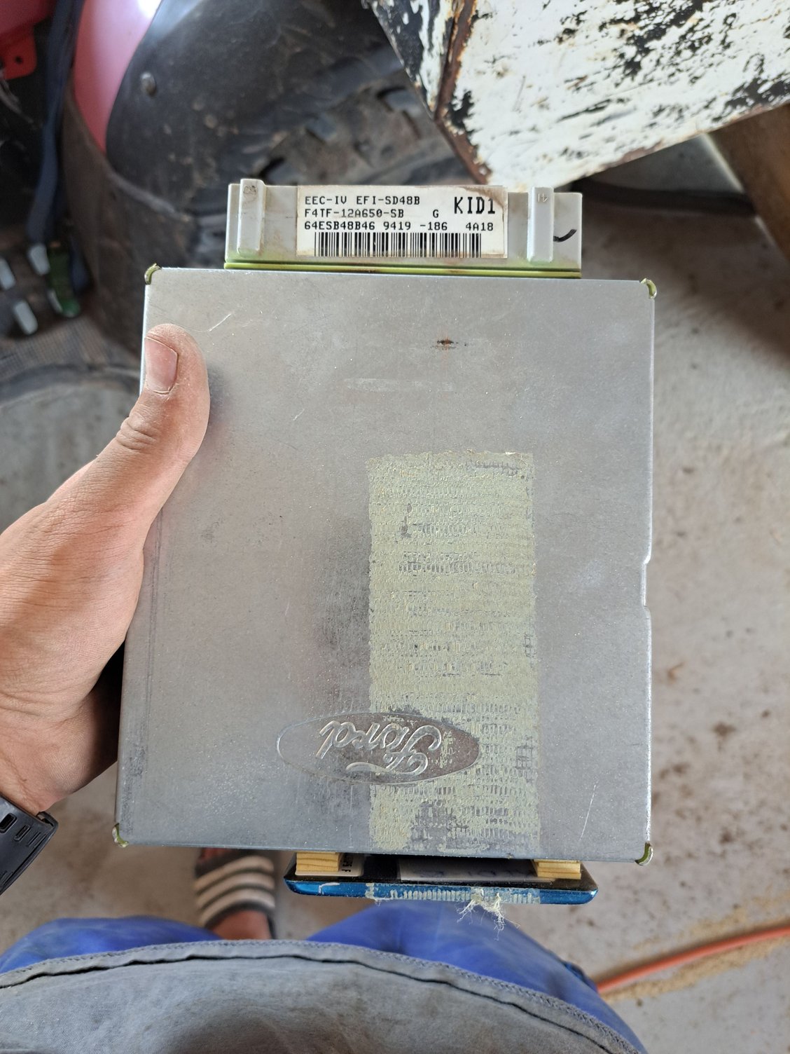

So I pulled the ECU and it looks like at least one capacitor is bad.
Any place better than others to get a ECU? How do I figure out the correct one if this one is wrong?

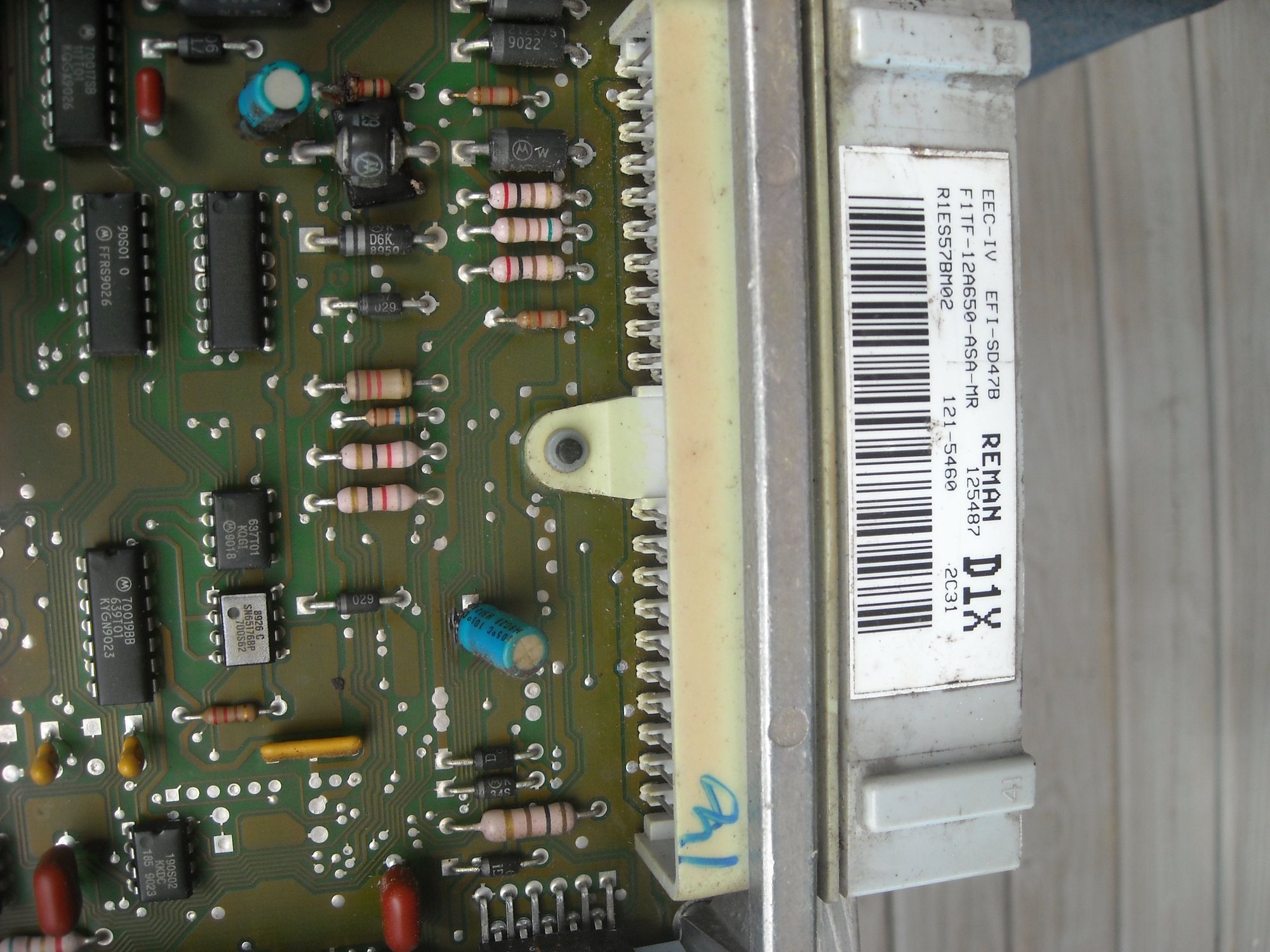

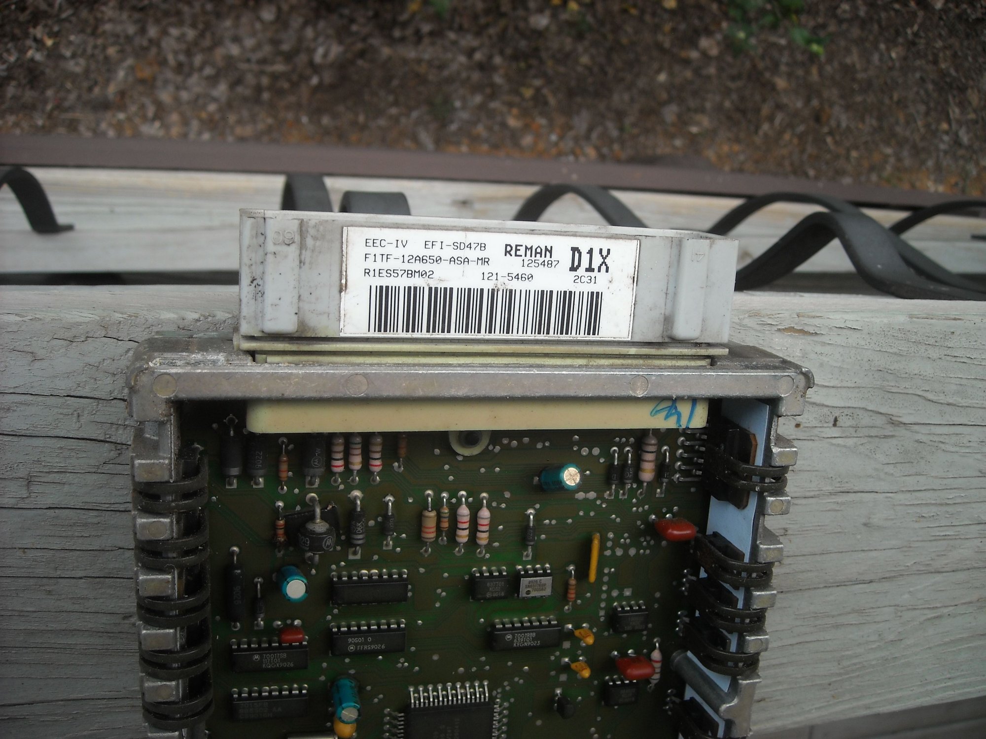

THE D1X is a 5.8 computer from a 91. I imagine if you open it you will find it is damaged.
Even if it is in good shape it will not get along with your harness and components in your 94.

F1TF is going to be an engineering # for a 91 truck.
The computer is wrong for a 94 anything.

Take that code and write it down. I got my PCM from "The ECU Connection" in Colorado Springs, Colorado for like 240 I think. They had mine on hand and MIGHT have yours. Worth a try if you're interested. Bad capacitor can definitely cause issues. I can't guarantee it's going to fix everything but I could be wrong and it definitely is an issue.
Old Sep 17, 2023 | 11:54 AM
  #29
OBSession05's Avatar
OBSession05
Joined: Jul 2023
Posts: 991
Likes: 317
Sorry TNBob I wasn't looking closer at your post. That second line of code under the "EEC-IV" is the code you need to look for...unless it's the wrong computer for that setup but could be wrong. Go ahead and search it up to see what you find. A used one is an option but you'll have to go calling local junkyards. Luckily this part is small enough to ship so it could be from anywhere in the states.
