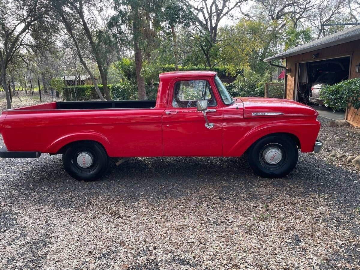

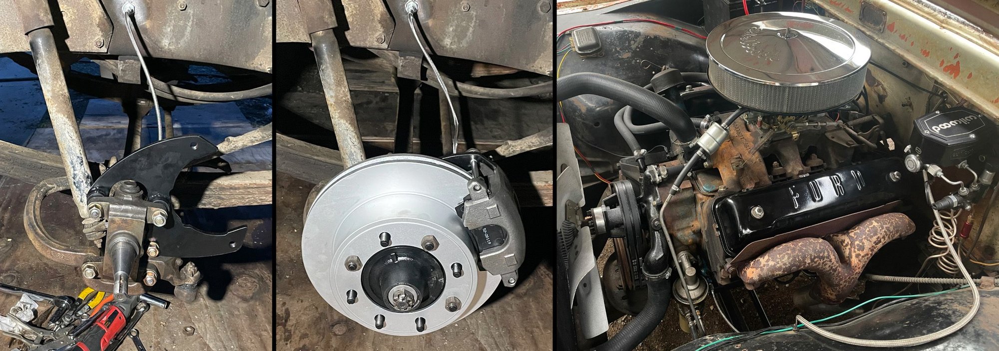

Nice Truck! I have a couple 62's and a 64 F250. On the 64, I am swapping the rear end from the stock 4.56 to a 3.73. Should be a good middle ground for towing and freeway speeds. On my 62 F100 I am doing a T5 behind the Y Block and keeping the 3.73 Dana 44 it came with. I am lowering that one about 5" all around. I opted not to flip the axle. Just doing hangars and shackles and 3" lowering springs from Posies. I have installed a front drop axle from Sid Drapal at www.droppedaxles.com He has everything you need to do the lowering. Personally I don't like how the CV swap widens the track and limits the original type wheel choices. If I were going to ditch the straight axle I would go to a Jag front end.... I think it is a more elegant swap. For now, I'm keeping the straight axle and staying old school on that. If you keep the straight axle and 250 hubs TSM Mfg in CO has a nice kit. https://www.tsmmfg.net
1964 F250 TSM Disc kit w/Wilwood MC

My 62 F250... It will have to wait until the F100 is done!

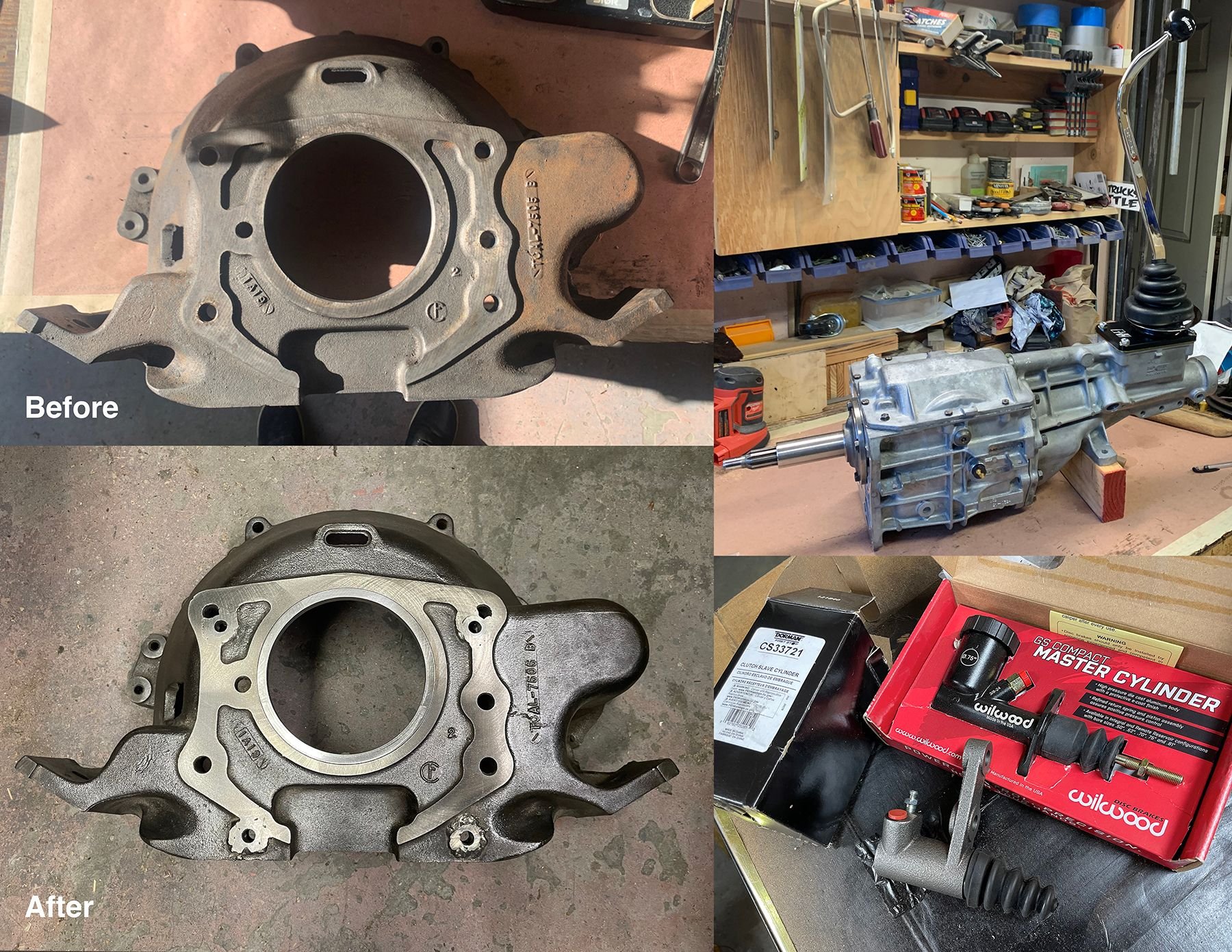

I had John Mummert in El Cajon CA rebore my 4 Spd bell to accept the T5 properly. It depends on what year T5 you use, but MDL (Modern Driveline) does adapter plates to do the same. Im going with a hydraulic clutch as my power steering setup interferes with the factory Z Bar.
86 Mustang GT WC T5, 4 Spd bell housing
68 Dana 60 with 3.73 gears and TSM brakes
