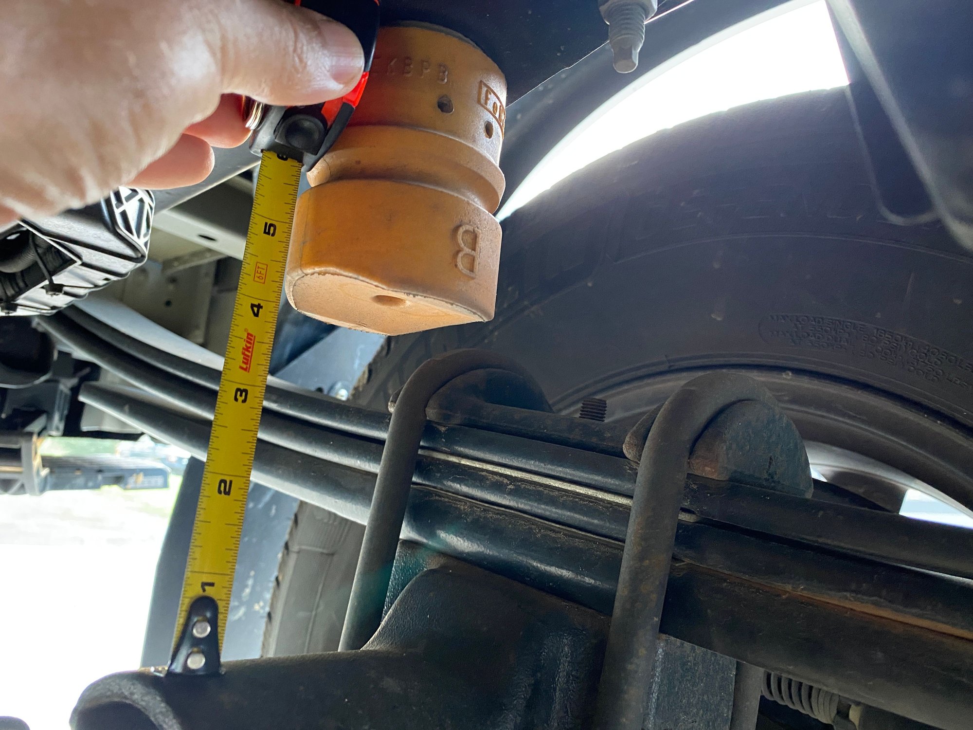

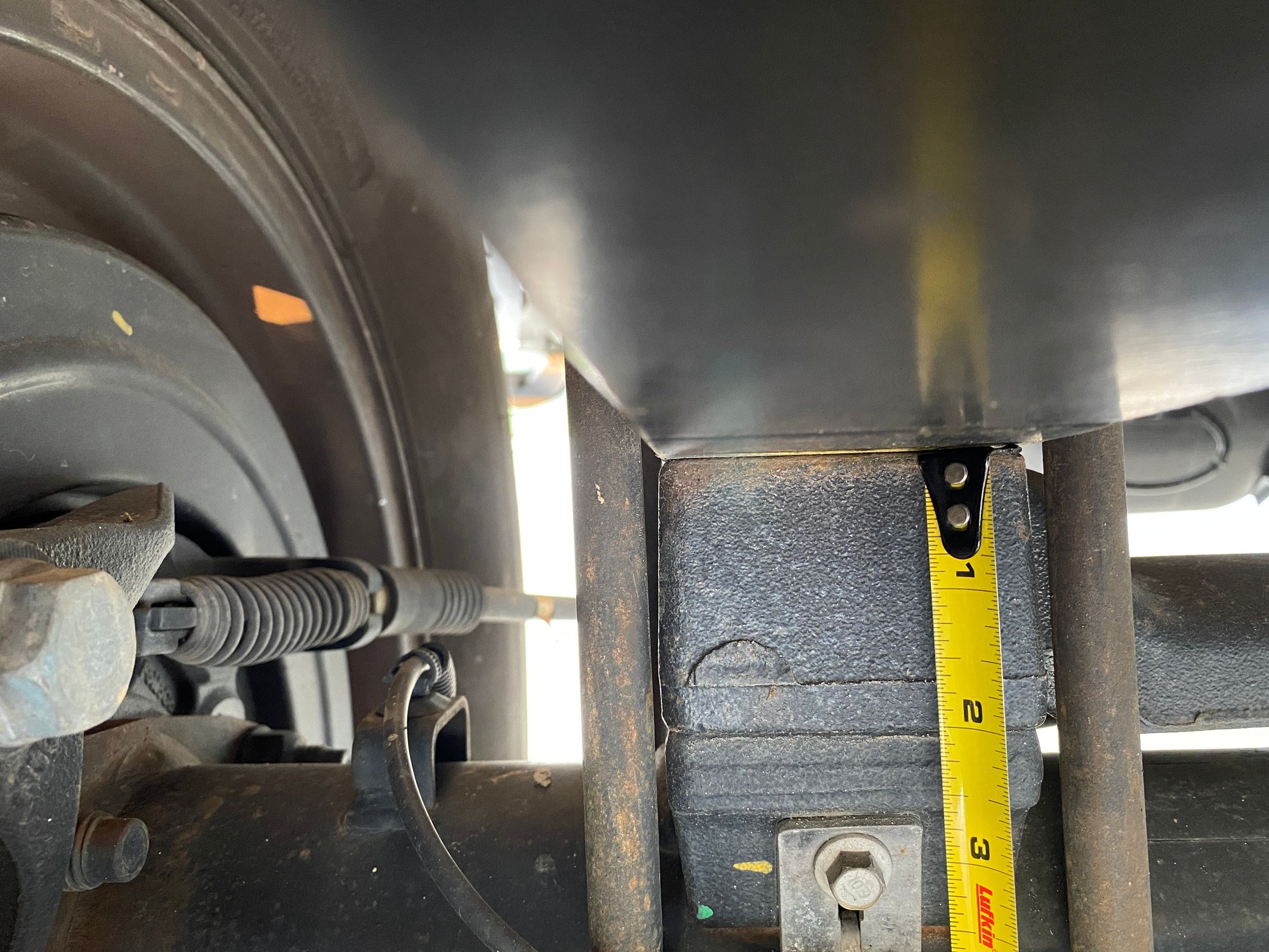

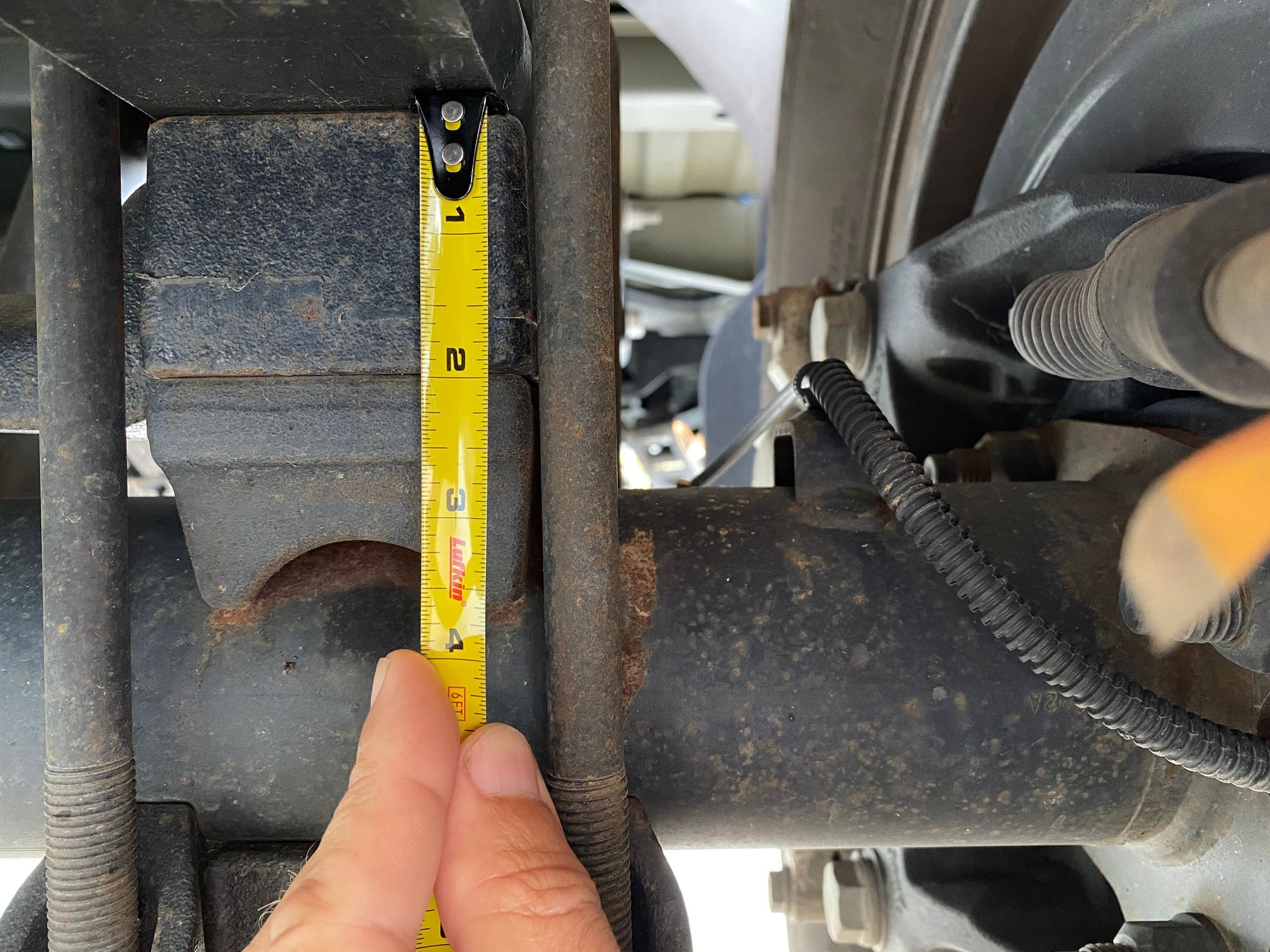

Old Sep 7, 2023 | 06:58 AM
number9xd's Avatar
number9xd
Joined: Jul 2011
Posts: 810
Likes: 494
Truck details in sig.
Front of the block 2”
Rear of the block 2”
And just because I was already there, about 4-1/2” between bump stops

Thank you for those very helpful pictures!
