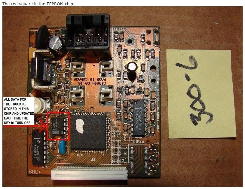

Oh! The PSOM manages the mileage on the odometer? I didn't realize that. Shoot. That bugs me but at least now I know. Maybe I should just open the PSOM and fix it up.

You can reprogram the mileage through psom? I thought that was through the PCM / computer?
I might need to replace my psom soon and am worried about mileage if that's the case. I've also read that there are only 6 reprograms you can do of the psom.
@OP, did u fix issue?
Old Sep 11, 2023 | 07:06 AM
Scndsin's Avatar
Scndsin
Joined: May 2006
Posts: 12,343
Likes: 1,318
From: Central Mississippi
...PSOM...
The ONLY reprograming you can do (designed to do) is TIRE size. 6 times.
There are other electronic programing methods as per all EPROM type chips which you can research else where to change mileage.
There is physical removal/re-soldering of chip.
