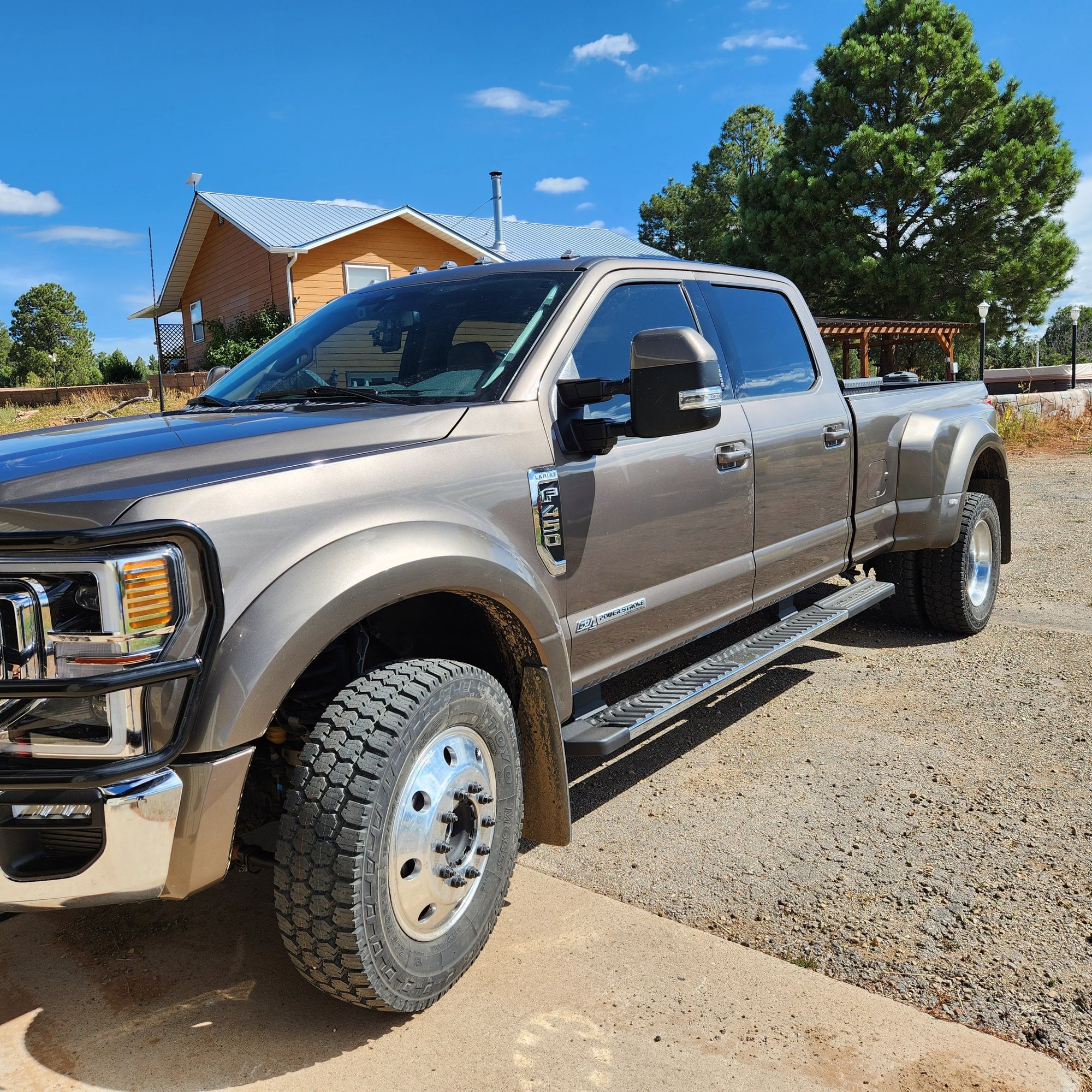

Toyo M655 balancing problem
Centramatic experts; I just replaced the Continentals (terrible in winter) on my F-450 with Toyo M655's. I elected not to balance the aluminum wheels, figuring the Centramatics would do the job for me and I would prefer not to have weights on them. Now the wheels are not quite balanced; feels like a front wheel. I guess I will go back and have the aluminum wheels balanced; asking for stick on weights, but why don't the Centramatic balancers take care of this? I figured Toyo tires are good quality and did not expect this problem.
Last edited by Y2KW57; Jun 7, 2025 at 04:57 PM. Reason: Thread title change, per OP request
Popular Reply
Jun 7, 2025, 12:53 AM
scottz99's Avatar
scottz99
Veteran: Navy
Joined: May 2014
Posts: 949
Likes: 330
From: Colorado Rockies
Looking at some old threads, I realized I never posted the final solution to my tire issue. After all the time everyone spent helping me, you deserve the rest of the story.
I made two trips to the tire shop where they made multiple attempts to balance the Toyo’s. One of the managers came with me on each test drive and agreed there was a still a problem. They finally asked me if I would be willing to drive two hours to one of their other stores that has new equipment including a road force machine. I agreed to do it. They guys at the “new” store put all the wheels on their road force machine and concluded “these tires will never balance”. I had the numbers but have since misplaced them. I made sure these guys called the original store and reported their findings.
Back to the original shop; they said “what do you want to do?". My response; "what are you going to do?". We ended up pulling the Toyo’s off and returning them. I bought a set of six Roadmaster RM257 tires (in the correct size 225/70R19.5 G) for $1500 less than the seven Toyo’s (one of my Continentals back on the spare). These mounted and balanced much better than the Toyo’s.
I still had a slight hop above 75mph, but, since I seldom drive that fast, something I was willing to live with, especially after spending four days in a tire store. I was almost convinced I had a drive shaft out-of-balance.
I have run the Roadmasters for 18 months (including a trip to Yukon) and I’m happy with them.
In Sept, 2024 I was at a good brake & alignment shop to have the 5th wheel aligned. They seemed to be quite competent so I asked about the high-speed hop. After a test drive, they used their on-vehicle balancing machine to spin up each front tire and found the problem; the right side started hopping when it came up to speed; not quite round. This shop still has the equipment and expertise to true tires (not many shops can true tires these days). They trued the right front tire and solved the hopping at high speed.
And that’s the rest of the story.
