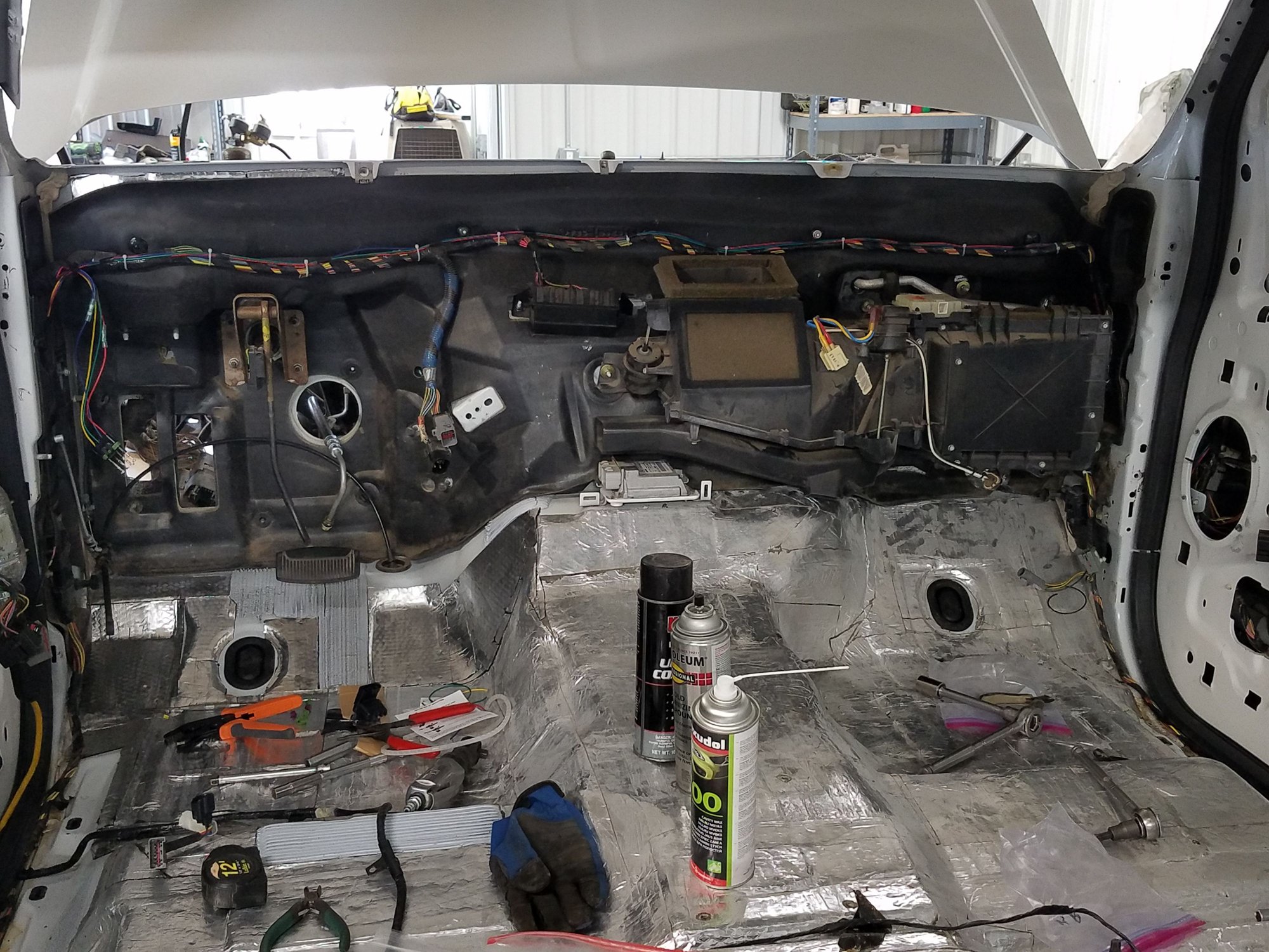

After that....pretty easy. Rip the 5.4 dash out, all the wiring harness', install the 7.3 harness and dash. The door harness, you have to take the door panel off and unhook everything in the door and then extract the harness from the door.
It's not that bad really, a little careful cutting on the firewall, some welding....heck you could probably overlay it, some seam sealer and pop rivets...good to go.
It's also a great time to sound insulate the firewall.
