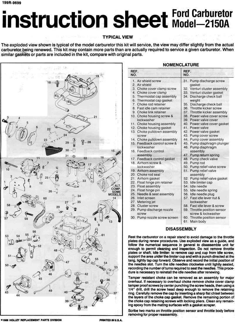

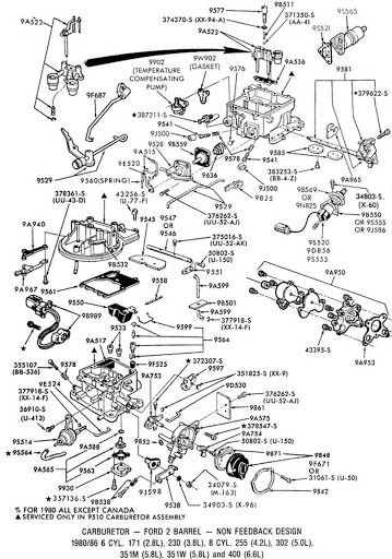

Sounds like great advice above, what carb exactily? Looks like a stock OEM Motorcraft 2150 2 bbl in the other thread where you posted a picture. Welcome to all three of you to FTE, check your visitor messages and PM (private messages).
Yes 4bbl below but more for FYI.
