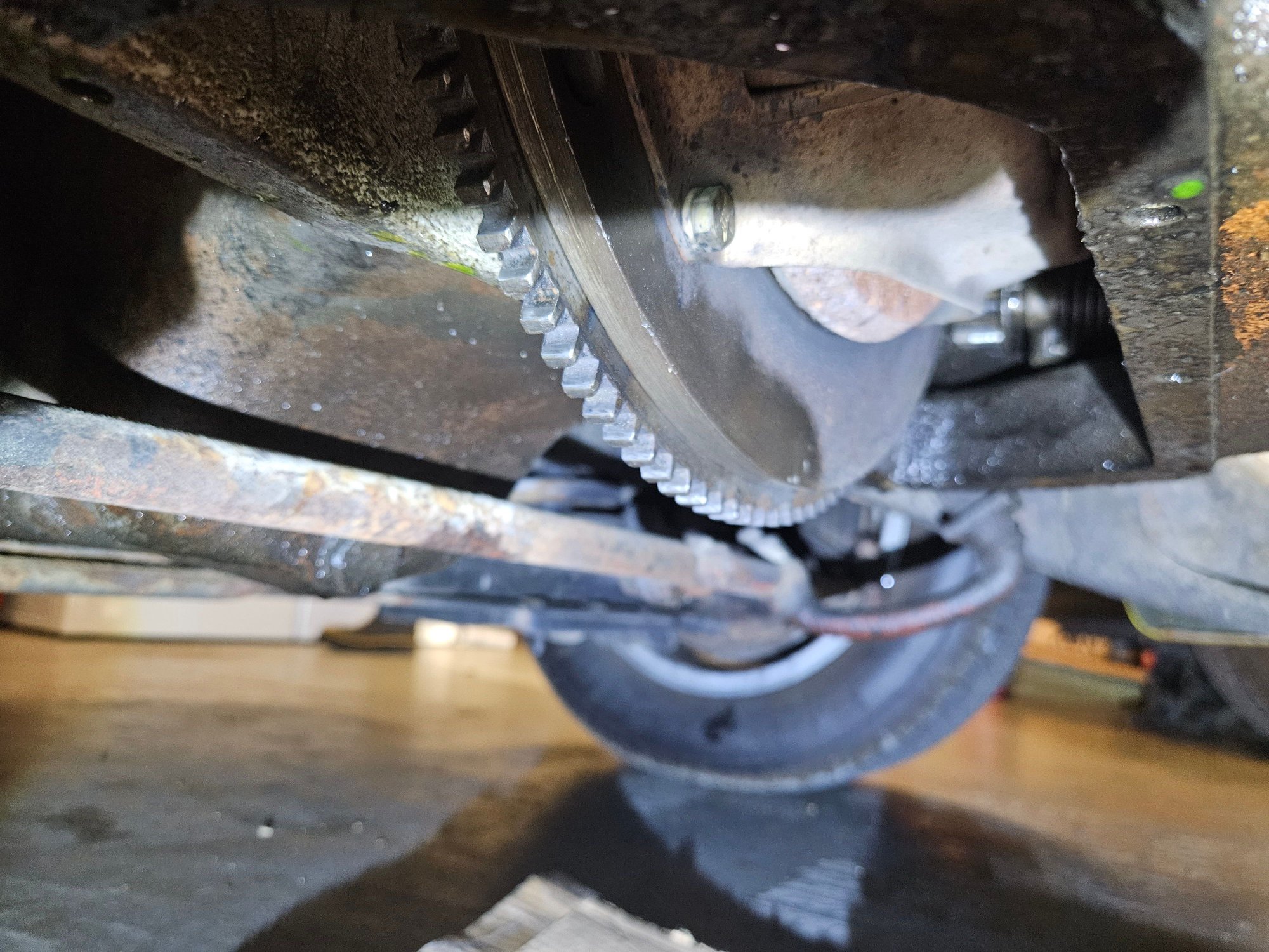

Wipe area down with cleaner of sorts and hit it with clean stiff wire brush.

On closer inspection, to my novice eyes, I'm not so sure this flywheel looks healthy. Thoughts? ***Edit*** The part on the back of the flywheel that looks like it's chipping off near the edge is actually just grime.

Being out in the open it will combine potential leakage from rear main and road grime to make an undesirable coating.

I agree that the latest picture seems to be caked grime. Like others have suggested, a good cleaning would be revealing.

A wee drop of Dawn, , some brushing, and grime cleaned up a little. Enough to tell it's not cracks.

clean it then rub chalk on it then wipe it off with your finger, if a line is left behind it is a crack if not then it should be ok. done this to an engine block before on my minibike chopper.

I dug out my Mercury and Ford Car documentation and if you have a 51/53 Mercury or 52/53 Ford 239 from a passenger application, the cover part is 1CM-6409 and is mounted with 9 bolts measuring 5/16-18x1/2 with split ring lock washers. Unfortunately, these are more often missing than available.
