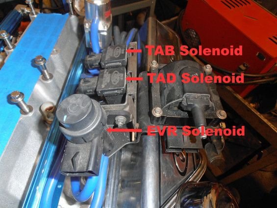

Old Jun 9, 2021 | 06:08 PM
My4Fordtrucks's Avatar
My4Fordtrucks
Joined: Jun 2015
Posts: 12,838
Likes: 2,437
The bypass and divert solenoids are mounted on a bracket by the driver’s side valve cover.
