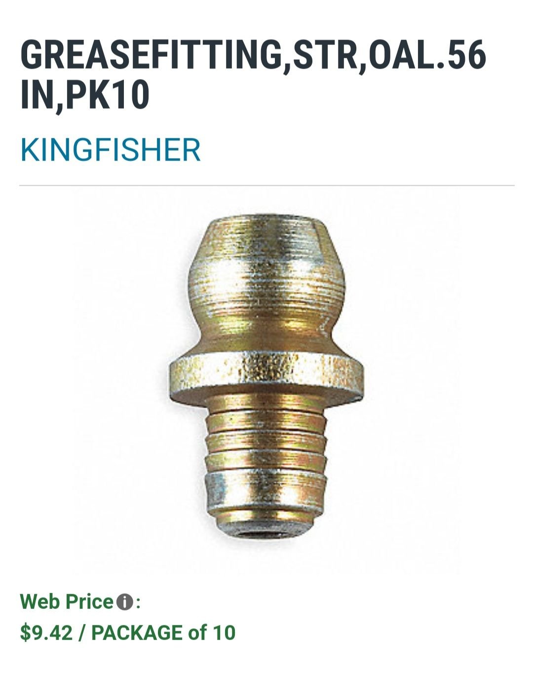

Originally Posted by Jmcx1969
The lower ball joints will fail first without greasing. Mine started to seize up at around 60k. Audible squeek while turning. I bought some of those hammer in zirks and it's still good now at 270k
Hammer in zerks? Never heard of such a beast. Is there a blanked off opening where they get installed? I'm old school when it comes to greasing joints
@Jmcx1969
Like these. You just drill a 3/16" hole and pop them in. With the wheel off, the lower ball joint was easy to do.
