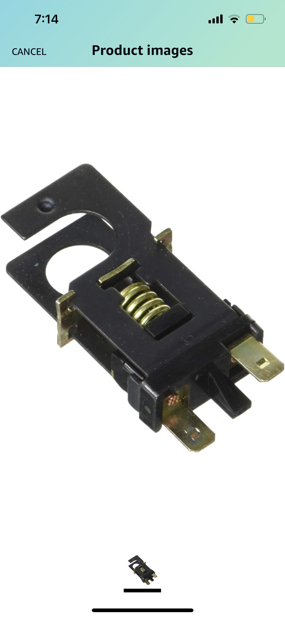

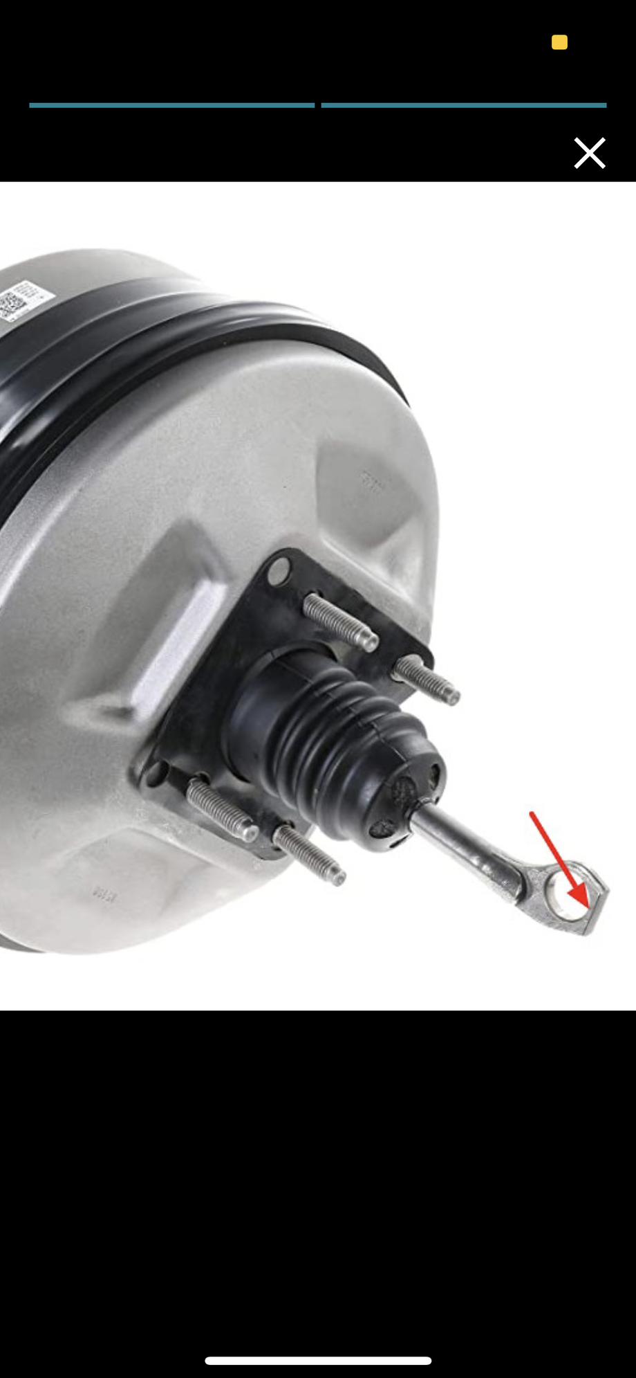

Hissing noise is likely brake booster. When you push down on pedal it pushes rod in and pressurizes the MC. At that same connection point it also activates the connection for the brake light switch. How does the tranny shift? The brake switch directly affects Torque converter too. Due you have a the “brake” indicator light on the dash?
Booster. This is where it connects to the pedal.
Switch. This is connected to the pedal at same point as booster.
