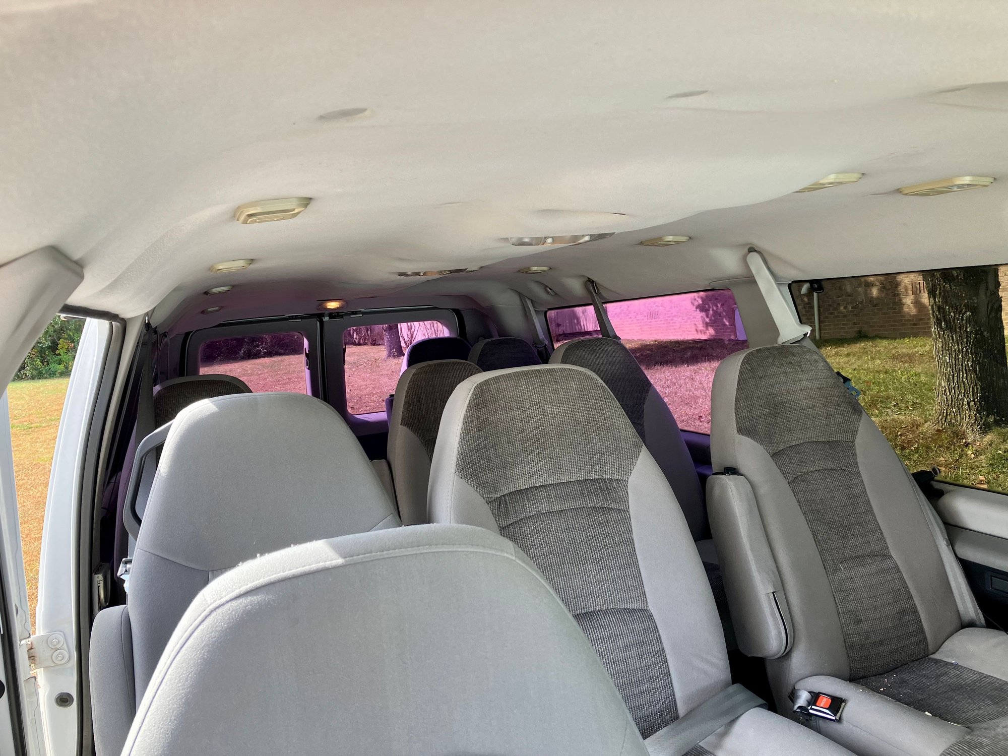

Another option is commuter van seats but the mounting points are a lot of work. This is our van which uses standard passenger van outboard shoulder belts.
