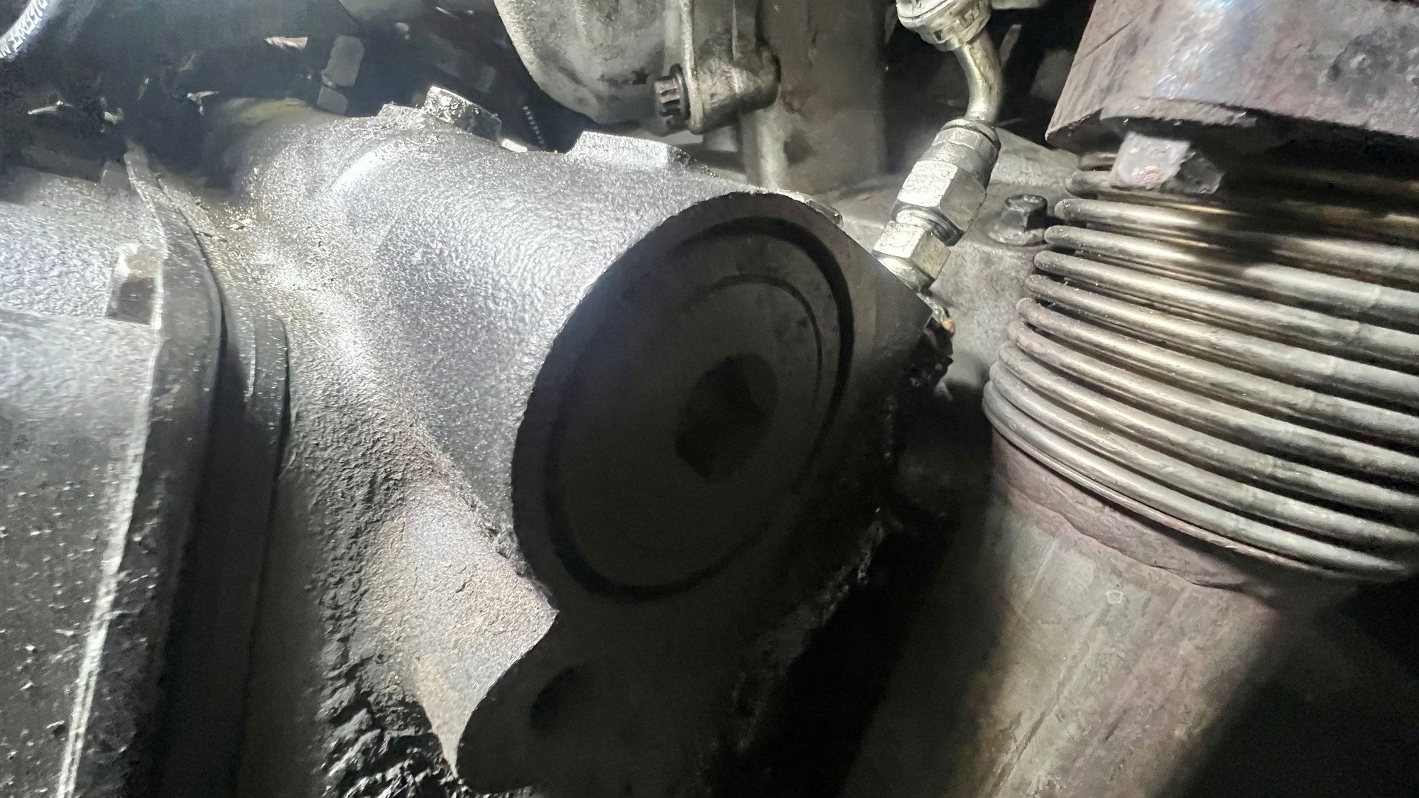

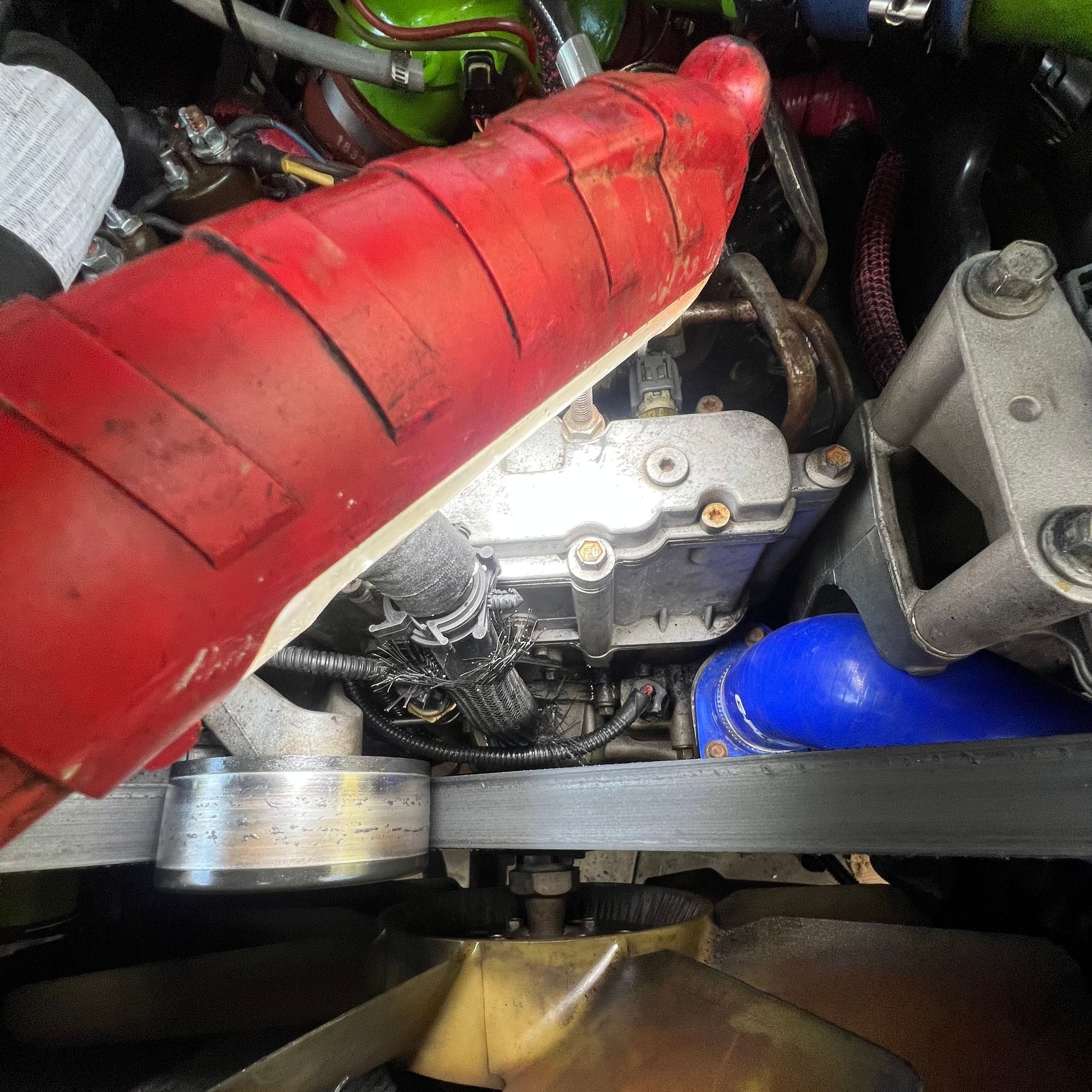

I have a 2000 F-250 7.3 and I’ve recently been having a a leak from the front and back side of the evince. Could it be the Hpop o-rings and h-pop gasket? Previous owner did put a lot of silicone around the oil pan but I don’t see major leaks around the area
Oil in back side drips down on driver side . Oil cooler from a glance looks dry, not wet from any oil. I wouldn’t want to say it’s the turbo pedestal bc I had replaced it last year to a non-Ebv. I made sure the o-rings went in right and not missed it
On the front it drips down and gets all over the lower radiator hose.

Appreciate all the detailed pics! Crosses off a lot of possibilities. Looks like the oil pan ain't gonna leak any time soon.
Please do the same in the valley up top. Given the volume of oil you may need to clean up some before finding the source.

^^^What David said. It looks like drainage from the valley out the hole in the back of the valley.
