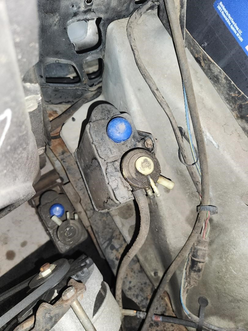

Ok guys, she came right off! No bolt breakage!
But I notice these. Can anyone tell me what they are? They dont appear to be tied to anything.

More emissions junk. looks like you're deleting all of it so they can go.

Do not trash can those emissions parts, (the blue capped thingies), those are charcoal filters and can be needed by some people.

[QUOTE=77&79F250;20943876] (the blue capped thingies),
Vapor canister

Your fuel tank vents into them. People label them as smog junk when they don't understand the system. They just store your fuel tank and carb gasoline vapors and when at operating temp and correct vacuum level {cruising, no load} the vapors are drawn into the intake manifold and burned by the engine. You must have all the components in place and operational. I doesn't require any HP. I as well as many were confused by all the hoses and valves of the day and just started pulling the systems out. But X3 on saving it.
