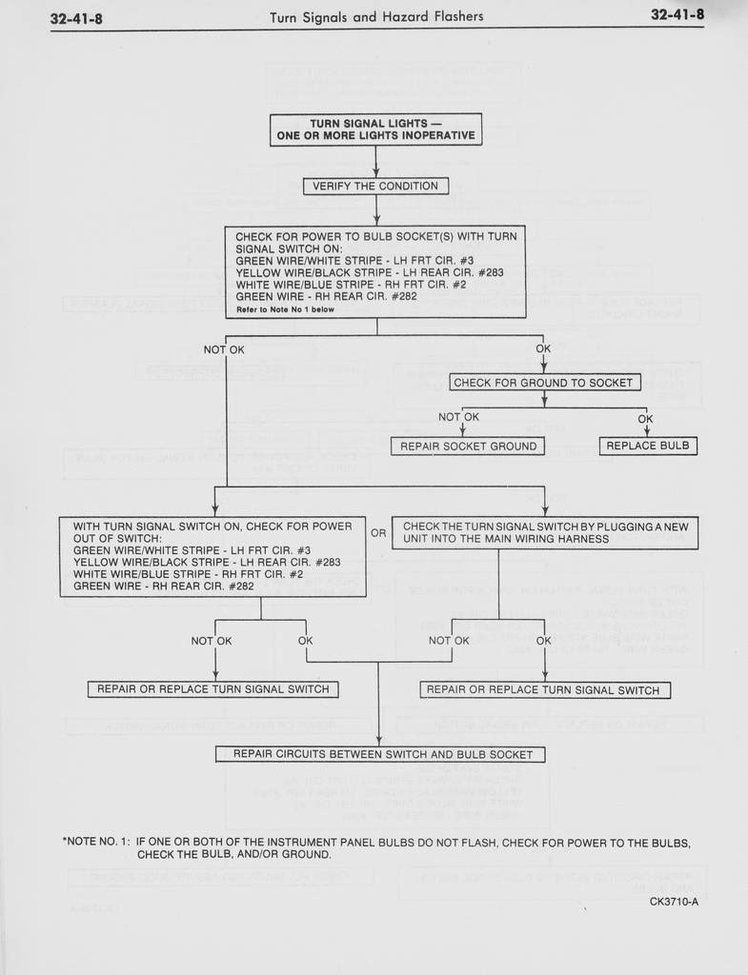

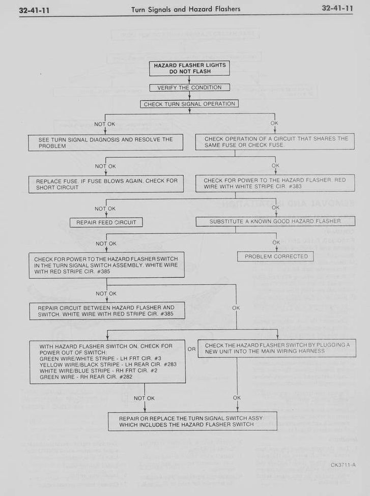

As I was going through the testing protocol in those documents, I realized my fusebox is different from all the 1978 f250 fuseboxes references I can find. The previous owner of my truck swapped in a 460. I wonder if they used the wiring harness/fusebox from the donor vehicle. If so, I wonder if there some wrong wiring given the weird occurrence when I put my flashers on and step on the brake.

Interesting! So that makes me think this green highlighted path is working as it should. Basically when I put my foot on the brake with the hazards switch engaged I get power to my brake lights and front lights, and guessing the way it's wired makes it so the flasher doesn't flash. That leads me to believe there's something going on with this other path--the Red/White wire (#383). Not sure how to check that. Maybe I'll check the fuses first to see if any of those are blown. If not, then maybe I need to replace some wires between the fuse box and the flasher.
