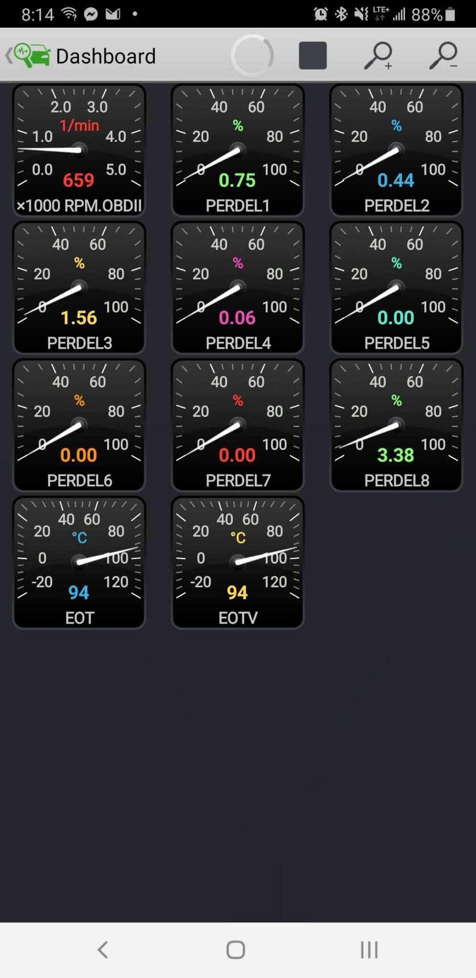

I took PERDELs this morning once I got to the office. When i stopped at the light after my interstate ride, i saw some low 4's on #8 and once I got to the office it was down in the high 2's and then back into the 3s after a couple of minutes. The DTC did not trigger. I also took a video of my cold start and idling just for reference but my cell signal at my desk is not good enough to upload it so I will do it later. Not sure if it'll get the message across but might be clear enough by the sound that it's running well.

I guess the 5% threshold to set the P0308 is something from the rumor mill. I had to run an errand so I left work and did that and drove home to work the rest of the day from home. I watched the PERDELs at pretty much every stop along the way and mostly saw low 4's on #8 but some 3's. Once I got home I let it idle in the driveway for a few minutes. I never saw anything on the gauge but 4s and the misfire DTC came back out.

I'm not sure the exact threshold that triggers the DTC for these. I get 5% occasionally on #8 and do not set a code. Guessing the algorithm is a little more complicated. Like you said, it's running well, so no need to deal with it, other than it's annoying.
