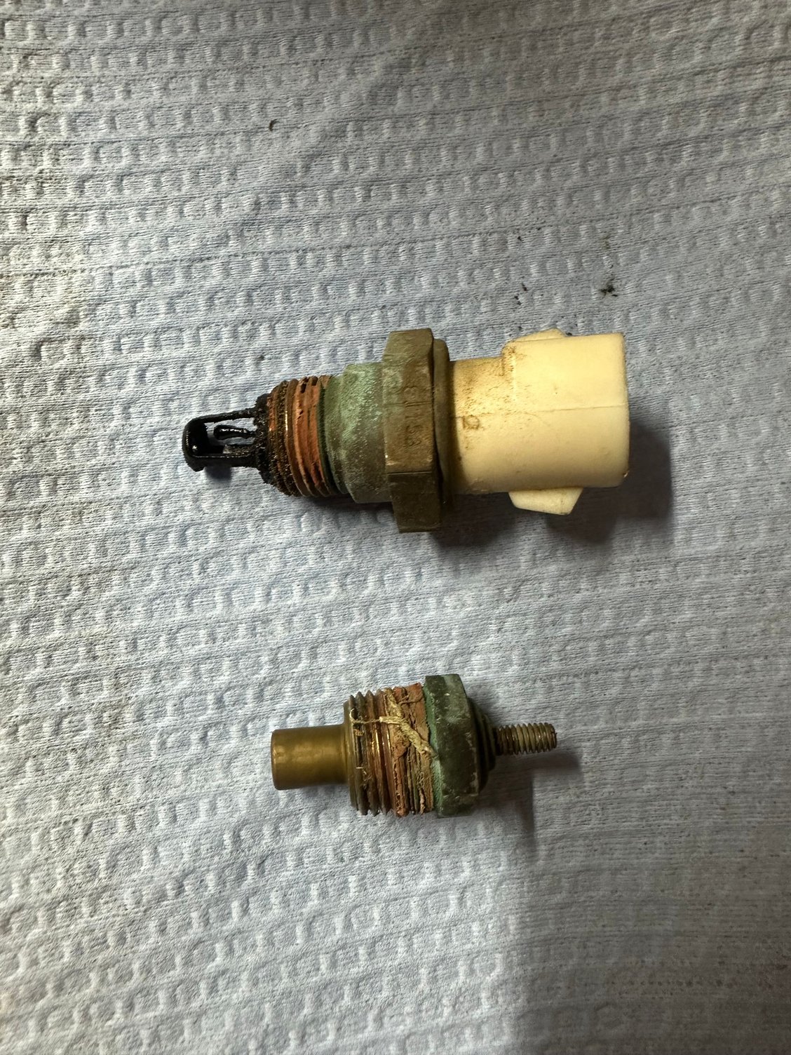

Update!!
I changed the coolant temp sensor by the thermostat. I tried to change the other but all the sensors require a new harness. At least that I could find so I can’t install it yet. They were pretty bad. The sensor beneath the air intake was gunked up and looking down into where it sets, it looks likeI desperately need to flush my system however it also looks like I hardly get any coolant flowing through there it seemed semi dry.
I tested the fan clutch and I found I have to replace that as well. I will be doing the fan clutch and coolant flush next weekend with my next paycheck.
here’s what the sensors looked like after removing. I cleaned the top one of the best I could and reinstalled it just till I get the wire harness.
