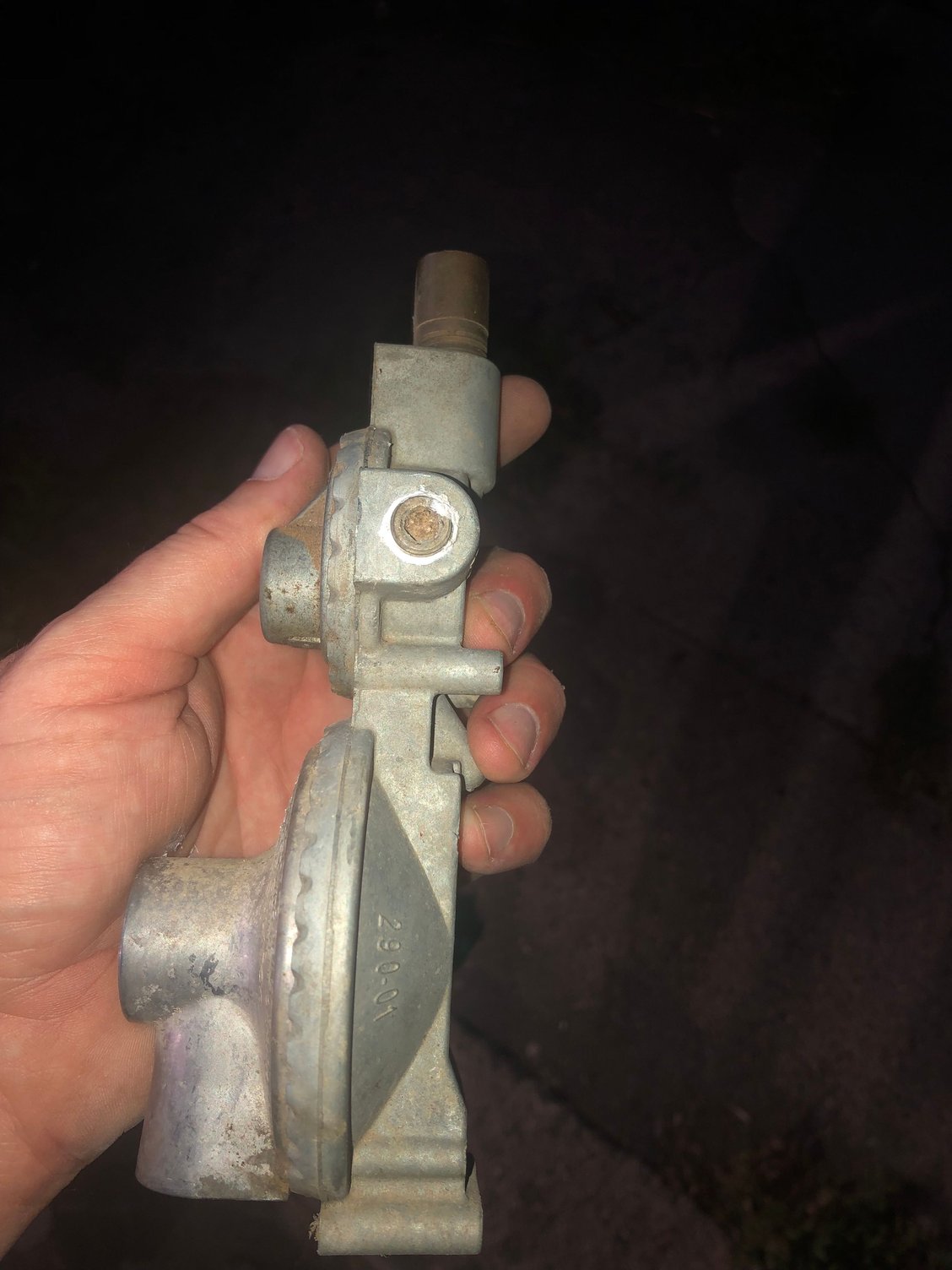

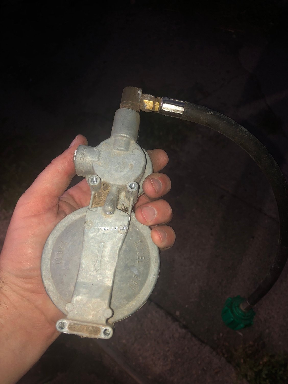

I bought a manometer to chase down what I think is an over fired furnace.
I hooked up my manometer to the test port on the regulator, at the top where it says “gauge”
when I cracked the valve for the propane tank, my gauge instantly maxed out.
is this test port supposed to show the pressure after the low pressure regulator? Or does it just show the pressure after the high pressure regulator?
I don’t see anywhere else to hook up a manometer. Do I have to build a test port after the output line on the regulator?

As far as I know, the first regulator is high pressure. So that test port would be used to ensure you're getting something like 100 to 200. Any test for a "normal" WC would be done on the final output port at the bottom. At least, that's where I would do it. When I tested mine, I did it at the stovetop.
The one time I questioned what my propane regulator was doing, I replaced it altogether. It was probably 14 years old at the time.

I think that is where I’m at. This one is about that old, I think the camper is a 2007 or 2008.
going to the local propane dealer later today to see what I can find. The camper dealer just had one for a dual tank set up, so hopefully I can find more of a direct replacement.

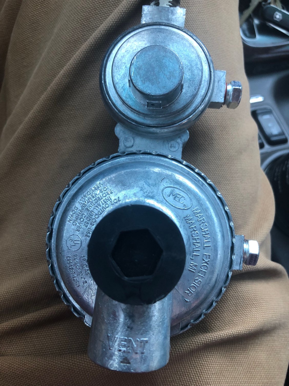

got a dual stage single tank regulator at the propane store for $48. And it has the test port for the low pressure side as well. That almost feels like winning.
now just have to get it installed and check the pressure level. I’m guessing it is going to be about perfect out of the box, but at least now I can check it and verify.

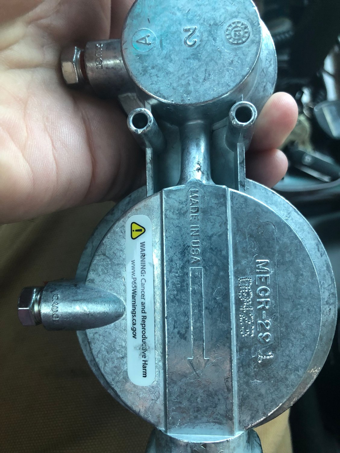

Got the new regulator in. It is a Marshall excelsior also and it labeled as made in USA.
pressure was set to 14” right out of the gate. I dialed it down and ended up with about 11.3 with the fridge running. I can adjust from here to see what happens. Had to back the screw all the way out almost to get it down around 11.

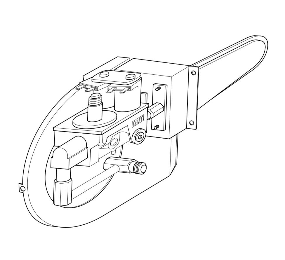

It has a white-rodgers gas valve. I am familiar with them in residential furnaces. They have an upstream and a downstream port to test from and an adjustment for burner manifold pressure. I don’t see any reference to adjust the gas valve in the manual though, so I am be wrong. It does say you want 11” wc with all appliances running. I would test at the gas valve inlet port if it has one , because there will be some pressure drop in the lines.
post edit: I do see that outlet test port on the drawing. There may be a sticker on a furnace cover that will tell you the manifold pressure. That is what you are after, if it is adjustable.
