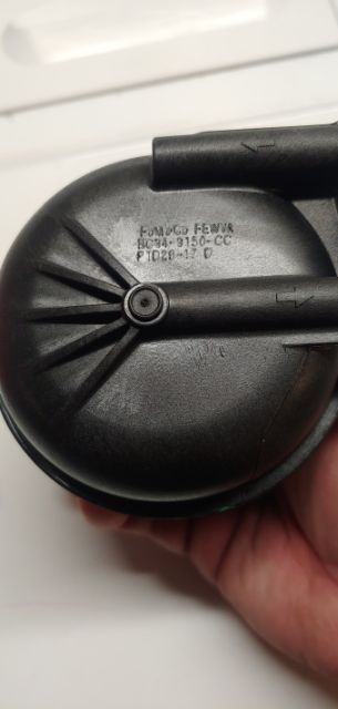

Hey guys I ordered some Ford fuel filters from diesel filters online.com and the one that showed up that goes under the hood does not look like the one that's on the truck now. For one thing there's no provision for that little 10 mm bolt. Do you guys think these are genuine Ford filters or Chinese ripoffs?

Bolt was deleted. don't worry about it.

Upon closer inspection I think the bolt only holds the base that the filter snaps into. OK, I'm going to try and get this done this evening.

Looks legit... this is from one of the two sets I still have (ordered 4 sets I believe when I placed the big order) from dieselfiltersonline. I have the previous gen where the secondary filter has 2 fittings on it.

If the part number is stamped, legit, if printed with ink, not legit.
