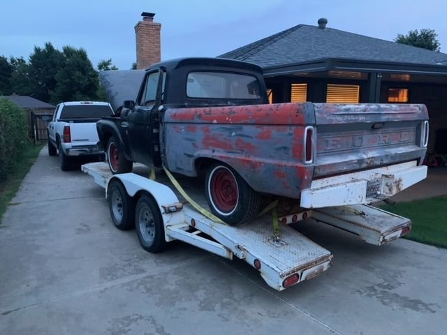

Bought an old farm truck with no title, I can get around that part but I thought it was a 1965 from the grill, Looking at the door plate, looks like a 63, Owner thought it was a 64.. Twin I beam front suspension, 6 cylinder, Not original motor.
What says the experts?

Not an expert by any means but if it's a twin I beam suspension it's a 65 or 66.

Per your door tag it's a 65 this will decode

Nice SB, Twin-I Beams started in 65, grill is 65, I'd say door got swapped with one from a 63, you can find the VIN on the frame, which is what you should go with..

Cool short bed with black paint and red interior. Definitely seems to be a 1965.
F10 - F100-4x2
J - 240 1V
K - Kansas City assembly plant
637277 - January 1965 assembly month - 1965 model year
115 - wheelbase in inches
A - Raven Black paint color
F100 - F100-4x2 5,000 Lbs. GVWR
581 - 5 = Red crush vinyl and red wicker pattern vinyl seat upholstery - 81 = 81A Standard Cab
A - Ford 3-speed (3.03) manual transmission
09 - Ford 9" 3.70:1 (3,300 lbs rating) non-limited slip
5000 - Gross Vehicle Weight rating
129 - Horsepower @
4000 - RPM
I can't quite read the last two digits accurately. Is that a 65? If so,
65 - Oklahoma City, OK district sales office
Two-digit DSO so not a special-order truck but still special in its own way.

Spot on sir. I thought it was a 65, but another website led me to think it might be parts and pieces due to some bad information they had listed.
65 makes sense with the twin i beam as well. Thanks.

Yes its 65. makes sense since it was owned by an Oklahoma farmer..
