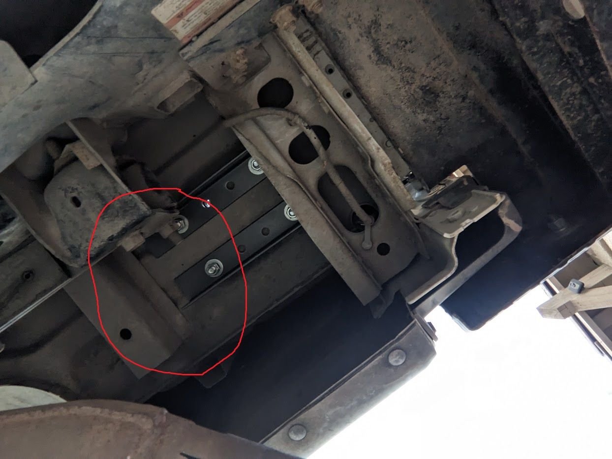

Hi All. I've installed a harbor freight truck bed crane (yes I am a HF addict, they have so much good stuff for trucks) in my 2018 F250 long bed. Here's a picture of the under bed brackets. The bed flexes when I use the crane. What's the best way to beef up the under bed mounting? Can I weld to that C channel part? It seems really thin. Not sure if it's steel or what. Looking for any suggestions. Thank you in advance!

The bed is aluminum so is that C channel.
It appears the aluminum is just sandwiched between the crane and it's under brackets?
It's only a matter of time for that aluminum rips.

I don't remember if the changeover to aluminum was 2017 or 2019. Quickest way to check would be to try to stick a magnet to the bed of the truck.
That said, everything you've got circled and where your crane appears to mount to is all sheet metal. I wouldn't lift much with it even with reinforcements, even if it IS a steel bed. You could try putting a 1/2" thick plate in there and using longer bolts but I'm not sure that's going to help you out much.
Something like a crane should be attached directly to the frame - it's the strongest part of the truck.

2017 was the first Alumiduty.

I wouldn't mount it to the bed at all; only the frame or something bolted to the frame (like the reciever)

Back to the OPs situation - you definitely need to make a large steel plate, get it bolted to the frame and then mount the crane to that. The aluminum bed is going to tear unexpectedly, costing a fortune to replace and possibly injuring someone when the bed mount fails with a heavy load on it. If your truck has the 5th wheel / gooseneck plate already installed that may open up some creative possibilities. It is certainly sturdy and it s mounted to both frame rails.

For that bed crane, you need to find a way to attach it to the frame or it will get pulled right out of the bed.

Back to the OPs issue, you need to have an L bracket made that will bolt directly to the frame to where you have the crane mounted. Go by a local welding shop and they can help you out. If you continue to use it the way it is it will rip the aluminum bed apart.

I agree with not bolting anything load bearing to the aluminum bed for a crane application and needs to be mounted directly to the frame. This comments then leads to I'm not sure what this truck bed crane is used for, but have concerns of safety here as well.
