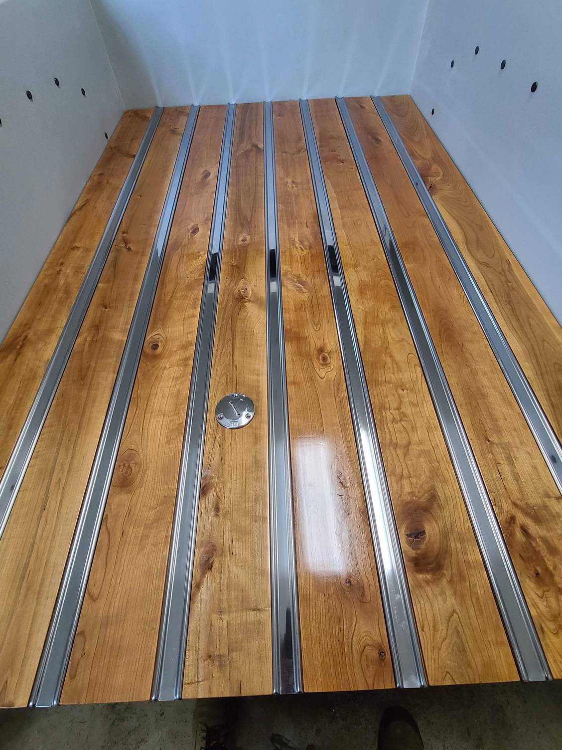

The choices in wood are almost unlimited. I guess it depends on the look you want.
This is cherry

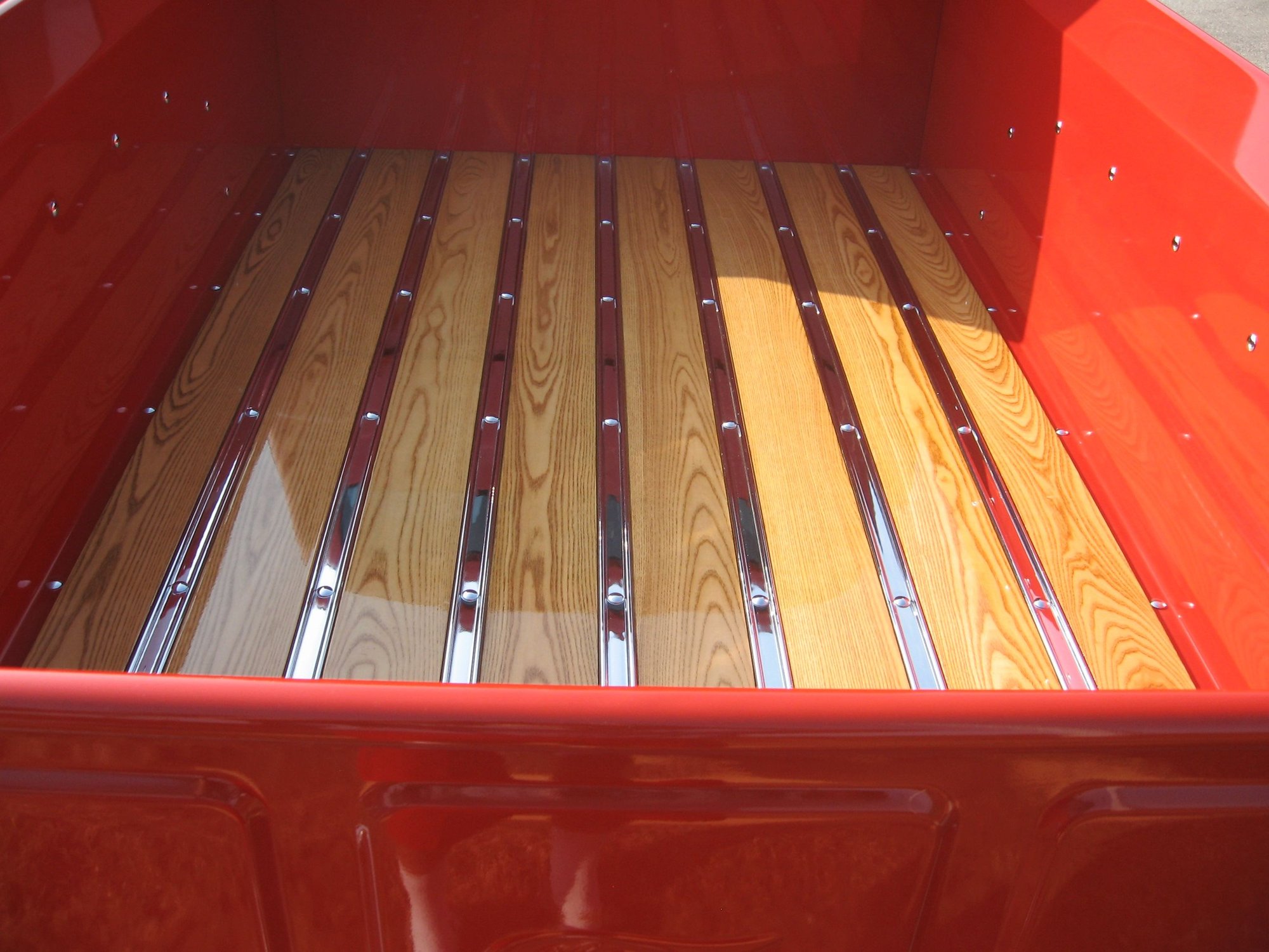

Ash bed wood in "Art" the hot rod truck .
This is cherry
Absolutely beautiful .What type of finish ?
