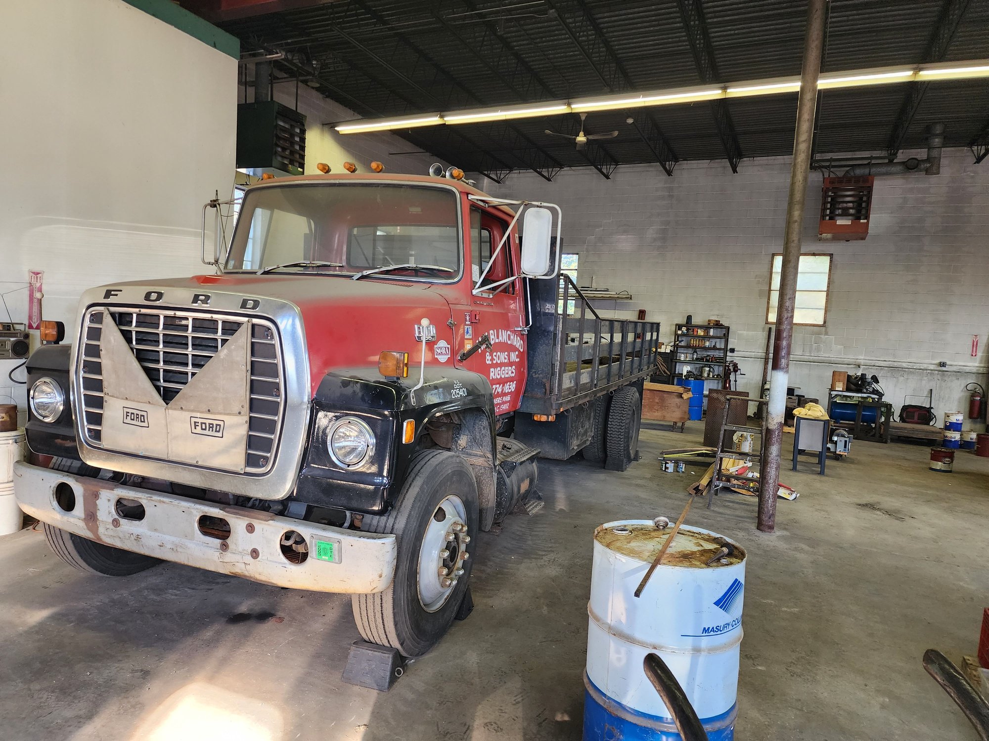

Just bought a 1975 L900 Time Capsule with a 477. Having the same problem with getting the right Pertronix kit. Also talked to them a few times. Kit number three is on the way; first one was for DuraSpark, second was dual points, third one is a 6 cyl points kit? based on the shaft profile of being round with a slot versus looking like an upper-case D from top-down view. We shall see how it goes?....
Separate subject, but I'm going EFI on this monster.

So the rep from Pertronix messed up the first time, I messed up the second, and took their advice for the third. Kit will be here on Friday. I also was not able to see the casting marks on the distributor, not a lot of room in that area. Didn't have a bore-scope to go snooping in depth.
EFI is already here, waiting on some -6AN line/fittings pumps, regulator etc. Went with the Aces KillShot.
I'll make a new thread for the installation as to not hijack this thread.
