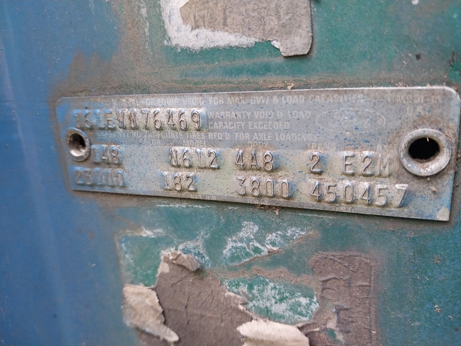

Hey there! This is my first post, but I’ve been lurking around. I r ecently purchased (well
, “traded for” if I’m being honest) a 1972 Ford flatbed with a 361 gasser. This is really all the information I could gather from doing a quick look over. I do have a picture of the data plate.Hoping the infamous number_dummy comes across this, thank you very much in advance for any information you could share with me.

Welcome to FTE! I am giving you your own thread for this truck for clarity and future reference.
N61 = LN600 gas
E = 361 2V FT gas V8
V = Kentucky Truck Plant
N76469 = 1972 numerical series, February 1972 production
148 = 148 inch wheelbase
No color code, the truck was a special order, so color could have been part of it.
N612 = LN600 gas, 23,000 lbs GVWR
4A8
4A = Black vinyl
8 = Standard cab without butterfly hood
2 = Clark model 282V five speed direct transmission
E2M
E2 = Eaton model 16244 Two Speed Rear Axle / 6.17/8.58 / 17,500 lbs. Rear Axle Capacity
M = Ford 7,000 lb. Capacity Front Axle with power steering
23000 = 23,000 lbs GVWR
182 3800 = 182 certified net HP @ 3800 RPM
450457
45 = Lansing District Sales Office
0457 = Special Order Number
What kind of wheels? Feel free to post a picture.
Widowmaker wheels and the lack of new brake drums are two of the biggest cost hurdles with these.

Thank you so much for the information!!
Sorry for the quality of photo, the truck is currently sitting behind my friends house in his “junkyard”. Sort of a used car lot but technically more of a “used-up” car lot.
I don’t know what wheels it has, just that they’re not the standard 10-bolt type of today. They seem to be a two piece, with bolts on the outside of the 5 spokes. This is for both axles. I also don’t know anything about the brakes, the PO says that he’s certain they’re not air brakes (he’s not a commercial truck guy in the slightest, when he bought it he was told it was an F-700).
The information you provided from the data plate has been immeasurably helpful and will help me get the title fixed. Currently it’s saying it’s got a gvwr of 28,000 (while I have a cdl, I was hoping it didn’t need one) so it’s clearly incorrect. It has a 14’ flatbed (technically a tilt bed but idk the proper terminology, tilt bed is what my old company called our trucks that did what this one does), and a pintle hitch.
I drive a significantly newer truck in the same-ish weight category, but have driven older ones like this before. However, they had air brakes. From the little bit I’ve read there’s a system called “Hydro-vac” but once again I don’t know if that’s what is on the truck. Hydro-vac sounds like a convoluted mess. Are there parts available to just replace what’s on the truck? Its primary intended usage is to haul corrugated steel siding for local Amish builders and move mini-barns around the local area. No super heavy towing or even getting close to the gvwr.
